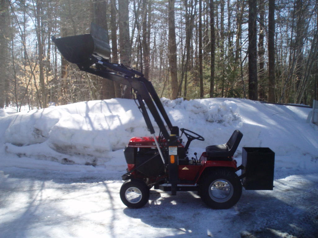

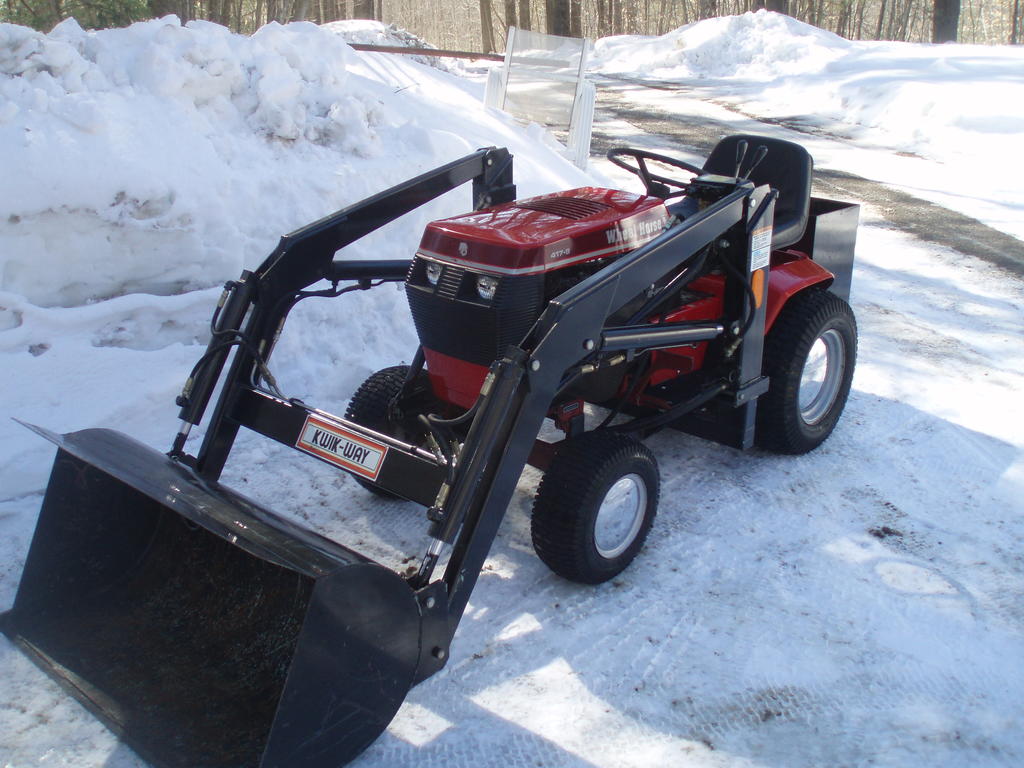

top_cat 41 #1 Posted April 26, 2020 I've had my kwik-way loader on my 520h for around 15 years, one of the best attachment you can have for your tractor in my opinion. About 5 years ago my pump seized up. I found one with the mounting bracket and pulley from a 522 (newer style tractor). Here's the problem. The original pump which the numbers are no longer readable use to be able to lift the front end of the ground. The newer pump (C304 - F2) works ok but lacks the power to lift the front end and when in use hisses and makes noises. I've replaced and blead the hydraulic fluid and that didn't change anything. The pulley that came with the new pump is much larger than the old one I put back on and I'm assuming that the new pump has a lower GPH rating than the old one. I did call Kwik-Way and they didn't seem to know what the correct GPM pump to use.Does anyone know the correct pump to use for the loader, the correct part number or GPM. Has anyone got the correct replacement form Northern Tool? Thank in advance for any help and stay safe. PS: I still have the front pump mount bracket and pulley for a 522 if anyone could use it, just pay for shipping or pick it up in Thompson, Ct. 1 Share this post Link to post Share on other sites
