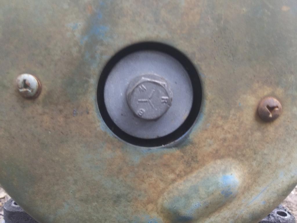

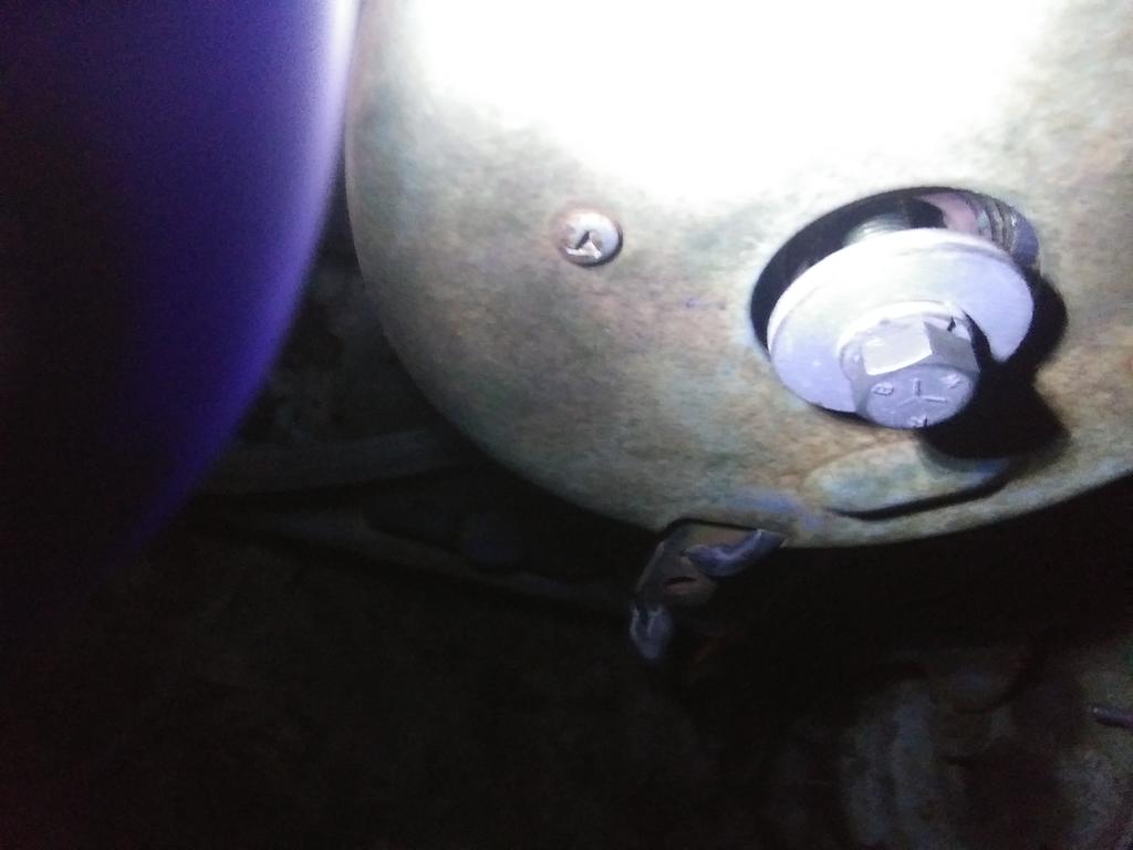

posifour11 723 #1 Posted April 25, 2020 (edited) Ok, so I bought this tractor for the engine to put in my electro 12 as a stopgap while I rebuild the original engine. I have everything ready to move over, but I don't know how to remove the electric PTO from the Ford engine without damaging it. I'll add pictures at the end for more clarity. I'm just going to part out this tractor when I'm done, but there's no reason to ruin a part that someone else could use. I think I'm going to have to buy special screw bits (cheap at harbor freight and I have one close) , cut slots in these screws or just grind them off in order to get to the "more important" parts to remove it. I'd surely appreciate the help. Edited April 25, 2020 by posifour11 Share this post Link to post Share on other sites
posifour11 723 #2 Posted April 25, 2020 (edited) To add stupid to ignorant, I bought (or traded for) this tractor ( the electro) without an electric PTO and I've used it for ground engaging implements since then. But, I just started thinking that I could leave this engine as it is (it came with the electric clutch, but no brace to attach to) that if I can make this one work, why not keep it for random future uses? I know, my brain doesn't run linear, but I don't think it will hurt to keep it on there in case it is useful later. I guess I have to get my wife to do algebra for me. I know the pulley on the current engine is way too big because this tractor is way too fast as it is. I hope all of that random stuff made sense. Edited to clarify. Edited April 25, 2020 by posifour11 Clarification Share this post Link to post Share on other sites
squonk 41,933 #3 Posted April 25, 2020 1 hour ago, posifour11 said: Ok, so I bought this tractor for the engine to put in my electro 12 as a stopgap while I rebuild the original engine. I have everything ready to move over, but I don't know how to remove the electric PTO from the Ford engine without damaging it. I'll add pictures at the end for more clarity. I'm just going to part out this tractor when I'm done, but there's no reason to ruin a part that someone else could use. I think I'm going to have to buy special screw bits (cheap at harbor freight and I have one close) , cut slots in these screws or just grind them off in order to get to the "more important" parts to remove it. I'd surely appreciate the help. I think they don't want you to take out those screws for a reason! 1 Share this post Link to post Share on other sites

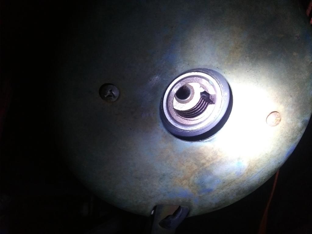

posifour11 723 #4 Posted April 25, 2020 (edited) 58 minutes ago, squonk said: I think they don't want you to take out those screws for a reason! You're probably right. It looks like an AC clutch from the back. The bolt in the center came out easily enough. And there's a slanted ring on the inside, not a normal snap ring. Edited April 25, 2020 by posifour11 Add picture. Share this post Link to post Share on other sites
Tractorhead 9,065 #5 Posted April 25, 2020 This screws are available as bits, but i agree to squonk, such „special Screws“ normally used as a Warn Sign to rethink what you do. 1 Share this post Link to post Share on other sites
posifour11 723 #6 Posted April 25, 2020 1 minute ago, Tractorhead said: This screws are available as bits, but i agree to squonk, such „special Screws“ normally used as a Warn Sign to rethink what you do. I'm good with that. I wouldn't mind it staying where it is. I have to take measurements to make sure the horse doesn't go any faster than the last owner had it going. It needs to be slowed down as it is. Share this post Link to post Share on other sites

squonk 41,933 #9 Posted April 25, 2020 A special pulled threads into that hole. Then a push bolt threaded on the puller would push on the crank to remove the clutch 2 Share this post Link to post Share on other sites
posifour11 723 #10 Posted April 25, 2020 8 minutes ago, squonk said: A special pulled threads into that hole. Then a push bolt threaded on the puller would push on the crank to remove the clutch I wondered about the threads inside and thought the same thing. It's all really pristine. Maybe I should just think about transferring it over to the electro and maybe using it later? As long as I can get the electro back to stock speed with an engine that doesn't sound like it's a rev away from kabooming, I'm good with that! I've only been able to use it for a turning plow(very wrong revs because of the wrong pulley) and pulling a wagon (still way too fast!) Share this post Link to post Share on other sites
pfrederi 18,178 #11 Posted April 25, 2020 Threads to push it off would be 5/8 NC 7/8 NC or 1" NC WH nor Ford made the PTOs most were Werner Just tread in the appropriate size and it will come off. 1 Share this post Link to post Share on other sites
posifour11 723 #12 Posted April 25, 2020 1 minute ago, pfrederi said: Threads to push it off would be 5/8 NC 7/8 NC or 1" NC WH nor Ford made the PTOs most were Werner Just tread in the appropriate size and it will come off. Tell me what to do with them. You know I don't know how to do anything with these things. Or should I find a Ford guy to do this? You know I want to keep this for a Ford guy that wants it for his. 1 Share this post Link to post Share on other sites
squonk 41,933 #13 Posted April 25, 2020 2 minutes ago, posifour11 said: Tell me what to do with them. You know I don't know how to do anything with these things. Or should I find a Ford guy to do this? You know I want to keep this for a Ford guy that wants it for his. No! A Ford guy would just use a hammer!!! 1 Share this post Link to post Share on other sites
gwest_ca-(File Mod) 11,176 #14 Posted April 25, 2020 7 minutes ago, posifour11 said: Tell me what to do with them. You know I don't know how to do anything with these things. Or should I find a Ford guy to do this? You know I want to keep this for a Ford guy that wants it for his. Thread the big bolt in. When it hits the end of the crankshaft keep turning. It will push the crank out of the pto. Garry 1 2 Share this post Link to post Share on other sites

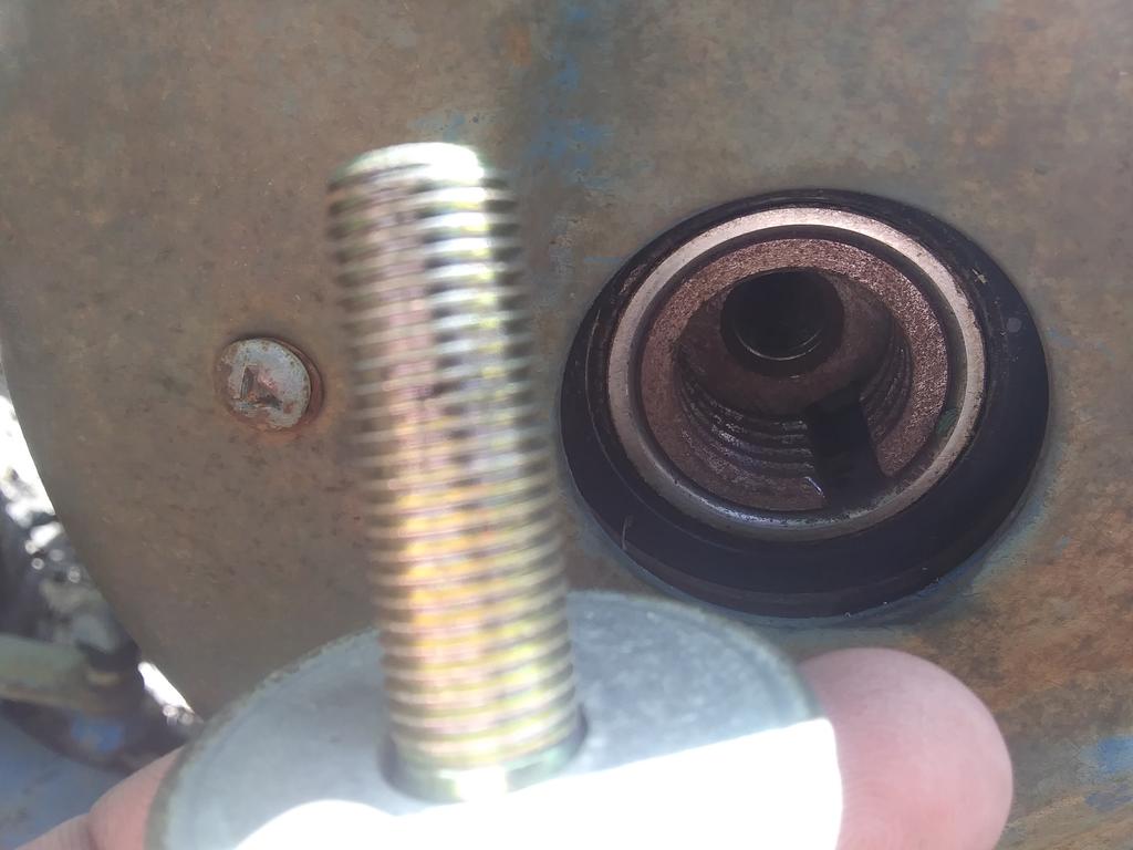

posifour11 723 #21 Posted April 26, 2020 (edited) 25 minutes ago, gwest_ca said: That is the only reason the threads are there. Garry Garry. I hope this picture makes it more clear. There are larger threads outside of the threads of the regular bolt. I think I see that you are wanting me to add a spacer or something to use the current bolt to pull the assembly off of the shaft? Edited April 26, 2020 by posifour11 Adding pictures Share this post Link to post Share on other sites

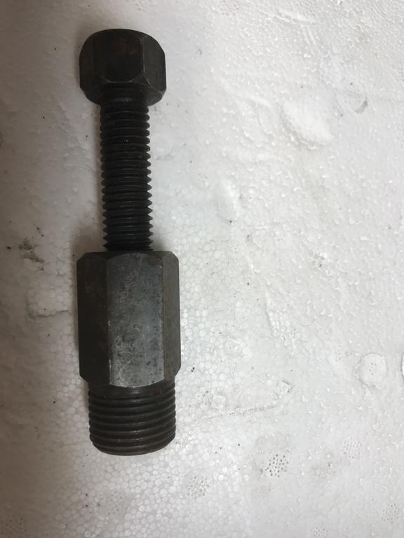

squonk 41,933 #22 Posted April 26, 2020 (edited) Posi , That clutch was designed to be removed with a special puller like I said BUT the method Garry and Paul mentioned will work. Here is the type of puller used. You thread the larger threads into your clutch and using a wrench on the outer hex, hold the clutch from turning. Use another wrench to turn the inner push bolt to remove the clutch Edited April 26, 2020 by squonk 1 Share this post Link to post Share on other sites
posifour11 723 #23 Posted April 26, 2020 Ah. I get it now. Makes sense. Thanks everyone! Share this post Link to post Share on other sites
posifour11 723 #24 Posted April 28, 2020 Problem solved. My neighbor is a retired mechanic, so I took it over to him. He had it off in under a minute. He put the right screw bit in the screws, smacked the end of the driver with a hammer and unscrewed them. Zipped out the snap ring and gave a good yank. Came right off. So, this particular problem is solved. Thanks everyone! Share this post Link to post Share on other sites
