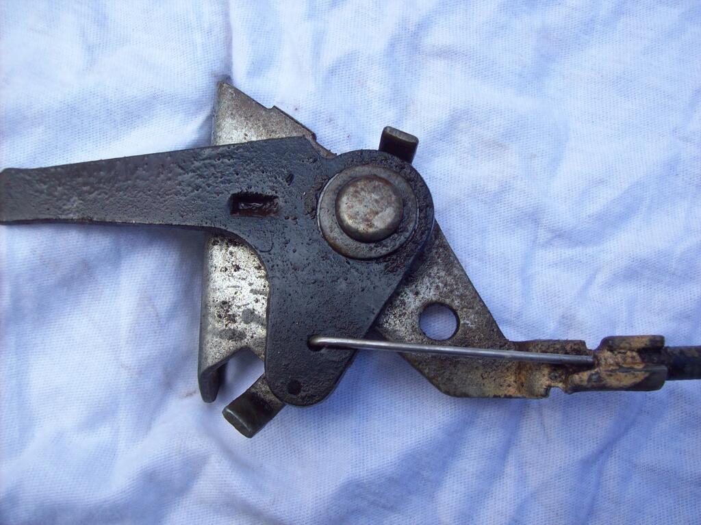

I bought this set from Tractor supply the other day for ten or twelve bucks, cable was twice as long as I needed. You can open up the area that the shield screws into a little and screw the old one out then tighten it up after the new one is in place.
1027191?$456$
This is from a 418-C but should be the same as yours.100_0145.JPG.b9b3dd9074b251ff1c39505e00d6a709.JPG
