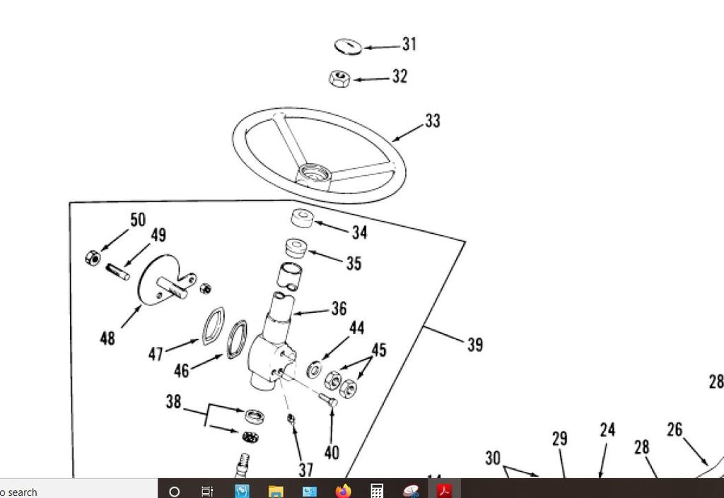

pfrederi
pacer
Yep, Paul has it - that #31 is just a little piece of tin with the logo on, Use a small tip flat screwdriver and gently ease it around the edge lifting as you go. you should feel the edge and prize up on the rubber/cover - its pliable, and work around lifting and itll come out pretty easily. An impact wrench on the nut will ease getting it loose, but do screw it back on to where the nut is right at the top of the threads - dont wanna booger them! That thing is gonna be STUCK -itll take some force to get it broke loose, hence the clam shell.......

3WHDave
OMG!  Found it before looking back at post!  The cap was soooo weathered that there was no indication it was removable.  I went out armed with determination and a beer (double IPA)  popped the cap off to reveal mucho-rust!  It is soaking in anti-rust.  Thank you Paul and Pacer, good guys with good info, all I need in life.  On a side note, all sheet metal went out today for media blasting, going to shoot a color-close epoxy next week.  I am totally excited to see how this things performs in the woods of Northern Michigan, pulling logs out for slicing and dicing!  Stay safe out there, this CoVID thing is real, and we will beat it, its my business when not rebuilding things that have value.

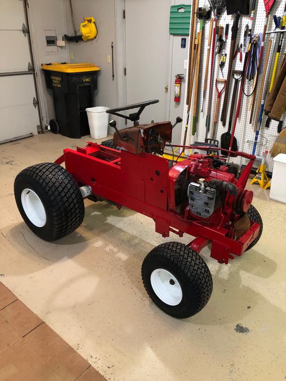

3WHDave
Update on project:  I bought this thing 7 days ago, here is where it stands:
  • Like 6
3WHDave
I choose not to pull and paint the dash as I have many electrical thing to address before doing so.  All else has been rebuilt and painted.

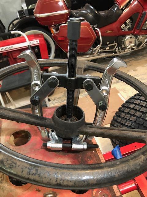

3WHDave
Well folks, the steering wheel is off, but at a cost.  Cutting to the chase, I will be able to assemble it, but not with the original nut.  This Horse sat outside, unprotected, in Michigan for a decade or longer (copping a plea).  While tightening the wheel puller in combination with the bearing splitter, the top of the steering shaft split, nut and all.  I then resorted to use a sheet metal drill-bit (that funky looking tapered bit with now, two uses) and cleaned the mushroomed threaded steering rod down to the spline.  Next, as luck would have it (yup, there was still a place for luck) the I.D. of the steering rod accepted a ½-13 tap.  I tapped it for the for length of the tap and then proceeded to place a bolt into the threaded shaft.  I pre-drilled the head of the bolt so as to have a center point to receive the wheel puller screw.  After screwing in the ½-13 bolt, I heated the end of the bolt red-hot, letting the heat transfer into the assembly.  I quenched the bolt thinking that would cool the shaft faster than the wheel spline (perhaps I was over thinking it). Then I took an impact wrench to the splitter and the wheel puller.  One rap on the wheel puller bolt and the steering wheel was free.  I plan on using the threaded I.D. of the shaft with a bolt as a retaining method upon assembly.  Oh brother, I call it a victory.  Q: Is the hollow steering shaft blind at the far end?  In other words, should I worry about the chips from tapping the I.D.?
