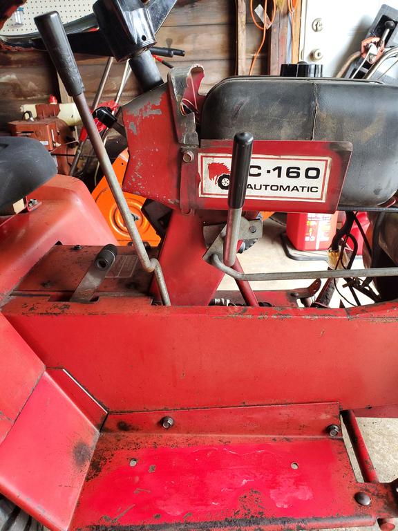

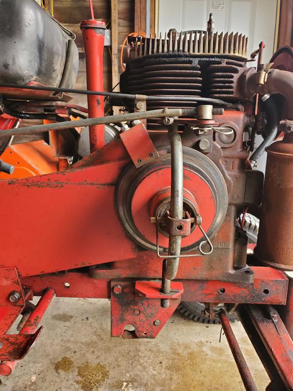

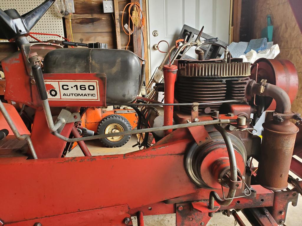

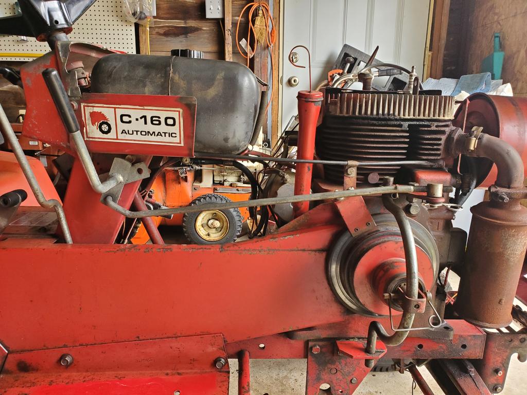

12Horse Paladin 1,038 #9 Posted April 22, 2020 (edited) Going to try n get some pics 2day to add, as im having to adjust mine as well... Got a manual (thanks again, @Achto!), andbthe instruction was easy enough to follow, but it feels like maybe i did it backwards, as the handle worked better b4; least seems thatway to me, lol... EDIT TO ADD: Here are pics as to how ove set mine sofar. Ive got the gap between as noted in the manual (1/16"), but now my handle seems to move sometimes while starting (or did; havent started since yesterday when i tried addressing things, to kno for sure yet). And now the handle seems to not operate as positively between positions as it did. According to the manual, i set the trunion right, but now have doubts...? Edited April 22, 2020 by 12Horse Paladin Info added 1 Share this post Link to post Share on other sites
