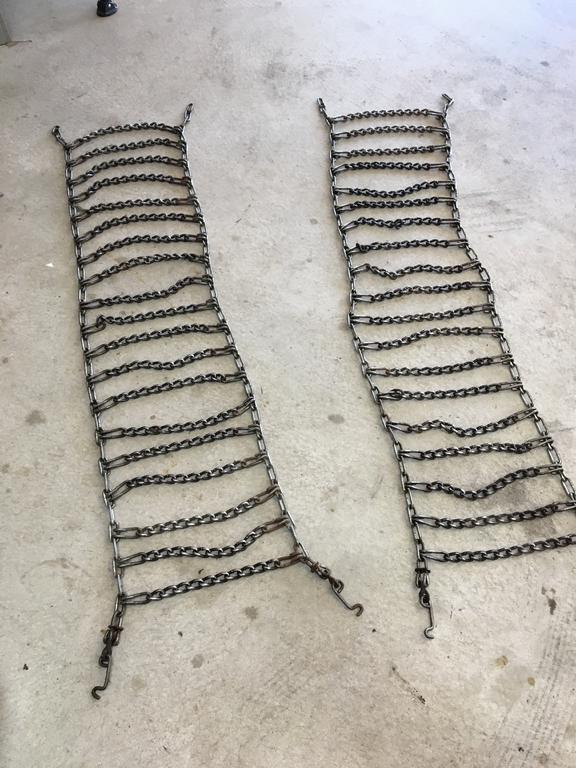

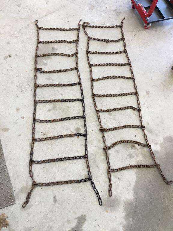

Sparky-(Admin) 22,058 #1 Posted April 19, 2020 Is there a chart or some way (other than mounting them) to figure out what size tire that tire chains fit? It’s garage cleaning day and I came across a couple sets I didn't know I had. Share this post Link to post Share on other sites
stevasaurus 23,063 #2 Posted April 19, 2020 Here you go Mike. First, measure the width of your tire...say it is 8". Now measure the width of the chain...if it is 14", you should have about 3" of chain hanging on each side of the tire. 14-8 = 6 6/2 = 3. Now measure from the center of your axle to the outside edge of your tire...say it is 12"...now remember you have 3" overhang on each side 2*(R - 3)*Pi = Circumference so...2 * (12 - 3 ) * 3.14 = 56.52". 2 * 9 * 3.14 = 56.52 Now measure the length of your chains. If they are 56.52" or a few inches longer, your chain will fit that tire. Pretty easy, without even moving that chain on the floor. Plug in the numbers that the chain measures and you can figure out what tires it will fit. 1 2 2 Share this post Link to post Share on other sites

stevasaurus 23,063 #4 Posted April 19, 2020 The above should give a pretty good idea of the thinking behind the math. You may only have 2" hanging on each side, so adjust the formula accordingly. One neat trick to putting on chains, let most of the air out of the tire...put on the chain and then air the tire back up. Makes the chain nice and tight. 1 Share this post Link to post Share on other sites
