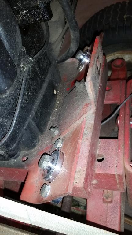

There are solid mounts available that replace the rubber mounts between the soaker tray and the frame.

Solid spacers in  lieu of the rubber spacers will work fine. No added effort just direct replacement... but you can’t bolt direct to frame. The spacers are on an angle raised up from the frame by two parallel mounts. Engine is cradled in between them...

Was going to say Mark one the fellas here would have a shaker plate. Some where I have the triangle pieces for underneath if you need them.  Here's the solid mounts. Lots of guys just make their own but this was plug & play for me.

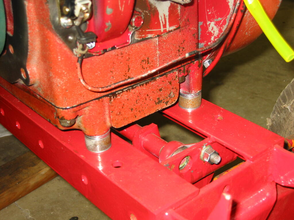

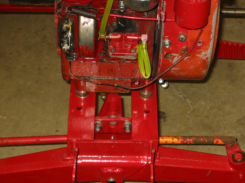

If you want to put a shaker mount engine (small base) directly on the frame without the shaker plate you will need spacers like this

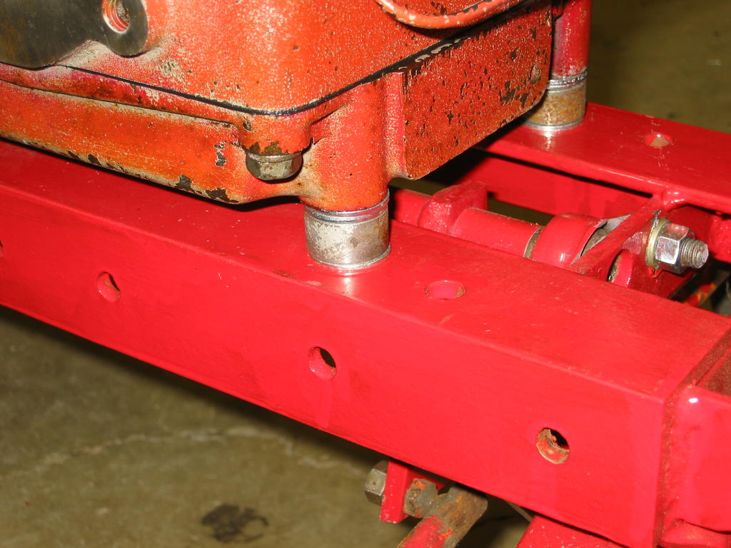

No a shaker plate (small base K341) will not hang over the side, the oil pan is smaller. You will need some spacers. like these

You need 3/4" lift.  I used the half inch thick spacers from a K181 shaker mount plus 3 SAE washers to get it.
