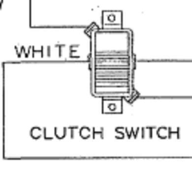

The tractor is 1969 model,1-7451. Looking for replacement switch. Is the switch a DPST?  Found  a COLE-HERSEE  # 58027-06bx.
I guess what i am asking would this switch work.

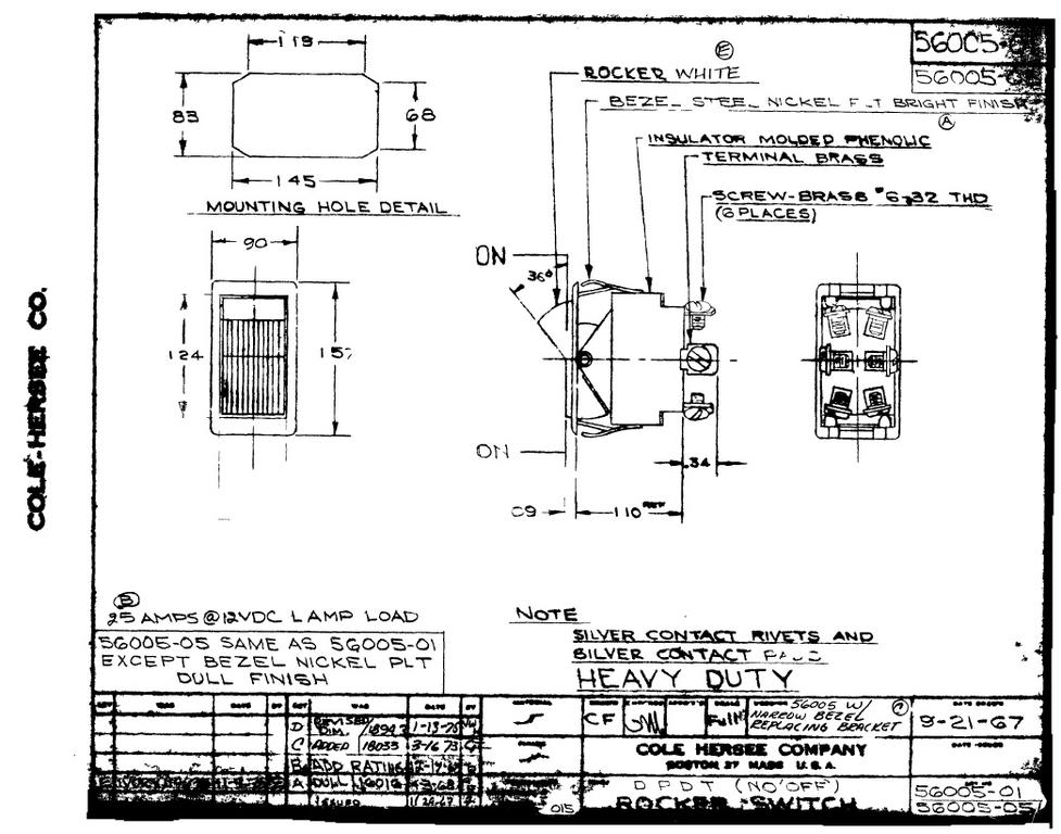

Double pole double throw I believe. Would have 6 terminals and either one half or the other is applied.
One side controls the starter and the other the pto. One terminal on each side is not used.

This manual should be helpful.         To add a picture just click on choose files... at the bottom of a new post and it will take you to your computer's photo files, select the one you wish to post and clock open. The photo will be added to the bottom of the page and then you can add it by clicking on the "+".        :wwp:
This one has written at the bottom "No off".
