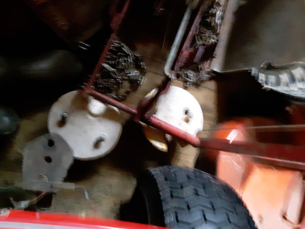

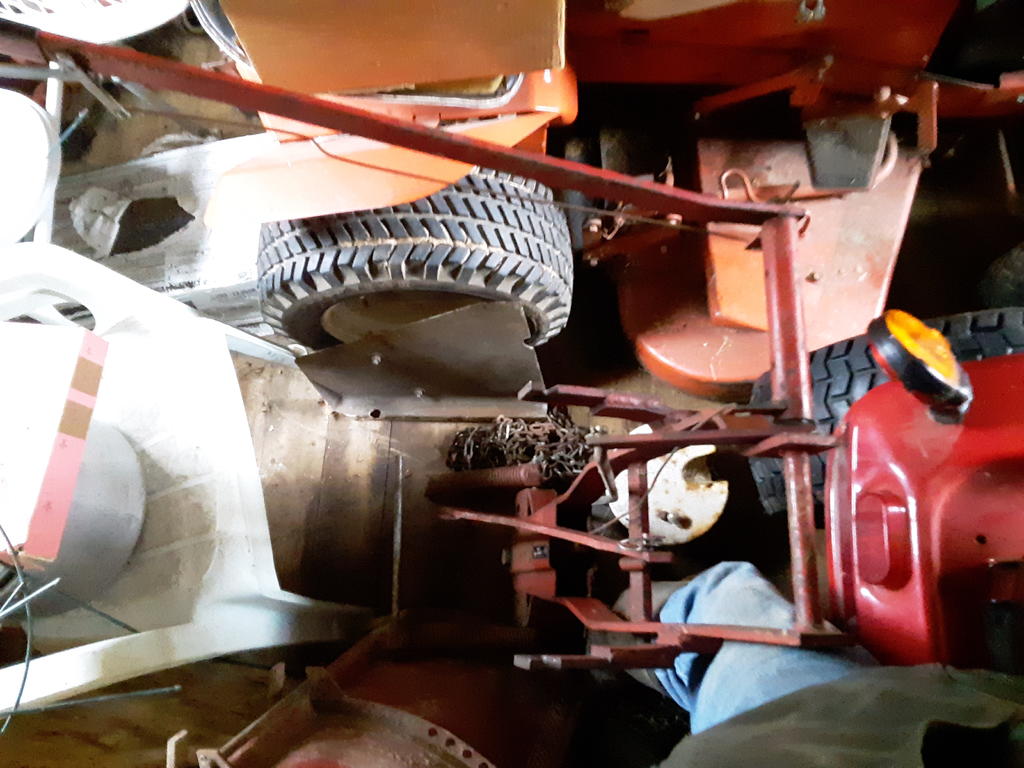

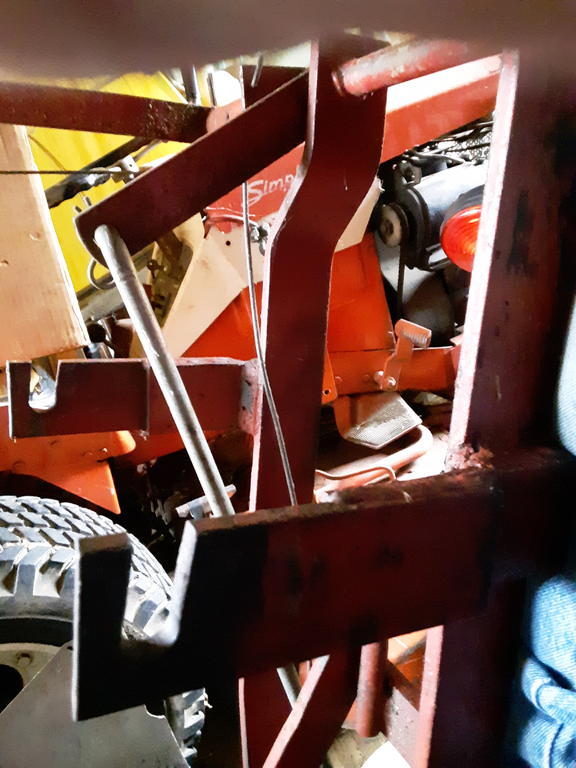

Here are some pics of the plow frame so it gives you an idea of the hookup.  The actual blade itself is the same as used on all of the other larger wheel horses and the pins go through the front of plow carriage the same way.  Hope this helps.
