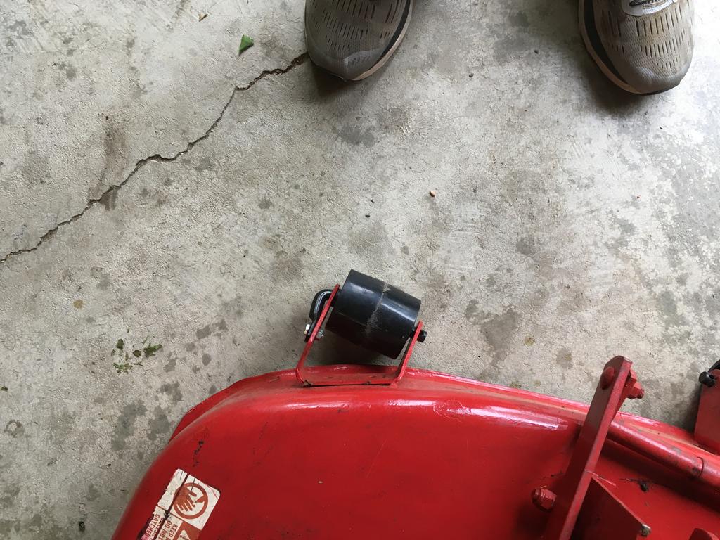

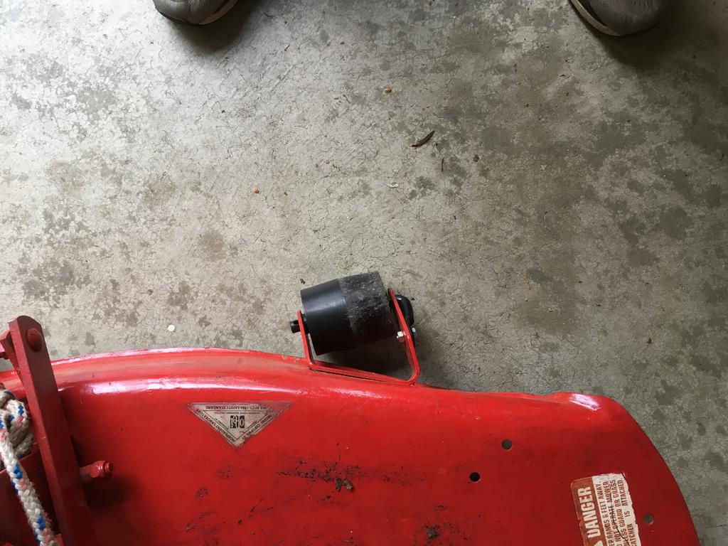

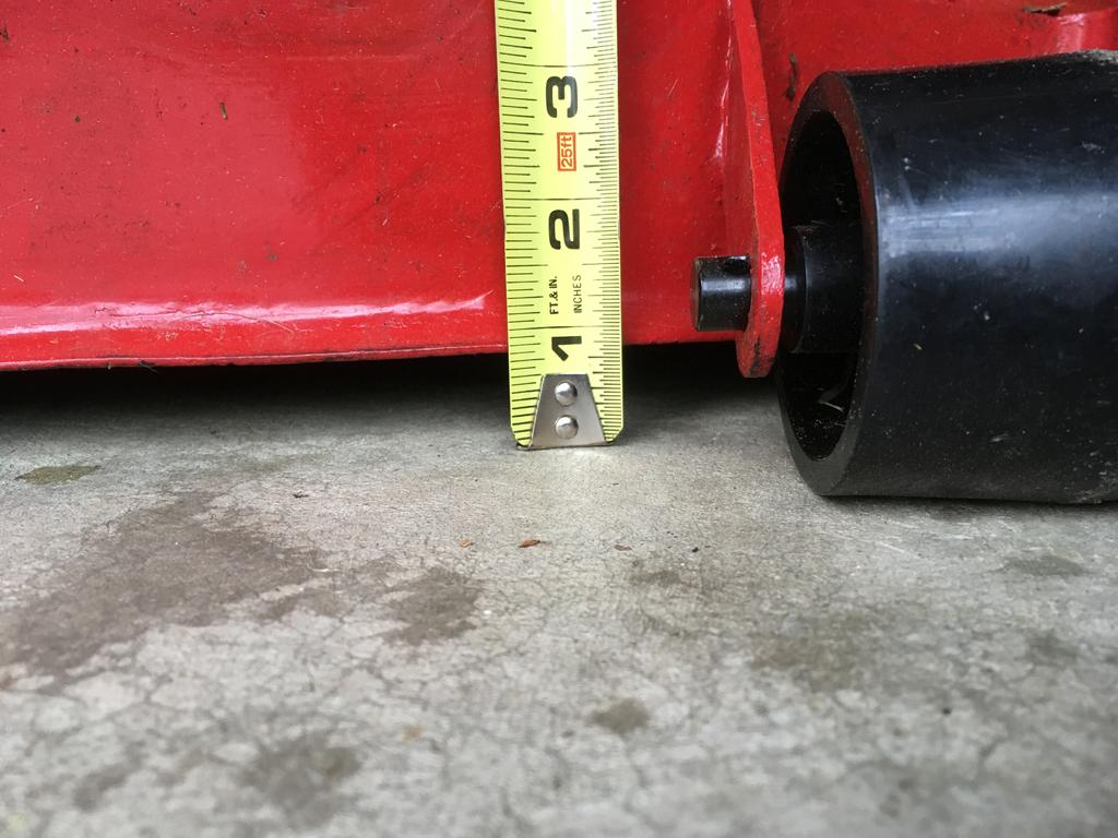

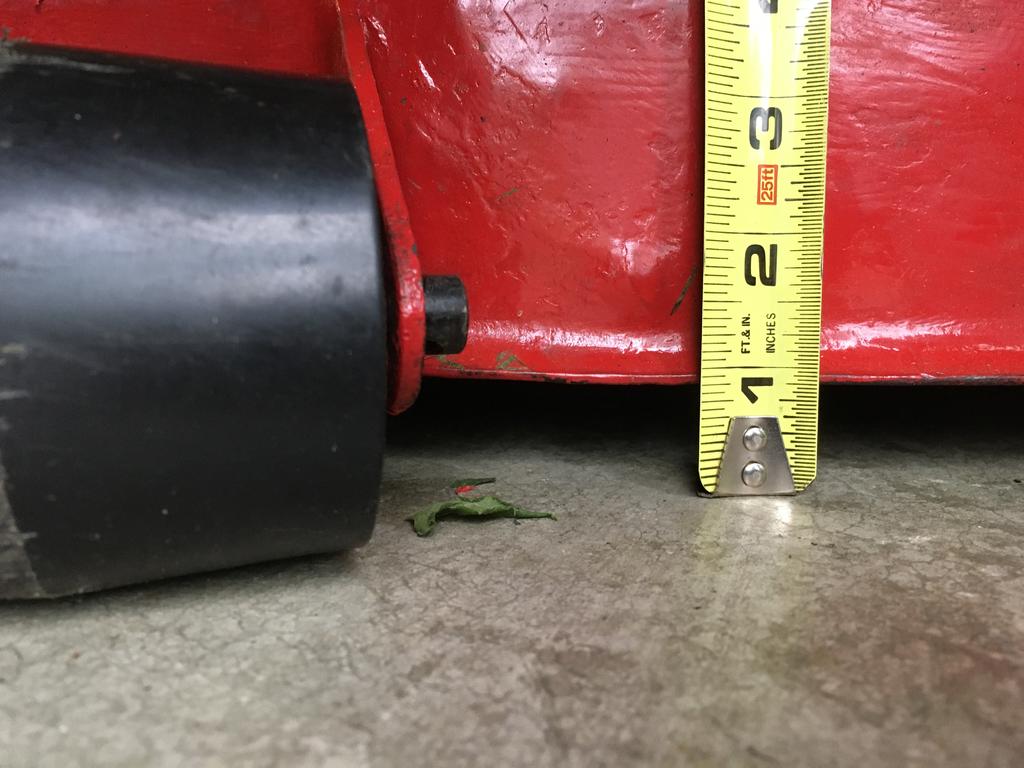

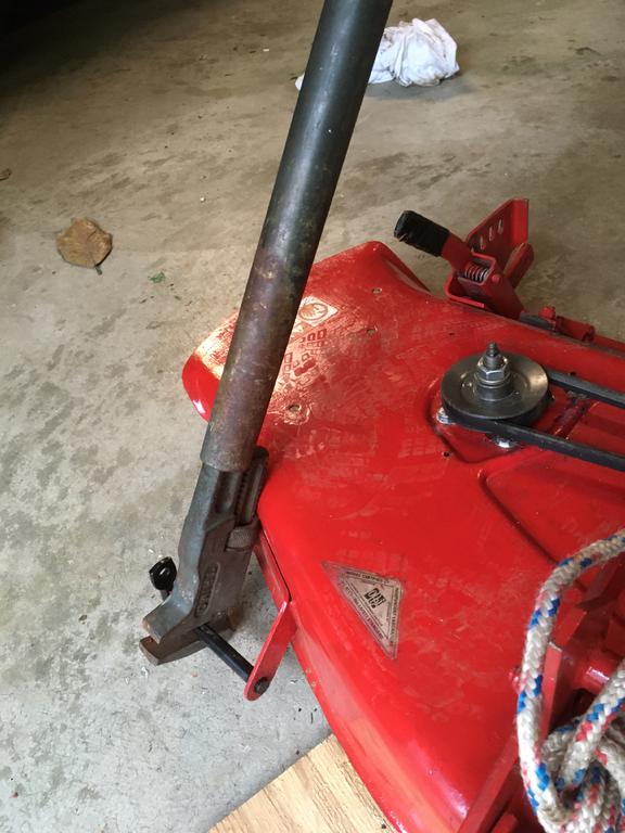

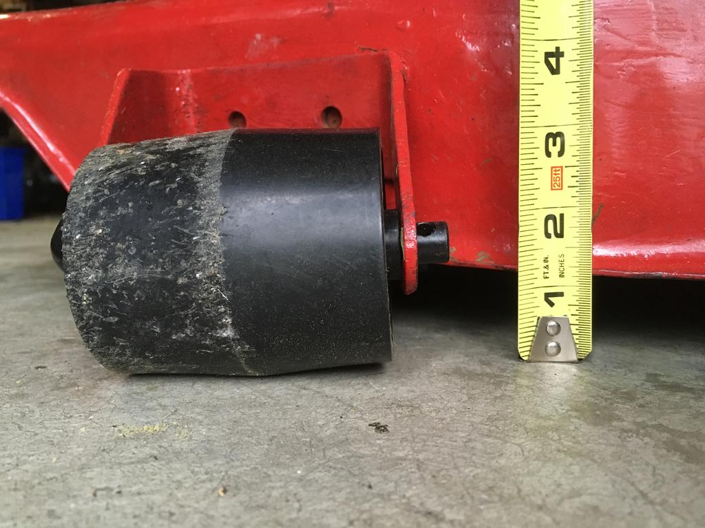

After rebuilding an old 42" SD deck I noticed one of the anti-scalp wheels was riding lower than the others.  One side of the deck had been hit so hard that the sheet metal was bent inward causing the roller to drop.  Fixed with the help of a monkey wrench and cheater bar.  Note:  Had to stand on the deck while levering.IMG_0740.JPG.8f88ae0dcb104a3342786b0dc8b483f4.JPGIMG_0737.JPG.f4f7e13b6ad653a986e87bcd6cf904b1.JPGBefore bendingIMG_0742.JPG.8e4340e99684a28d1a48538d790c27b1.JPGAfter bending
