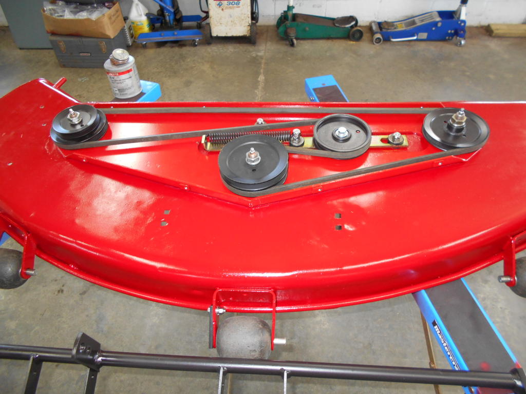

wheelwhores 107 #1 Posted April 7, 2020 This'll be my first year with my C175, my first WH. Can any of you send me a few pictures showing how the mower deck serpentine belt and mule drive go onto the tractor, i'm having a hard time finding a good diagram that shows me... Much appreciated! Share this post Link to post Share on other sites

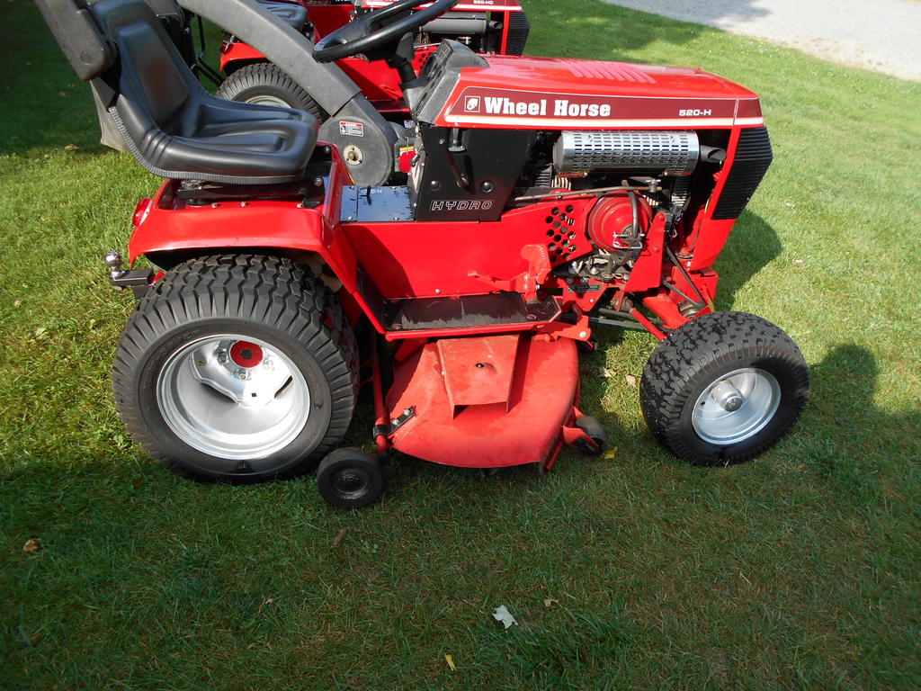

cleat 9,296 #2 Posted April 7, 2020 Here is a pic of the deck. Here is the owners manual that should help as well. 1992 48in Mower OM.pdf This shows a 520 but the deck should mount roughly the same. Belt goes on the inside larger pulley on the PTO. 2 Share this post Link to post Share on other sites
