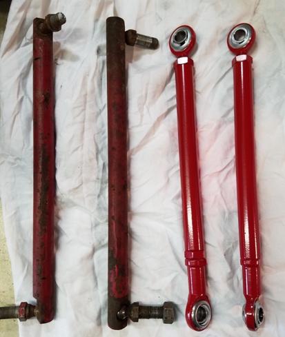

Made up some new Tie Rods recently

Look good to me..Adjustable…..and they're going to last a long time.
peter lena
midpack, nice job on those ! being a heim joint nut myself , i can relate on their use and function , your transition picture says it all . what ever linkage issue you have , you could add a heim joint if you want to, find the difference in linkage function , almost effortless , pete

 Awesome job on those!!:handgestures-thumbupright:
I recently redid a set. I used the original tie rods, cut the ball end off, turned the ends down to 3/8" and threaded them at 24 pitch. If the ends ever need to be replaced again I think that I will use Heim joints like you did.

midpack. Good job. Let us know how the work out.
