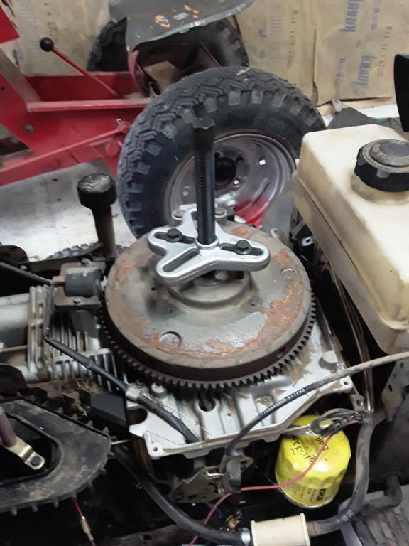

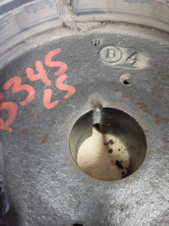

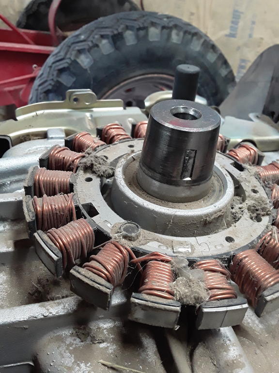

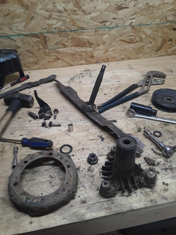

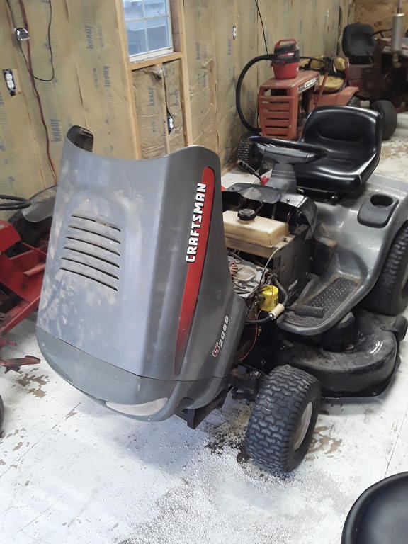

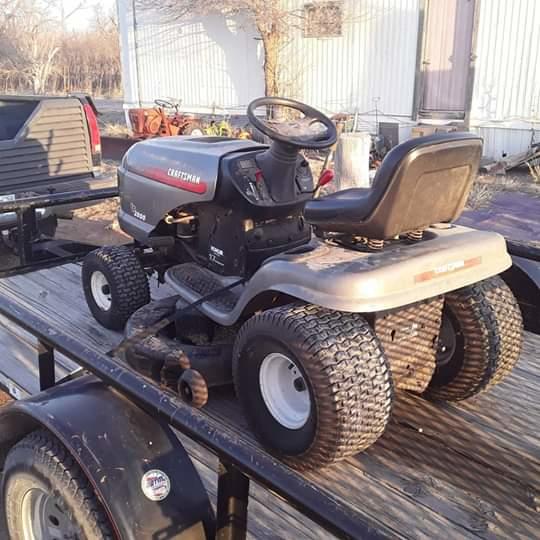

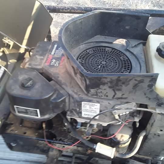

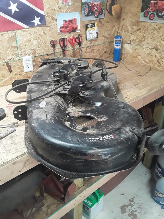

ClassicTractorProfessor 5,314 #1 Posted April 5, 2020 Took advantage of being stuck at the house (or rather the shop in this case) and worked on this Craftsman today. A few weeks back a friend of mine came by the shop and asked me if I wanted this old mower his boss had, he had been trying to get it running with no luck and they were tired of messing with it and didn't want to spend any more money on it. So I brought it home and changed the oil, replaced the carburetor as they stripped the threads holding the bowl on, and it still wouldn't start, all I could get it to do was turn over and backfire loudly. Dug a little deeper and discovered a sheared flywheel key. Finally got the key in this week, so got it put back together this morning. They sent me with new blades for it when I picked it up. Discovered a shot spindle when installing the new blades, so a new spindle and pulley has been ordered and should be here in a few days. Took the tractor itself out and drove it around the block, seems to run well and the transmission feels good. Hopefully with a new spindle, new belts, and a bath she'll be ready to go up for sale to finance other projects. 11 Share this post Link to post Share on other sites

8ntruck 6,998 #3 Posted April 5, 2020 One wonders what happened to sheer the flywheel key. I had that happen on a Toro GTS 2 cycle walk behind mower. It was a big rock hiding in the long grass in the ditch I was mowing. Quit a memorable moment! 2 Share this post Link to post Share on other sites

953 nut 55,176 #5 Posted April 5, 2020 1 hour ago, 8ntruck said: One wonders what happened to sheer the flywheel key. I had that happen on a Toro GTS 2 cycle walk behind mower. It was a big rock hiding in the long grass in the ditch I was mowing. Quit a memorable moment! I was thinking there is probably a direct relationship between the bad mower spindle and flywheel key being broken. 2 Share this post Link to post Share on other sites
