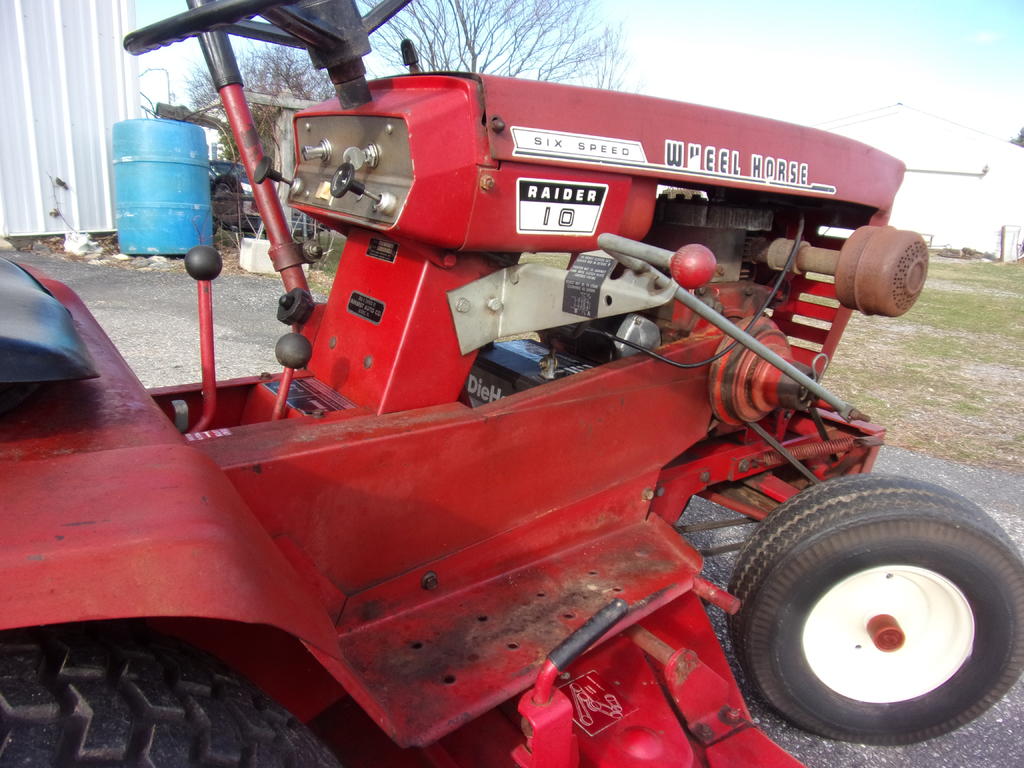

This is one reason I always liked the old Raider  style PTO lever.    It had a pressure calibration notch in the lever bracket where you set the clutch gap to 0.010".
