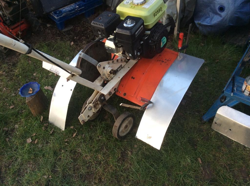

Tractorhead 9,084 #19 Posted April 5, 2020 (edited) Finished today the Tiller protection cover. i used 1mm thick Aluminum i had from the old roof from the Beast and cut it with a manual hand siccors in shape. After cutting, i bended the edges a bit more to have a better Clearance. After that i decided to give the Thing a nicer look and painted it with a Rattlecan i had in spare for the Horse. I find if both working together, they shall also look similar. Still thinkering, if i shall paint the Fueltank also in the same Red Color. Edited April 5, 2020 by Tractorhead Share this post Link to post Share on other sites
