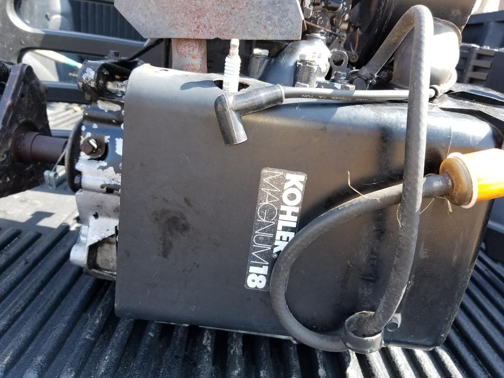

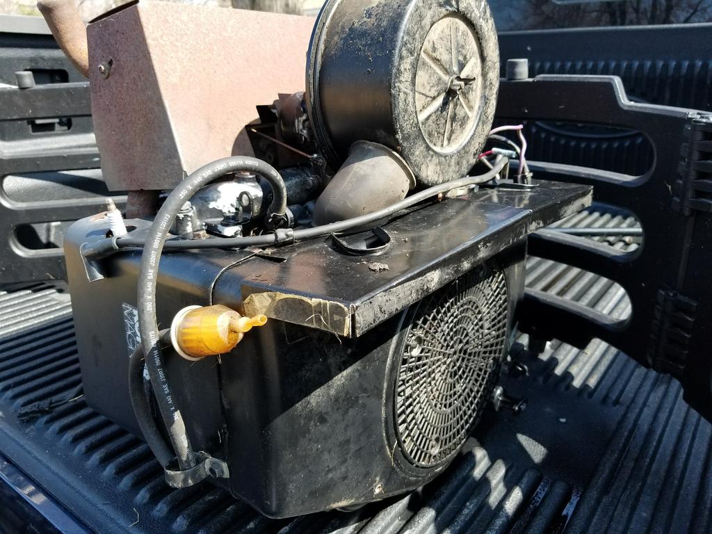

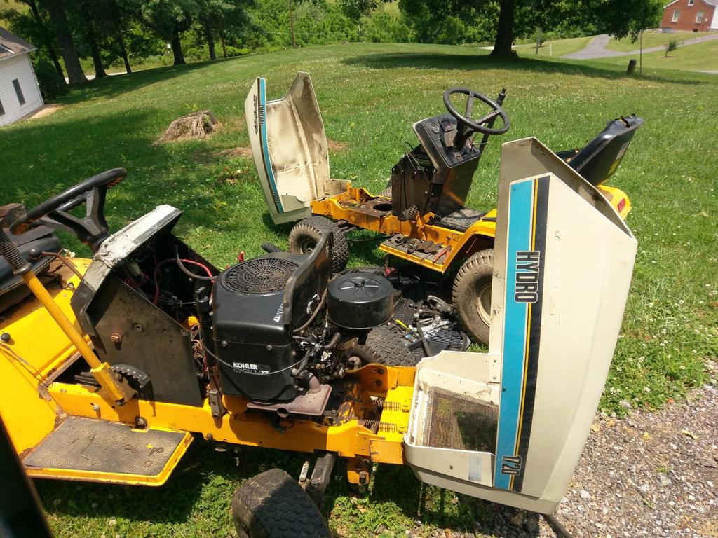

bellevillerod 835 #1 Posted March 25, 2020 Hey guys I was given an M18 vertical engine today. I don't have anything that will take a vertical. Is their anything on this worth saving? I think a lot of the parts will interchange with the Horizontal engines. I read on here about guys having problems finding parts for their 18 hp kohlers. Just tossing it out to see if anyone wants anything off of it before I set it to the road. 3 Share this post Link to post Share on other sites

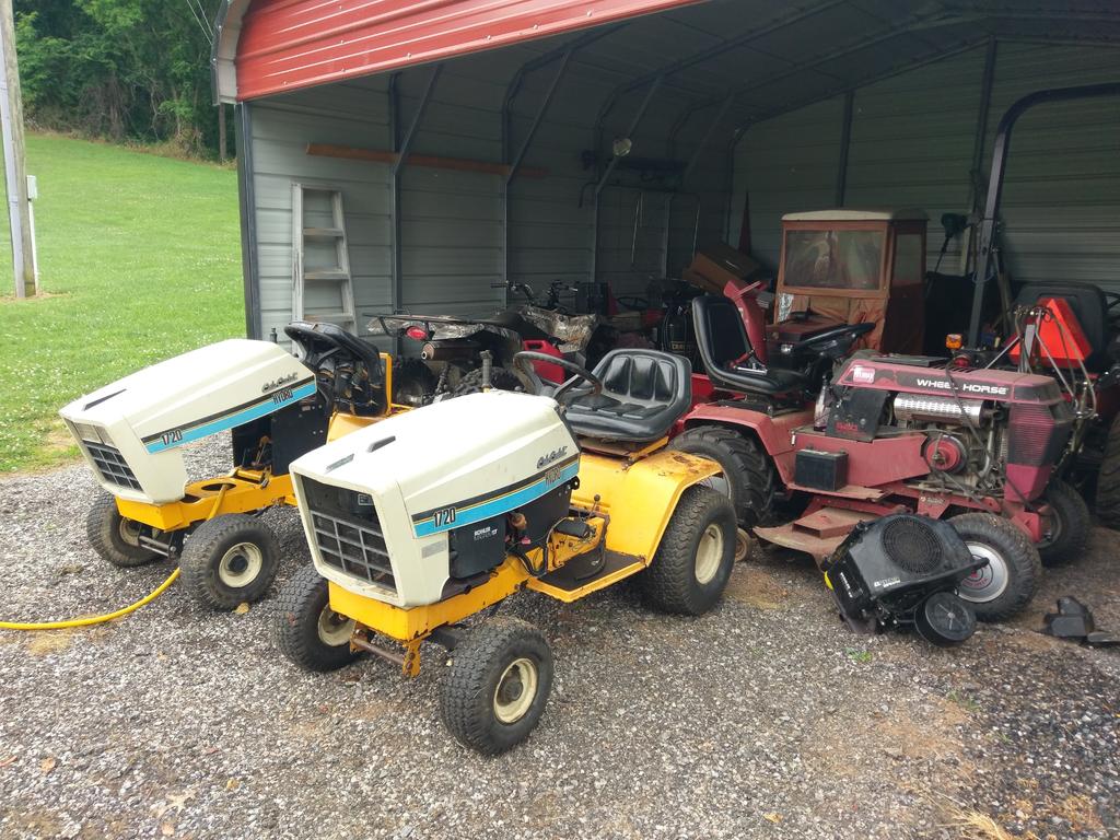

WVHillbilly520H 10,376 #7 Posted March 26, 2020 6 hours ago, ZXT said: Wish I were closer - I'd buy that off of you in a heart beat. Need a good M18 (or a crank, rods and pistons) to put in a Toro ProLine that my dad has. Bought it with the engine broken and they're scarce around here. Cub Cadet 1720 has them tiny (mower only) tractor with that M18. 2 Share this post Link to post Share on other sites

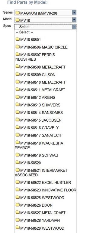

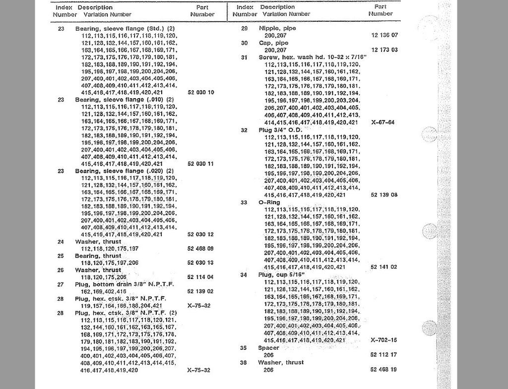

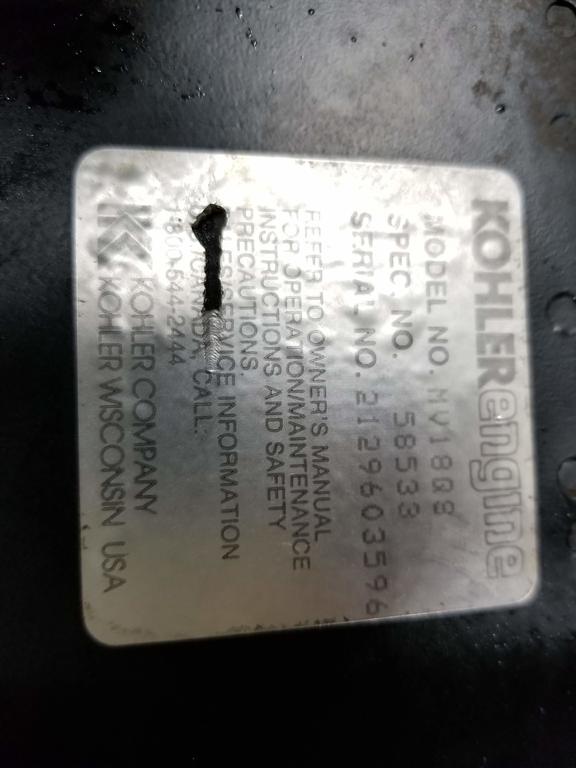

pfrederi 18,333 #15 Posted April 9, 2020 What is the Spec Number of the engine....Thrust bearings in M-18 were very rare....Note only 5 out of many many variations had the bearing... 1 Share this post Link to post Share on other sites
bellevillerod 835 #17 Posted April 10, 2020 (edited) The electric clutch was just floating under the engine. It was not bolted to anything. If you look at the first pic thats how it came out. I unbolted the engine cut the belt and lifted the engine up out of the tractor. Edited April 10, 2020 by bellevillerod Share this post Link to post Share on other sites
pfrederi 18,333 #18 Posted April 10, 2020 Engine was built for LawnBoy Does not appear that any Vertical shaft Magnum 18s had thrust bearings. Share this post Link to post Share on other sites
bellevillerod 835 #19 Posted April 10, 2020 (edited) 27 minutes ago, pfrederi said: Engine was built for LawnBoy Does not appear that any Vertical shaft Magnum 18s had thrust bearings. it's the same spec number that was used on the wheel horse tractors, also same spec as the k17 engine from what I can find. we will see when hooked up how well she works. It came off a ford tractor, didnt think lawnboy ever made tractors for ford. Gilson made those who know's with so many being bought up. Gilson, lawnboy, ford, toro could all be the same. Edited April 10, 2020 by bellevillerod Share this post Link to post Share on other sites

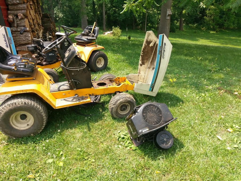

bds1984 1,466 #23 Posted April 10, 2020 I have an M18 from a Cub on my 520H. I will try to snap a picture for you tomorrow. It really isn't a complicated setup. Because this engine was badged as a Magnum 15, the governor only lets it run to 3200 RPM, but through the magic of math and larger pulleys, the belt and transmission do not know the difference. What did you do for the carburetor mount? Share this post Link to post Share on other sites
