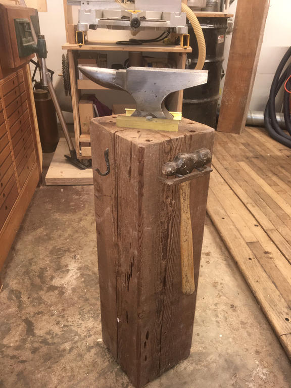

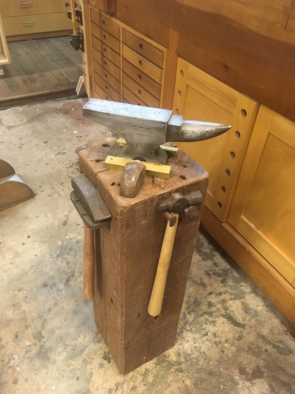

formariz 11,993 #1 Posted March 24, 2020 Even though all metal work is done in another separate shop, I often need to do some light metal work associated with woodworking such as metal inlays or hardware modification, usually involving non ferrous metals. For that I have this small anvil (15Lbs) mounted on a cedar beam that I can just move around as needed. 7 6 2 Share this post Link to post Share on other sites
Pullstart 64,381 #2 Posted March 24, 2020 So basic, yet so useful! 1 Share this post Link to post Share on other sites

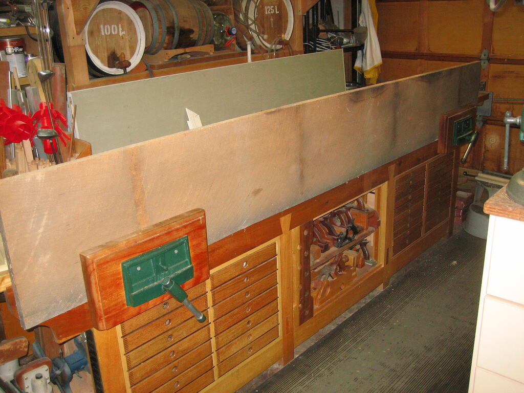

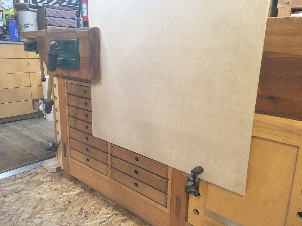

DennisThornton 4,771 #3 Posted January 22, 2021 I understand the holes in the drawers, but the door? 1 Share this post Link to post Share on other sites
formariz 11,993 #4 Posted January 22, 2021 5 minutes ago, DennisThornton said: I understand the holes in the drawers, but the door? Traveling bench slave. 1 1 Share this post Link to post Share on other sites

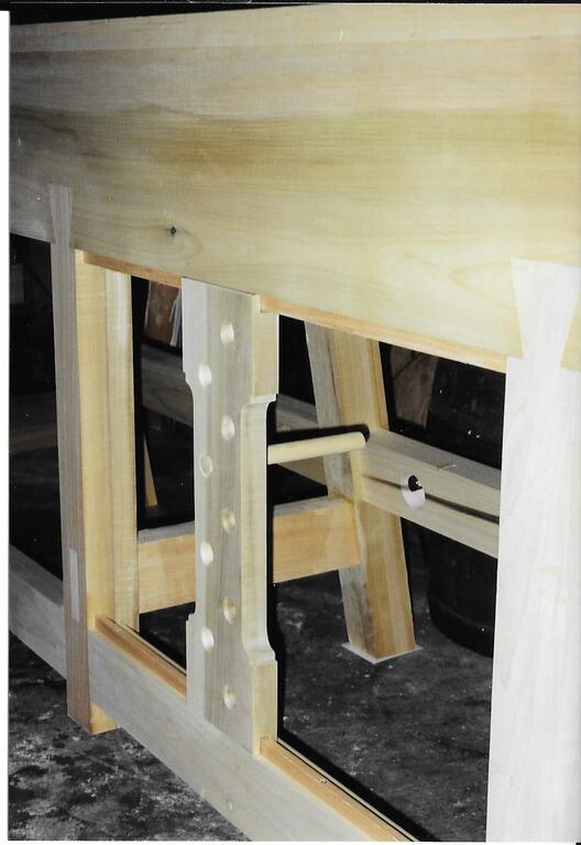

DennisThornton 4,771 #5 Posted January 22, 2021 In the door? Never seen that! I'm sure it works. I would expected them in the post. Actually. most of what I've seen were sliding where the doors are. No doors of course. Share this post Link to post Share on other sites
formariz 11,993 #6 Posted January 22, 2021 12 minutes ago, DennisThornton said: In the door? Never seen that! I'm sure it works. I would expected them in the post. Actually. most of what I've seen were sliding where the doors are. No doors of course. Originally when bench was first built it was that way for quite a while. However as bench evolved and doors became a necessity to keep inside clean, I changed it to this system. One benefit from it now is that I can have a second piece on the other end's vise and use the other door also at the same time. It has happened that way quite a few times. The bench keeps evolving as new necessities emerge. 1 1 Share this post Link to post Share on other sites
