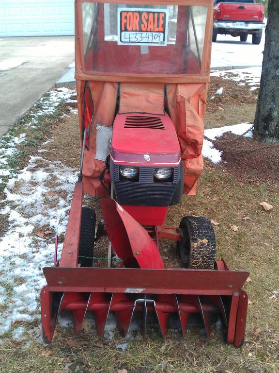

Hey guy's I need a little advise on a snowblower. I plan on redoing my C-160 Auto and turning into my snow removal machine. I just got a cab, and now looking for a blower for it. I found one with all the parts included. Look's from the pic'c to be in nice condition. Other than the obvious, dents, bearings, chute what do I need to look at? It is from the late 70's and he is asking 150.00 for it. It is a short chute machine. Is that a good price, an should I hold out for a tall chute machine? Just school me a little so I feel confident when I go to see it.    Thx    Rod

$150 is a fair price for a single-stage, low chute if everything works well.  It will do fine for fluffy snow.  A tall-chute will be higher priced, because it is a newer design and throws the snow a little farther.  Either way, check the chain, the pulleys, and the chain sprocket.    Good luck.
    Jim

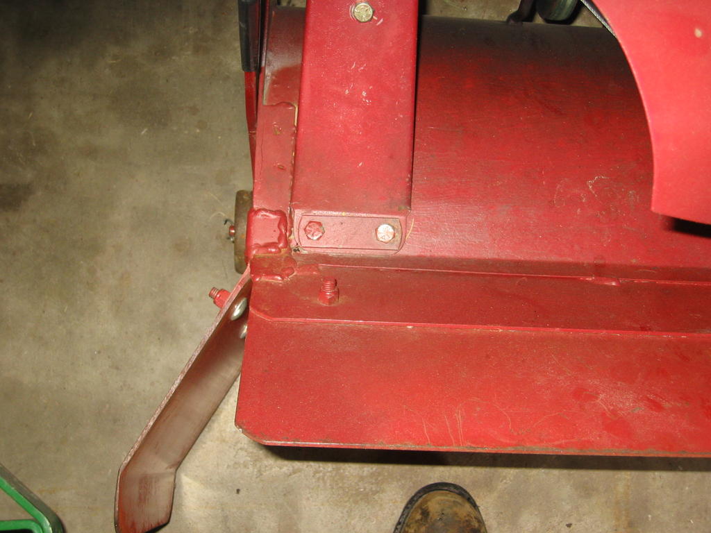

pfrederi
Check this area on both sides frequent cracks.  not real herd to repair but can be used to drive price down.
