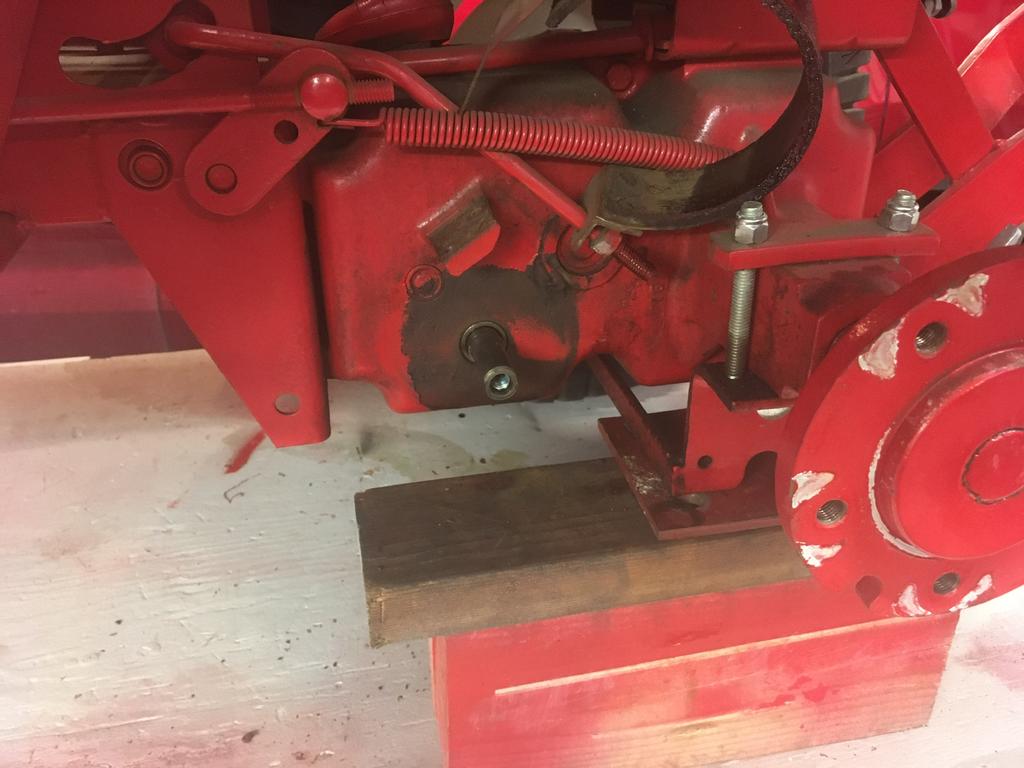

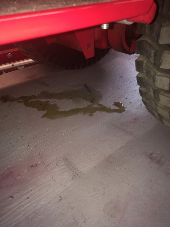

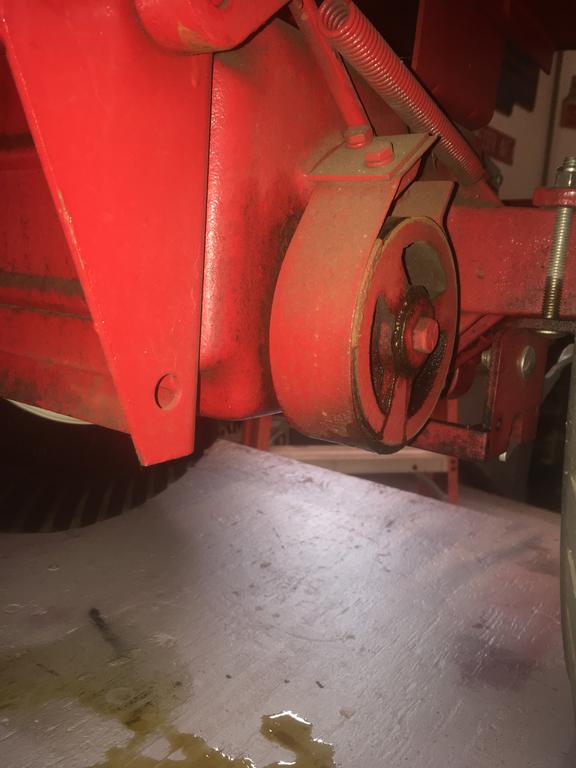

I have a C-161 8 speed that appears to be leaking at the break drum shaft. Can I change the seal from the outside or is this something that needs to be done internally? I don’t recall it leaking and when I put it up on my roll around table to mount my ez Rake I noticed it. It’s not terrible but while I have it up there I’d like to address the problem. The oil you see has taken about a week or so to drip that much. Thanks in advance to anyone who can help me 👍

Remove the 3/8" bolt holding the drum on.  It should slide off pretty easy if it has leaked for awhile. Can be done from outside. Dig out the seal with a pick. screw driver or put a small screw into it an pull that.
rjg854
Yes, you can change that seal from the outside,  good luck getting that brake drum off. The one on my 854 was a bear to remove.
stevasaurus
The brake shaft seal is SKF-#7410...it is only 1/8" deep, so don't dig too deep.  :orcs-cheers:
Lee1977
With it leaking that bad I think you need to replace thr bearings on that shaft before  putting in a new seal.  I have a C=120 that has been leaking for at least 4 or 5 years and never enough to drop on the floor.
Edited by Lee1977

Thank you everyone for your help. I’ll try just the seal before I get into the bearing. The seal alone can’t be that much money and hopefully an easy fix. I’ll post some pictures when I get into it. You guys are the best 👍👍
No, that is terrible, it is peeing like a race horse.

Like others said good luck getting drum off, made out of cast and easily broken. Don't ask how I know

I ordered the seal, it will be here on Tuesday. In the meantime I’ll keep soaking it with Kroil and tapping it lightly.

When you get that drum off check the shaft to see if there's any play up and down or forward or backward. in and out is OK. But if there's movement up-and-down on the shaft could be a bearing problem as well.

The seal came in yesterday (National Seal #312518) The brake drum slid right off luckily! The old seal came out relatively easy, I checked for play in the shaft and there’s none. Installed the new seal and topped off the transmission oil. Reassembled everything and no more leak!👍Thanks again for those who chimed in to help.

You or some one else must have had that drum off a couple times and put some anti rust on or you are just blessed with good luck. And as others have already said its a very good looking horse.
c-series don
Honestly I think that the oil leaking onto the shaft helped it from being seized on the shaft.
