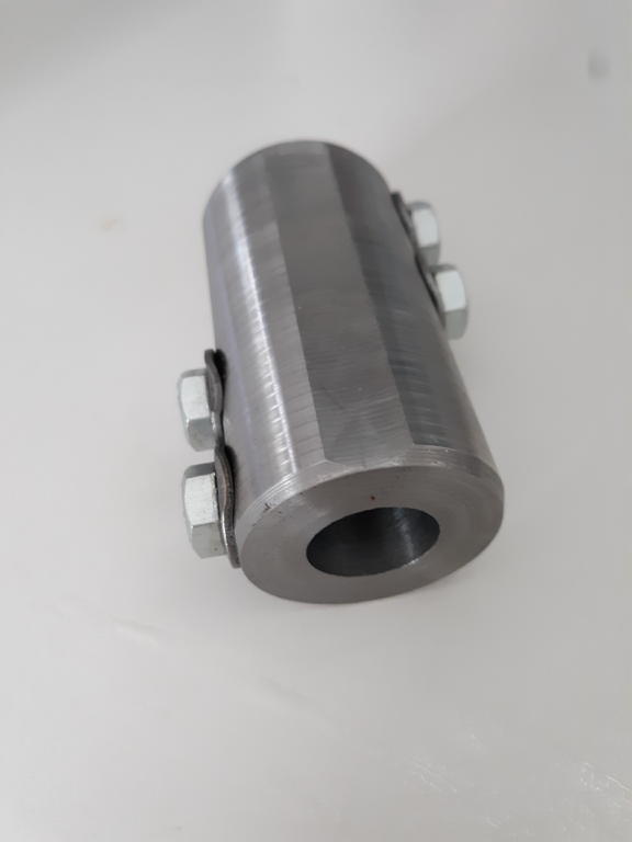

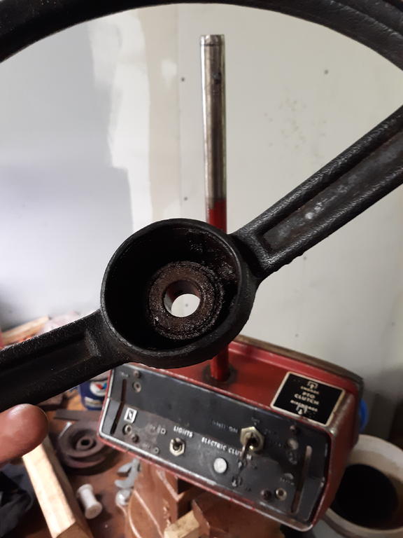

My efforts removing the steering wheel from my C100 have proven fruitless. After soaking the area in PB blaster for many days while under pressure from a puller and bearing separator I am unable to budge the bugger off the shaft. I know a hydraulic press would most likely solve this but right now I'm not keen on spending much more on this restoration. That said I still want to get it apart to sandblast and paint the dash correctly. I made this item the other day and yes its if I decide to cut the shaft but I figure I'd get some opinions before doing this.

I've resorted to cutting the shaft on a couple  and reassembled with a similar shaft connector.    I feel this is a better option than risking damage to a steering wheel.

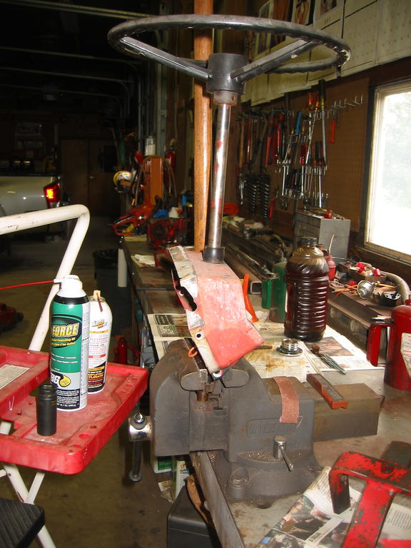

Pull the steering wheel shaft and instrument panel as a unit  Then you can clamp it in a  vice support the shaft next to the wheel and drive out even recalcitrant roll pins.  Then use emery cloth to clean the shaft 2-3" below the wheel. Now stand the whole unit up in your vice with the Gear end down against the vice body.  Climb up on a step stool with a deep wheel socket that will fit over the shaft yet rest on the steering wheel hub. Then wail away with a BFH and drive the wheel down on to the cleaned up portion of the shaft.  Then clean up the end of the shaft and you can slide the wheel off. done this on several stuck wheels.
I think I will give this a try before cutting the shaft. Thank you for a great suggestion. I don't know why I haven't thought of this 🤣

When I cut mine.
, I cut it at an angle, so it would self align, I put a sleeve over it and welded it back together

On 3/21/2020 at 4:02 PM, pfrederi said:
As far as I'm concerned there is no other way to remove a stuck WH steering wheel. Thank you thank you thank you 1000 times. :greetings-clappingyellow::bow-blue:This made an otherwise daunting task easy as pie. My restoration can now continue. Anyone wanna buy my shaft coupler I made? Lol
