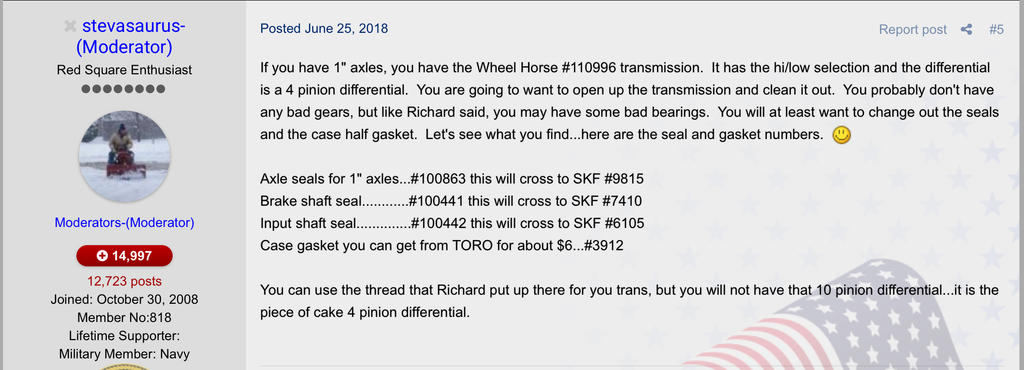

I have a 72 Raider 10 model 1 0301 with 1" axles and 5/8" drive pulley shaft. I think the axle seals are part #100863 and the pulley shaft seal is #100442.
    Can someone verify that before I order them.    Thanks in advance....

Yes SKF 9815 axle and 6105 Input

@roadapples  your transmission is a #5086.  The one above is for a different horse.  :occasion-xmas:  Same seals.
