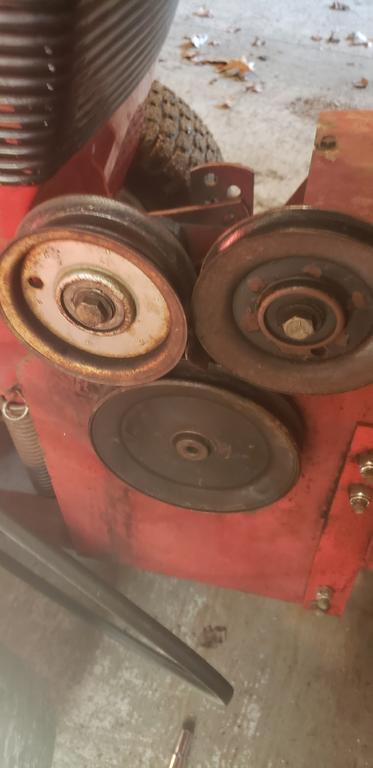

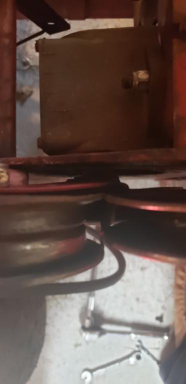

After 72 hrs of it sitting in the garage, I got to play with my new-to-me tractor and snowblower.   Seems as though in the midst of all my excitement, I broke the blower.  Pulled off the belt cover and noticed the flat idler pully seemed to chew up the belt guard bracket.  I was looking at the back of the auger housing and also seemed to notice some paint scraping from what I assume to be the auger brushing the back of the housing.  I found a dealer that has the bracket and pulley in stock within a couple hrs driving distance but my concern is once I take the 4 hr roundtrip and re-install the parts, is there anything else that could have failed that I can't see any signs of.
Pics below are the flat idler pulley and the belt guard bracket.
Hopefully I didn't kill it too bad.  Got a little overzealous with a 5 yr old sitting on my lap cheering in delight.  😏🤦‍♂️🤷‍♂️20200316_112535.jpg.10ebe92b8132634128b7911f769d495b.jpg20200316_112516.jpg.c5bda1e82031cec87994c12db857fd02.jpg

The pulley hitting that guard is common.  If the belt is less than perfect, or installed wrong, the guard will be hit.  Before powering up, rotate the belt and watch what happens.
