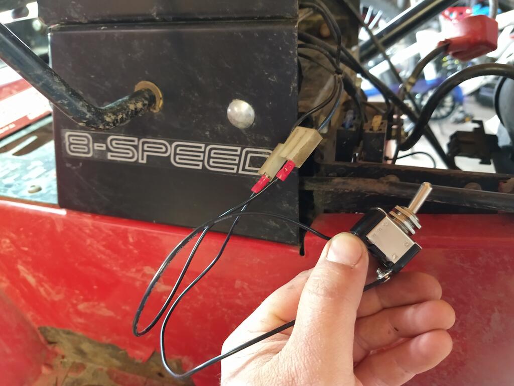

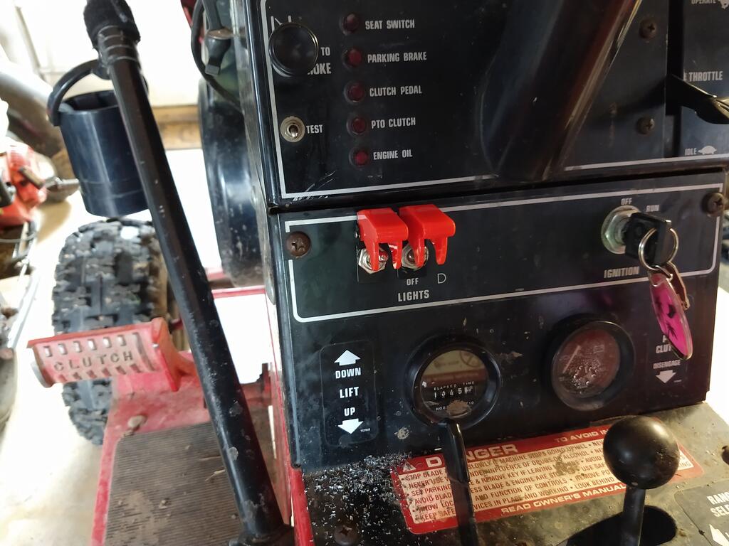

I did it and it works just how I want it. Was easier than I thought, no wire cutting involved. I just pulled the wiring harness out from the PTO switch and shoved spade connectors into the harness and ran wires to my rocker switch on the dash. When it's "on" the system is armed and getting off the seat will stop the engine. When it's "off" the system will let the engine run regardless of the seat switch.
It's reversible in 2 minutes if I ever want but again this is not going to have any implements attached. If I'm rock crawling or something where I could easily fall off then I'll arm it, if I'm stuck in the mud and need to get off and push while in gear I can leave it off.
