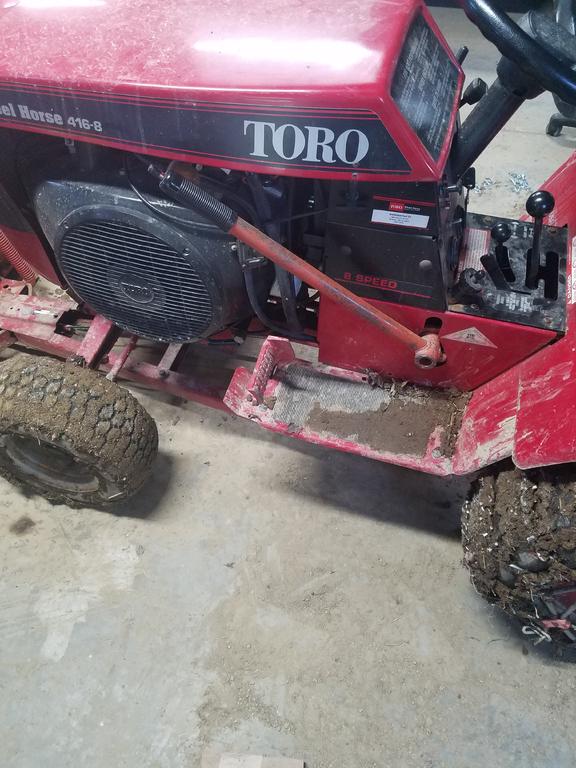

Lifting of the blade is done on hydro tractors.
I suspect near none of us could lift the front on a manual one.
:lol:
When I'm using down pressure it is definitely a constant push on the handle.

Lol that makes more sense. Although pushing down on the lever when it's this low is kinda awkward.
32 minutes ago, jrotten13 said:
kinda awkward
I'll give you that.
I'm a long limbded big Bear so that reach isn't too bad for me.

Lol fair enough. Just making sure I hooked everything up correctly.

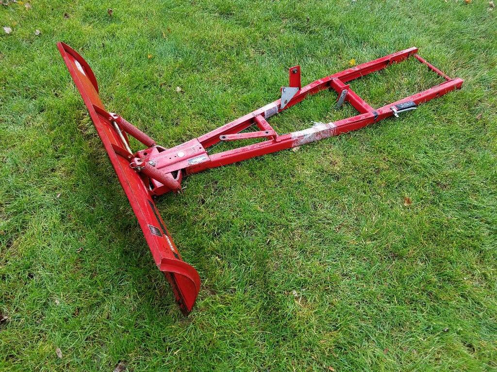

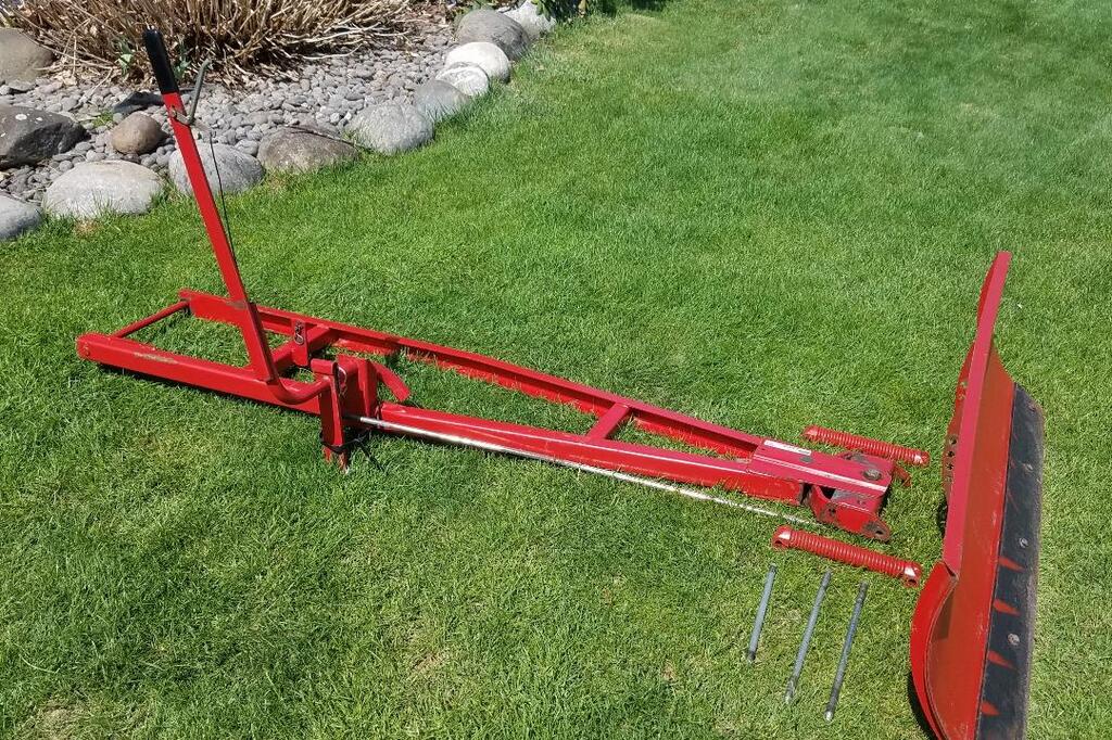

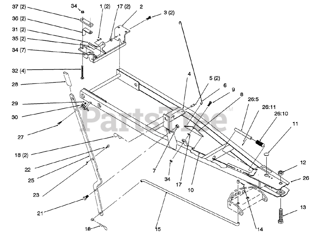

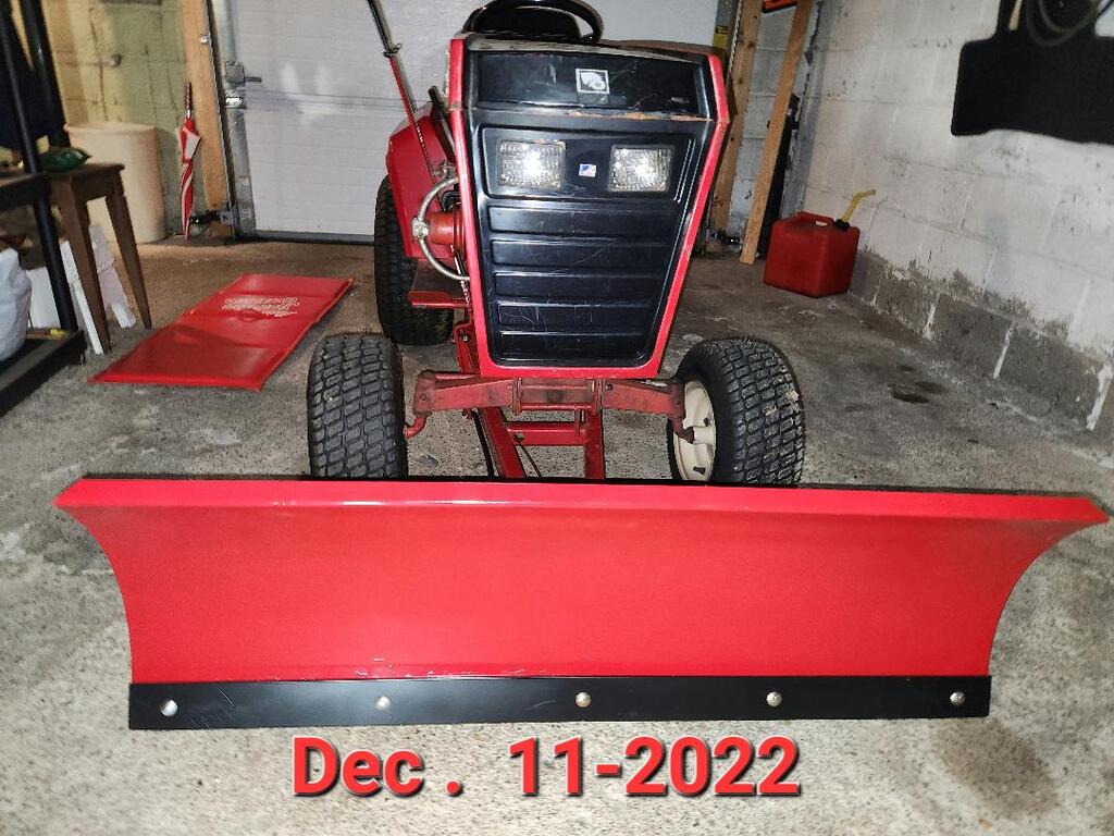

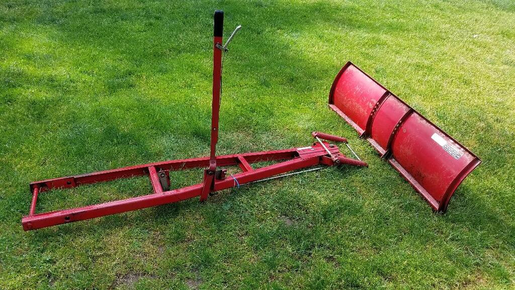

here are some various plow photos and related perspectives that may be helpful

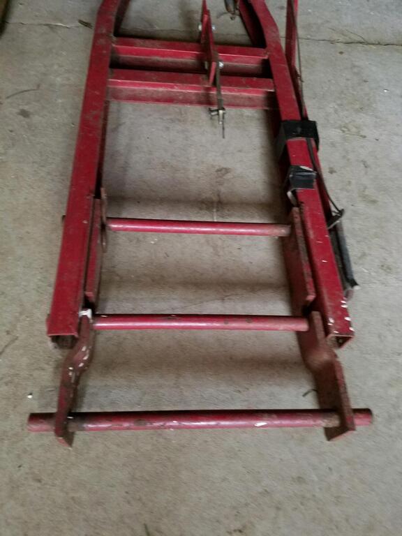

@jrotten13  what ever you get , prior to installation set it up on a couple of milk crates or a hang over shop bench . typically the steering quadrant is never serviced , packed with mud / rust , clean that out and use red aerosol grease on every related movement point , that lever squeeze handle , compresses a spring to the slide pin rector , detail that  function ,  also tighten up the end curves on the lever pull rod , eliminating play , makes for very solid smooth action . also put longer bolts in the lever rod swing points , top off with elastic lock nuts , after you make your final adjustment , the lock nuts will hold a perfect / easy setting . what ever you detail in for ease of movement , off the floor , will be the same thing on the tractor , would oil lubricate front of blade , stop rust , slide snow like crazy . aerosol lubricant , make the rust run out .1/8" hair pin clips on rear axel lever clip holes , last hole , wont lose them .have 2 of them , my experience , pete

@Wayne0 that plow set up has a down pressure solid link for that  part # 7706 , , can't imagine the weight you are lifting on related linkage points , with that added train track , unless you are a hydro . pete
