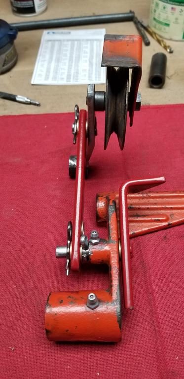

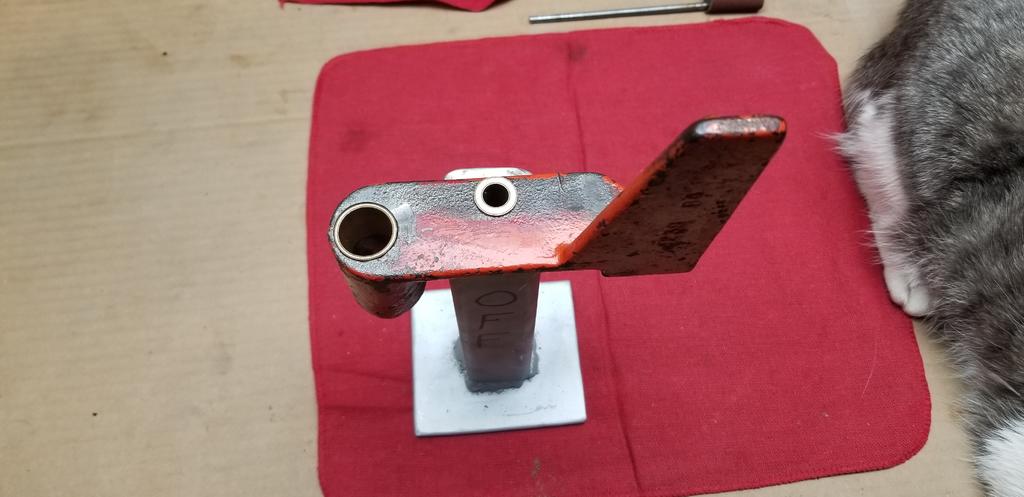

Implement clutches getting pretty worn so made up some new parts and put in some brass bushings,  will put a couple grease fittings in pedal, have to get a # 1 drill for 1/4 - 28 tap. Also making a new pulley idler arm ass'y.

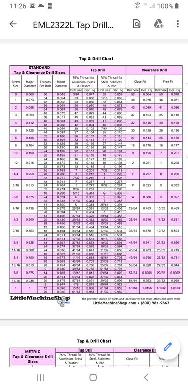

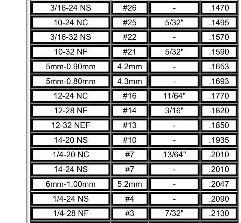

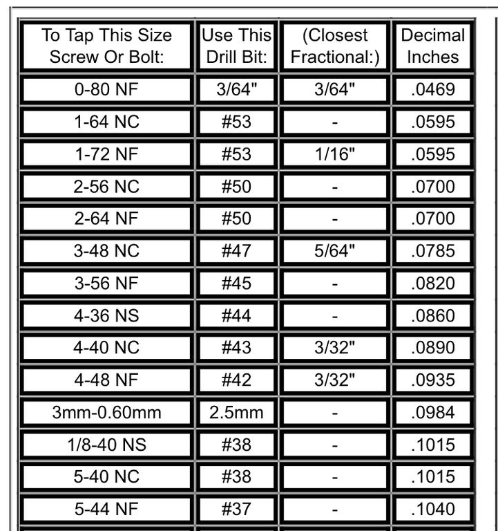

I didn’t recall a #1 bit for a 1/4-20 so I checked a chart.  It looks like a #3 or 7/32 would do the trick?
gt14rider
My drill chart calls for #3 for 75% thread for aluminium, brass, plastic. #1 for 50% thread for steel, stainless or iron.

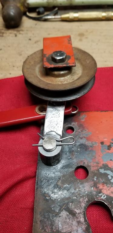

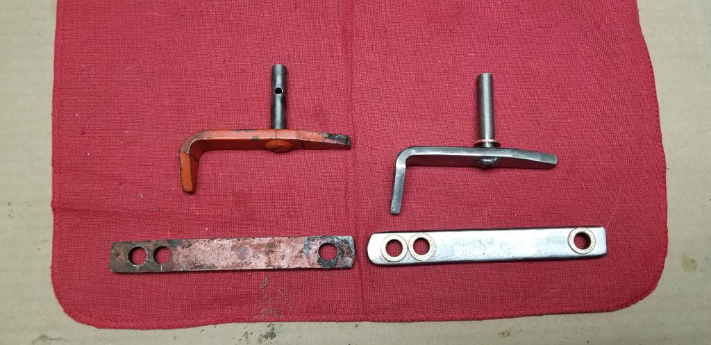

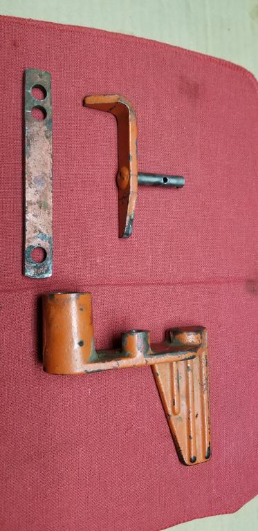

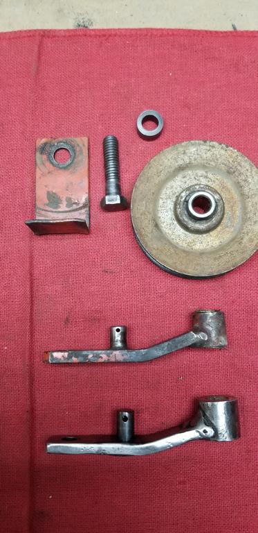

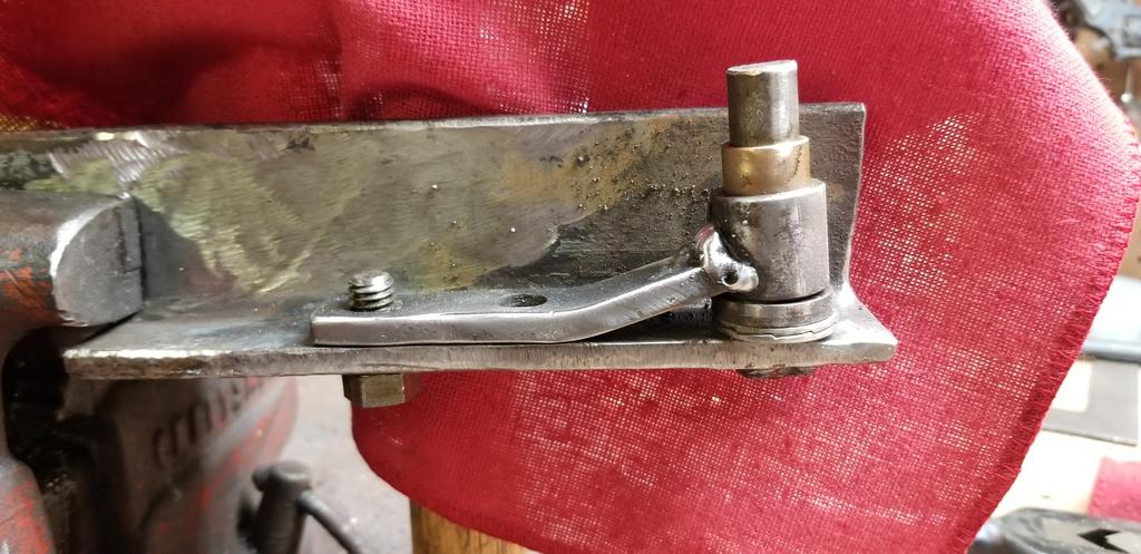

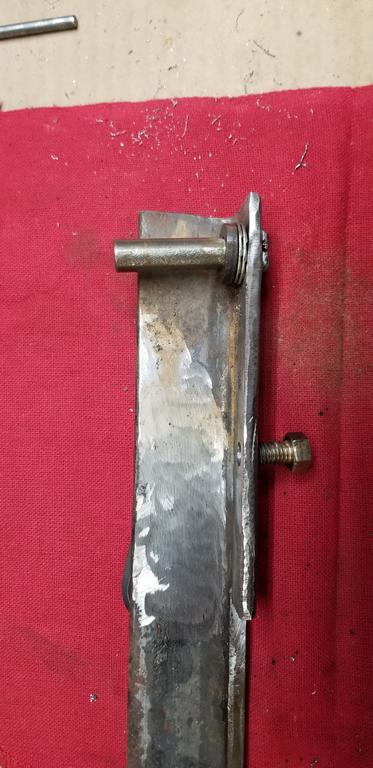

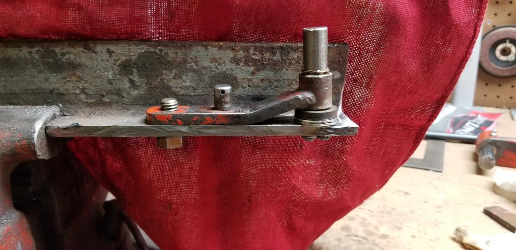

Got some more done.  Grease zerks in pedal, made a jig for idler arm ass'y. First picture is old idler arm set up on jig. second picture Is new one, welded it in the jig, added new stud. I still have to get old stud for idler arm cut off side plate and new one welded on
gt14rider

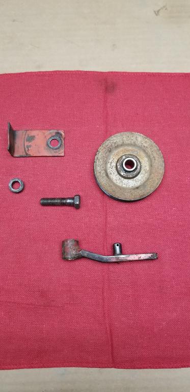

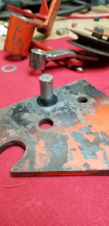

Got the idler arm stud replaced. Haven't got it on yet, last couple of days been working on 73 no name and weather's been cold and wet, car port needs to closed in and heated:violin:
