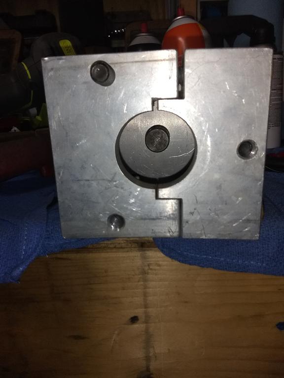

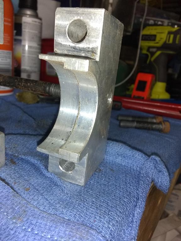

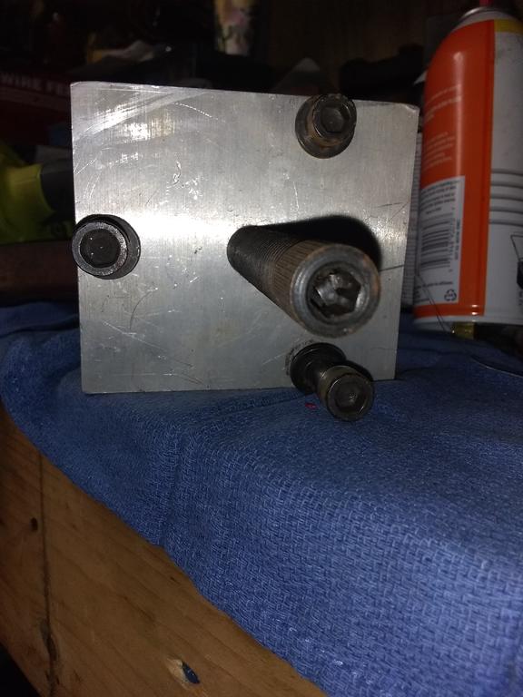

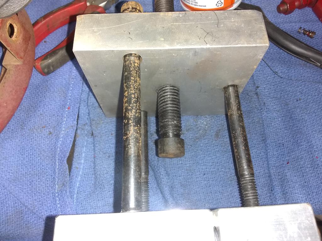

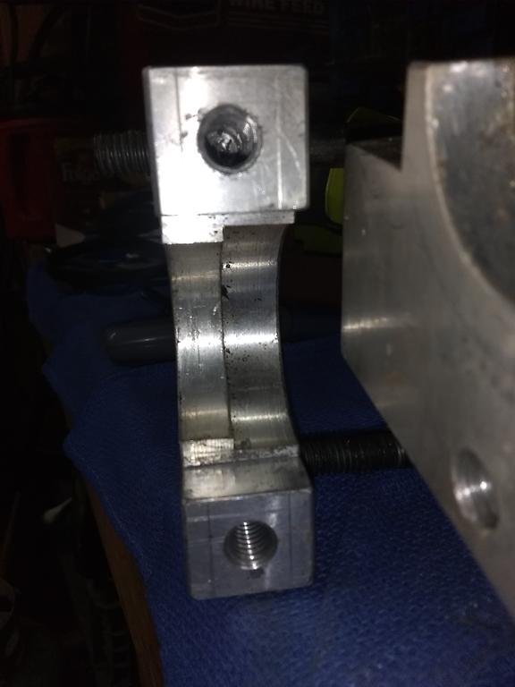

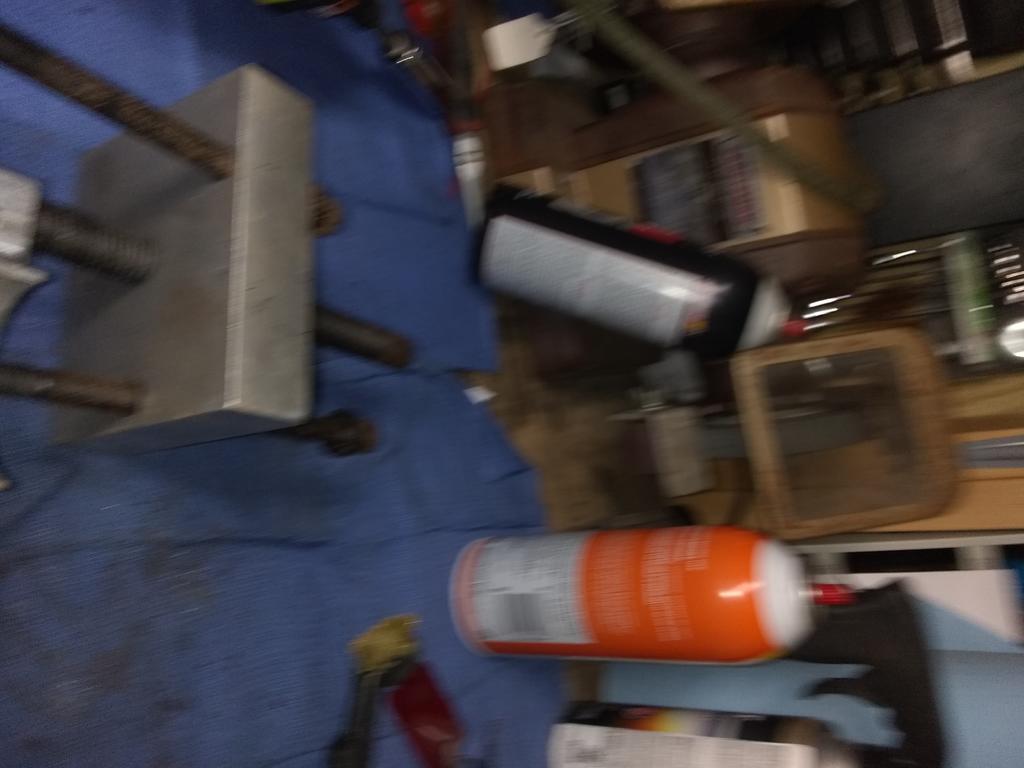

bottjernat1 2,190 #1 Posted March 11, 2020 So i have had a ton of folks ask me about the steering wheel puller i have that was my late dads. I have used it but only once dad used it many times. It is a pretty slick deal. I dont know who he got it from unfortunately. It was from a friend of his who made it. I have a video of it on my Youtube channel. I will see about getting a drawing and measurements of it soon and i will pass it along. 4 1 Share this post Link to post Share on other sites

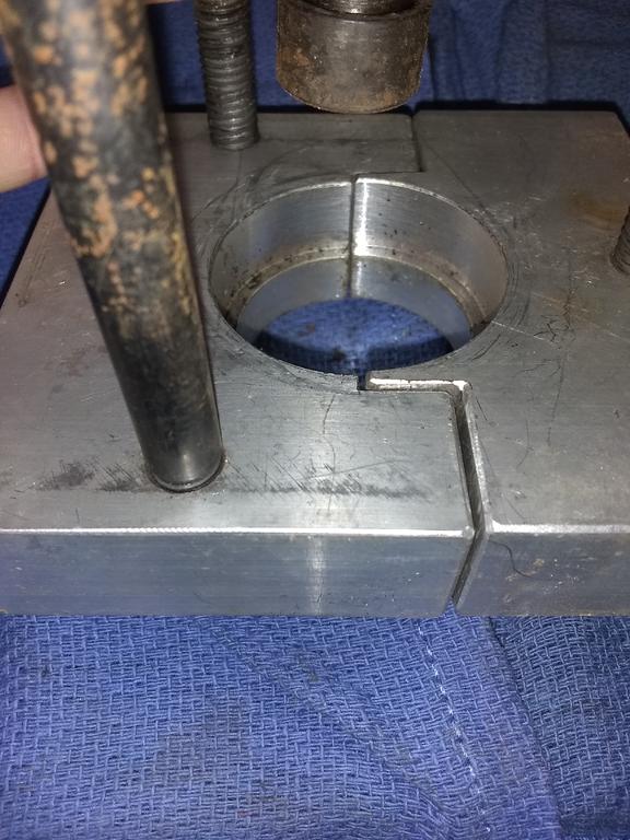

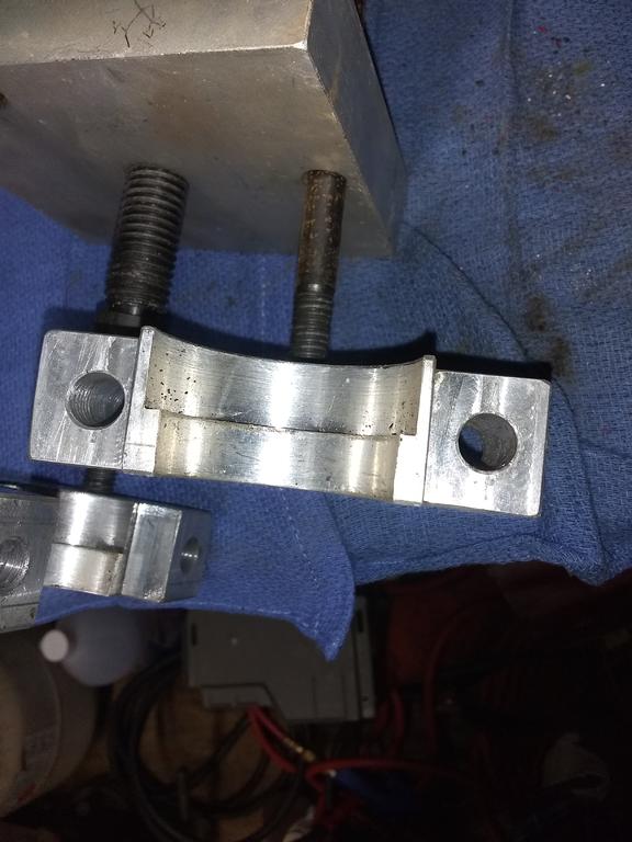

midpack 970 #2 Posted March 11, 2020 Nice work. I'm wondering if your Dads' buddy used a Wire EDM to make the split only thing I might do to improve the design would be a steel "split" bushing to sit inside the stepped bore to press directly on the steel part of the steering wheel. IIRC the outer cover hangs below just a bit 1 Share this post Link to post Share on other sites
bottjernat1 2,190 #3 Posted March 11, 2020 I agree i would like it to be made of steel all together. It could take more of a beating this way! Share this post Link to post Share on other sites
squonk 42,534 #4 Posted March 11, 2020 Another idea would be a fine thread push bolt. More pulling power 1 Share this post Link to post Share on other sites
8ntruck 7,383 #5 Posted March 12, 2020 11 hours ago, midpack said: Nice work. I'm wondering if your Dads' buddy used a Wire EDM to make the split only thing I might do to improve the design would be a steel "split" bushing to sit inside the stepped bore to press directly on the steel part of the steering wheel. IIRC the outer cover hangs below just a bit Looks to me like the interlocking blocks were made first,then they were bolted together and the center hole was machined. Share this post Link to post Share on other sites
midpack 970 #6 Posted March 12, 2020 OK, yeah that makes sense. Wire EDM is my specialty, that's why I thought of it first Share this post Link to post Share on other sites
