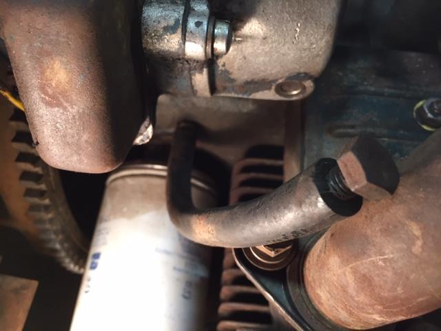

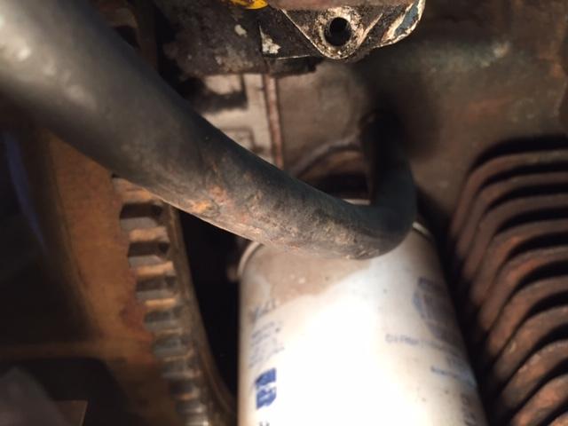

I am working on a Roof Palomino mower that has a Kohler K482 engine in it and have a question about a "mystery" hose on the engine. It is located directly above the oil filter. The end of the hose has been plugged with a bolt. I am not seeing anywhere that the end of the hose should hook up to. I have attached a couple of pictures. Does anyone know why the hose is there or what it attaches to?? Thanks for any information.

Just guessing but a case breather?? Guys more familiar with that motor  will be along to welcome and  offer answers.

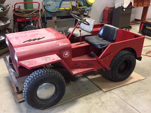

Thank you for the quick reply. I appreciate your thoughts. I have attached the only current picture of the Palomino that I have. I have the original mower deck for it but have it removed.

Nice! :handgestures-thumbupright: ...looks to be orginal and unmolested!
Tractor buddy we know had a nice one too. Only decent pic I have of it.

The breather is on top of the head... Is it screwed in, or on a barbed fitting?
kylep
It is a barbed fitting.
19richie66
My K482 just has an Allen head plug there. Maybe a crankcase vacuum port for LP gas regulator or some kind of diaphragm pump?
Mudrig150
On most of the diagrams I see it's a 90 degree fitting with an oil pressure guage fitted to it. Might be a guage feed.
