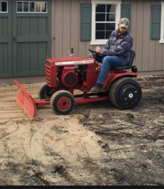

Not content with just one project at a time I'm thinking about some kind of dozer blade for the C125 to help clear walk ways.
The one in the new pole shed thread looks great.
Anyone have any plans or drawings for the attachment frame?

20200229_132549.jpg.e900cb6886fe42b1ba195a658762475a.jpgthis is the one I saw on another thread.

Looks just the thing Norm.
Making the curved blade is my big concern but I'll start with designing the frame.
There is one on ebay 10 miles away from me but its rusted and he want 80 quid for it.
Not even sure it would fit.
It's made from channel section for the frame but I'm thinking rectangular section? But the channel would be easier to paint.
Does yours raise up with the implement lever by the way?
 Local smithy did that for me. You should be able to find a fabrication company near you who would do it.
Quote
 Made mine from tube as that was what I had lying around.
Quote
Yes with a solid bar. Not chain.
You'll need the bracket etc for the rear axle if you haven't got it. I made mine.
