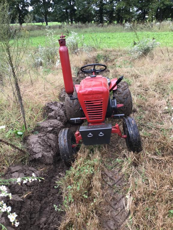

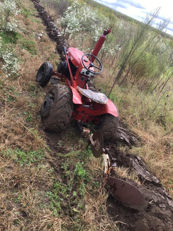

David Ullman 142 #1 Posted February 28, 2020 I took out the three speed and replaced it with a six speed, in the future I'll be swapping the pulley to gear it up a little. 4 4 4 Share this post Link to post Share on other sites

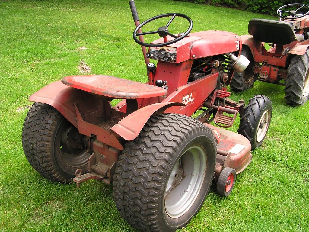

ri702bill 8,560 #6 Posted February 28, 2020 David: Yours looks like it started out as a 1962 502 or 552. Nice tractor. I did the swap on my 854 using the Unidrive from a 1979 C81. No regrets. Bill 3 1 3 Share this post Link to post Share on other sites

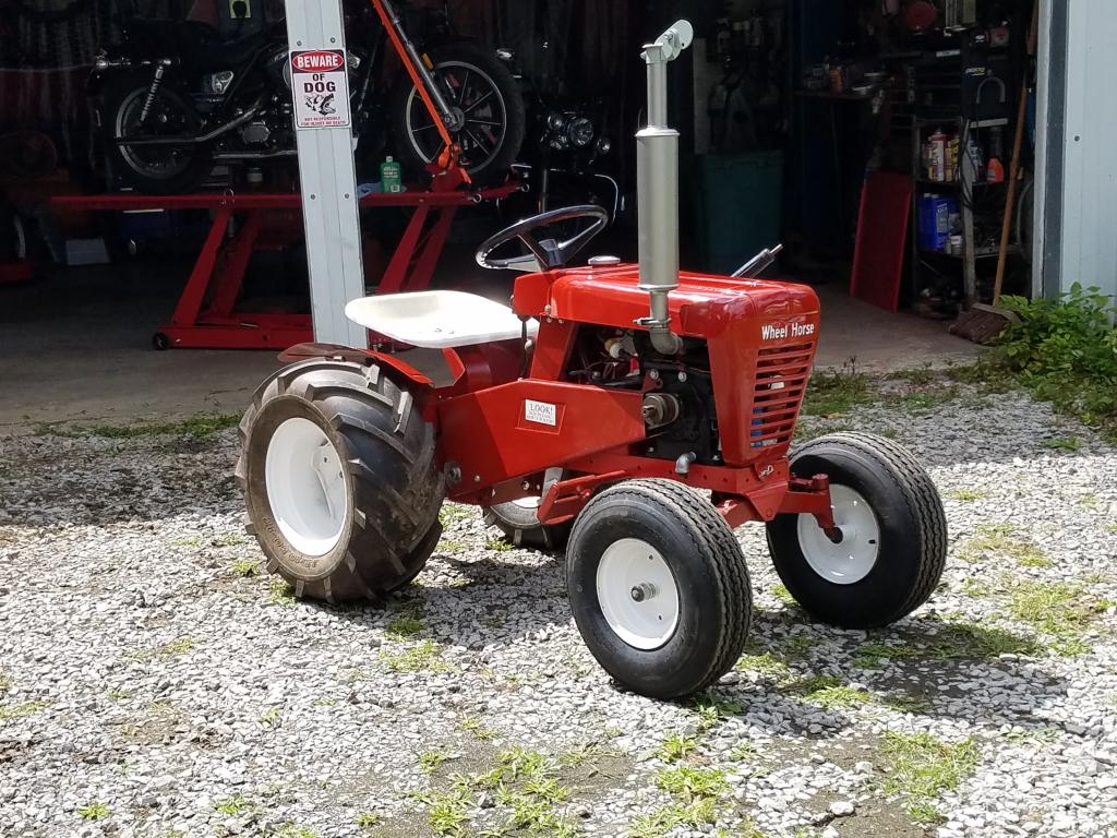

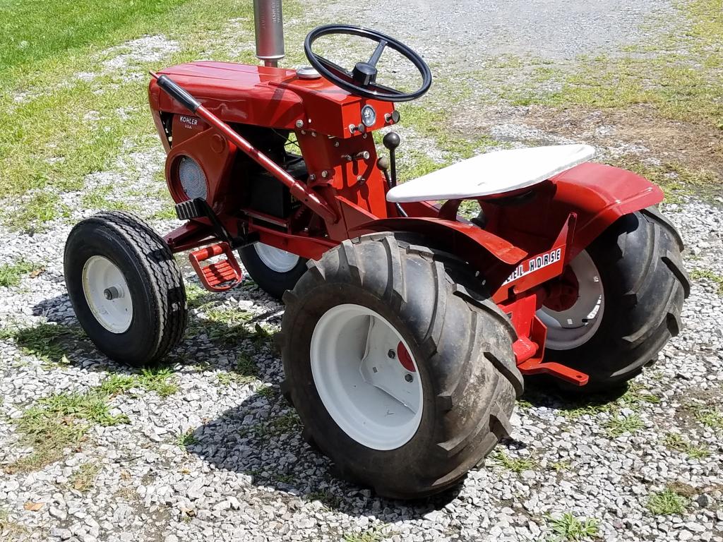

857 horse 2,581 #8 Posted February 28, 2020 AT THE TIME,,I WASNT AWARE THERE WAS A SQUARTE PLATE ON THE BACK OF THE FRAME,,,,SO I MADE AN ADAPTER,,,,ITS AN 8 SPEED OUT OF A 310-12............MY FIRST BUILD..... 1 6 Share this post Link to post Share on other sites

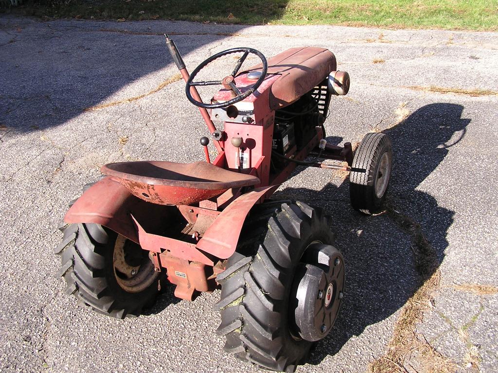

Pullstart 63,201 #9 Posted February 28, 2020 Seems like a low gear in a round hood is a favorite of many! This is an 8 speed out of a ‘78 C-101. Seems I put a similar sized pulley as a stock 502 because my engine pulley was smaller than the later model donor, but I think the input shaft was a different size? @stevasaurus was one 5/8” and the other 3/4”? 2 1 Share this post Link to post Share on other sites
stevasaurus 22,910 #10 Posted February 28, 2020 Yep, 3/4" was on the early 3 and 4 speeds. 5/8" on the 8 speeds. 2 Share this post Link to post Share on other sites
