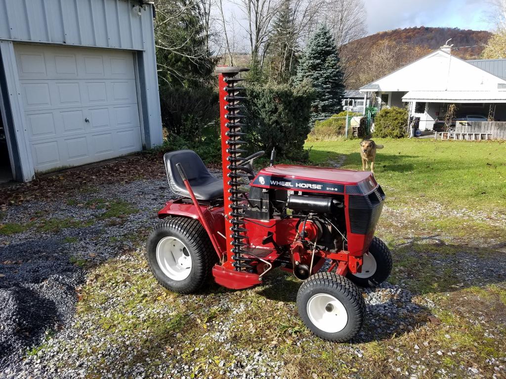

David Ullman 142 #1 Posted February 28, 2020 I found this sickle bar on a wheel horse but not for 310-8. I had to drill new holes but I finally got it to work even works vertical. 3 6 Share this post Link to post Share on other sites
Stepney 2,356 #2 Posted February 28, 2020 That looks like an old 7-1311/12? Be careful .. as I understand, those are not meant to be run in the vertical position, they will starve for oil. 3 1 Share this post Link to post Share on other sites
David Ullman 142 #3 Posted February 28, 2020 OK good to know, I haven't use it for to long yet. Share this post Link to post Share on other sites
peter lena 9,557 #4 Posted February 28, 2020 david, great pick up on that , pay attention to no vertical use advise as well as the lubrication ,mandates , to keep it running smoothly , you might even look up john deere " corn cob grease " for multi angle drive systems , pete 1 Share this post Link to post Share on other sites
