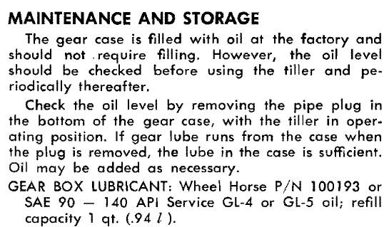

What fluid should be used in the gear case on these old tillers?
From a later operator manual
Garry
josephd2212
Awesome!  Thank you
