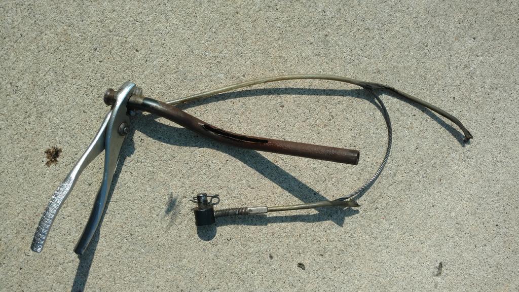

84Workhorse
Thanks Lee1977 for your reply. That's what I needed to know. My 520 didn't have the tube which I thought might have been standard on all of them. On my GT the cable was obvious but I couldn't see the tube without taking the seat off. For some reason I had a hard time finding a replacement part online since I didn't think to look at the online tiller parts manual. Long story short, I removed the seat on my GT and found the tube and hold-down bracket and after removing it found it's worn out (see picture). There's a definite groove worn in the tranny from the cable after 35 years of back and forth in there. I ordered a new cable and tube so hopefully next week I will be tilling with the 520. Thanks again.
