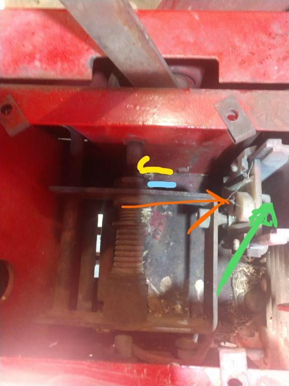

pfrederi 18,126 #2 Posted February 21, 2020 Loosen the jam nut (blue pointer ) 1-1/8" then you will see the end of the threaded shaft (yellow pint) has four flat surfaces. use a 5/8" wrench to tighten it. When you have desired resistance on the motion control lever tighten the jam nut. 5 1 Share this post Link to post Share on other sites

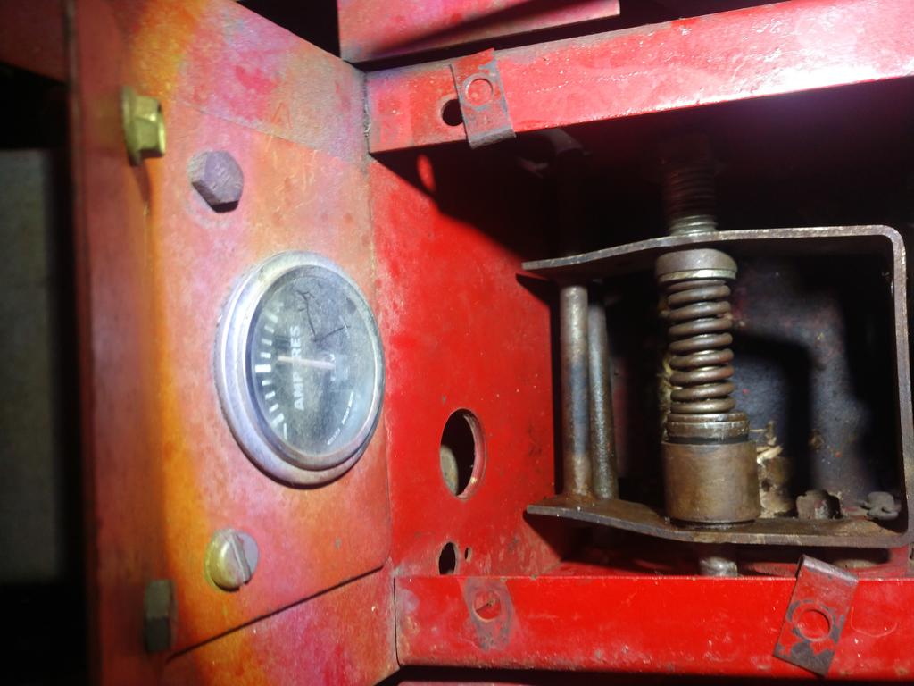

seven 202 #3 Posted February 21, 2020 Thanks that seems to help the spring is compressed as far as it will go now. I seem to be missing the little tab spring on the shift lever itself also Share this post Link to post Share on other sites
Pullstart 63,435 #4 Posted February 21, 2020 (edited) Does it creep one direction, or does it vary? It might need adjustment on the cam plate. Raise the rear tires off the ground, then while the motion control lever is in neutral/brake pedal depressed, loosen the set screw (green arrow) and adjust the cam screw (orange arrow) as needed to get neutral to the tires. This needs the engine running, of course. Edited February 21, 2020 by pullstart 2 1 Share this post Link to post Share on other sites

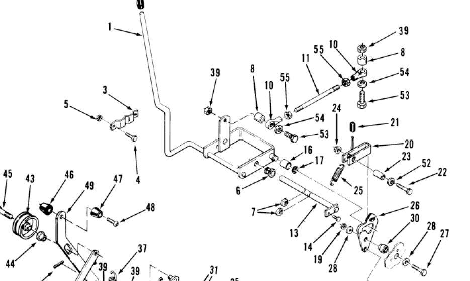

pfrederi 18,126 #5 Posted February 21, 2020 15 minutes ago, seven said: Thanks that seems to help the spring is compressed as far as it will go now. I seem to be missing the little tab spring on the shift lever itself also Are you referring to 6-14 or something else... Share this post Link to post Share on other sites
seven 202 #6 Posted February 21, 2020 No not 6-14 I thought there was a spring like tab that used to rub against the shift lever to help hold it in neutral ? Maybe not .but it is not shown in this detail Share this post Link to post Share on other sites

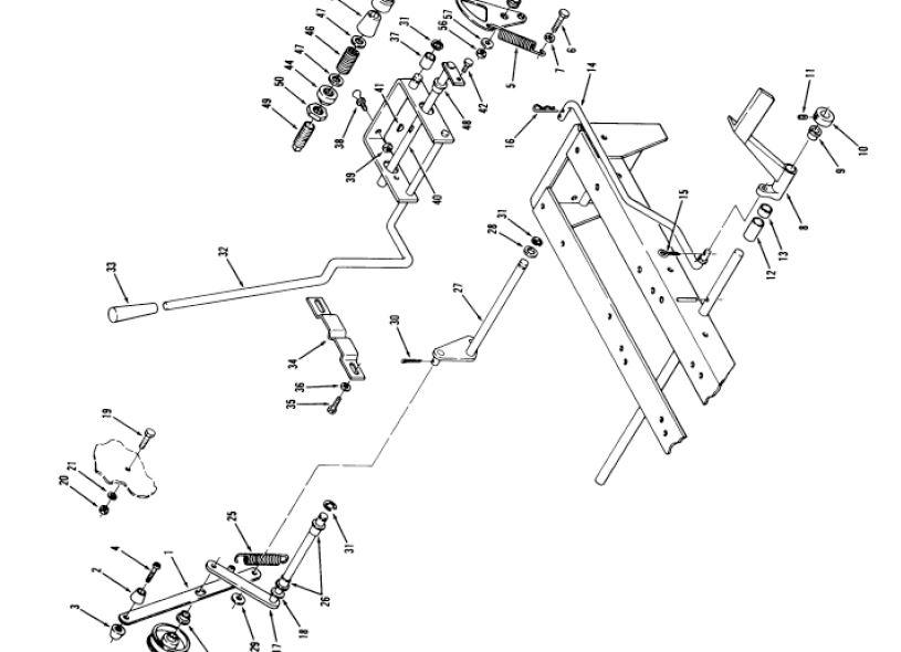

pfrederi 18,126 #7 Posted February 21, 2020 I do not have late model Sunstrands none of my Chargers have a plate spring. 418A Eaton has what i think you meant. Item#3) Do not know when WH started using them. You might be able to add one.... Share this post Link to post Share on other sites
pfrederi 18,126 #8 Posted February 21, 2020 By1977 C160s had the plate!! 2 Share this post Link to post Share on other sites
seven 202 #9 Posted February 21, 2020 Yes 3 or 34 what I was thinking it had but now I'm not sure it's definitely not there ..and I'm not sure what year it is Share this post Link to post Share on other sites

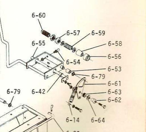

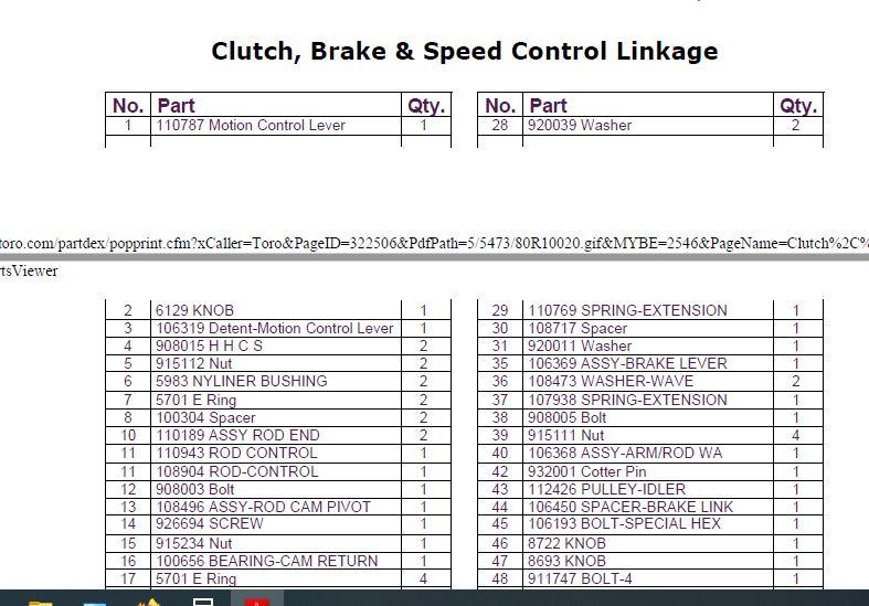

seven 202 #10 Posted March 15, 2020 On 2/21/2020 at 1:37 PM, pfrederi said: Are you referring to 6-14 or something else...this is what I have I need to take the shift lever all the way out now because when I tightened the spring to much it bent it apart I'm try to figure out how part number 6-58 comes out of 6-56? Share this post Link to post Share on other sites
seven 202 #12 Posted March 15, 2020 Part 6-58 does not move on shaft Share this post Link to post Share on other sites
