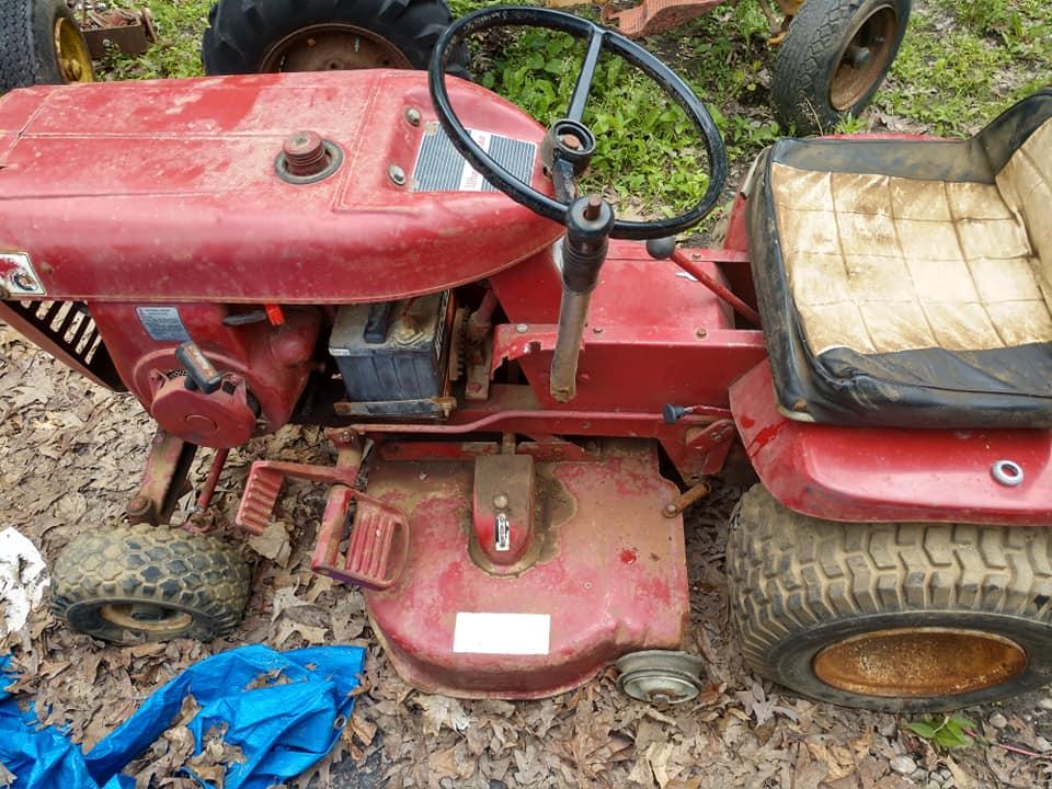

upstate yank 219 #1 Posted February 10, 2020 I AM NOT SURE IF ANYONE HERE CAN HELP ME BUT TODAY MY NEIGHBOR AND I WENT ON A 2 HOUR DRIVE ONE DAY TO PICK A WHEEL HORSE TRACTOR WHICH FOR THE PRICE OF 200 DOLLARS WHICH I THOUGHT HE DID ALRIGHT FOR THE YEAR AS BEING A 1967 AT LEAST THAT IS WHAT I THINK IT IS BUT ANY WAYS THERE IS NO KEY FOR IT ;IT HAS THE PULL START PLUS THE STARTER BUT AGAIN NO KEY' SO IF ANY ONE MIGHT HAVE A SPARE OR KNOW WHERE TO GET ONE HE SURE WOULD APPRECIATE IT ;HERE ARE A FEW PICTURES OF THE OLD GIRL ; AS WELL THE TIRES ARE GOOD ON IT PLUS THE BELTS;THOUGH THE IS WHAT DO YOU USE TO REMOVE THE STEERING WHEEL TO REMOVE THE HOOD 'THANKS AND I HOPE TO HEAR BACK 2 Share this post Link to post Share on other sites

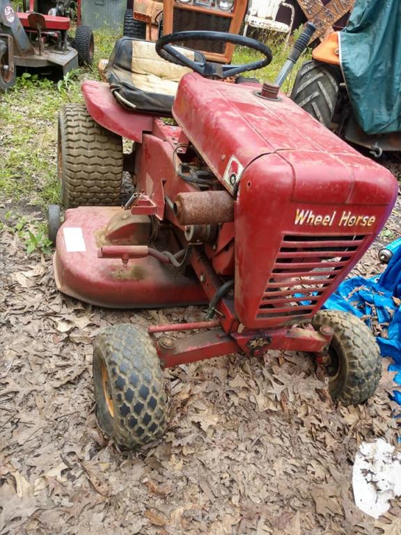

pfrederi 17,743 #2 Posted February 10, 2020 (edited) It is a lawn Ranger for sure I would guess an L157 but the steering wheel is not correct. probably a roll pin in there you have to drive out. Rangers originally used a clevis pin and hair clip for the steering wheel. Edited February 10, 2020 by pfrederi 1 Share this post Link to post Share on other sites
lynnmor 7,321 #3 Posted February 10, 2020 Plus start soaking the shaft with penetrating oil now. 1 Share this post Link to post Share on other sites
Achto 27,639 #4 Posted February 10, 2020 21 minutes ago, upstate yank said: BUT AGAIN NO KEY I may be wrong but I think you need a Cole Hersee key. http://www.partdeal.com/wiring-electrical/switches/accessories-hardware/cole-hersee-short-hencol-key-for-ignition-switches-boxed-83357.html?utm_source=google&utm_medium=cpc&adpos=&scid=scplp77161062&sc_intid=77161062&gclid=CjwKCAiA-P7xBRAvEiwAow-VaaLiq8U8sNl8jbA9lvAg65hzypYz-K_wQbije0-n9R6-hyfTUZDpkBoCO7IQAvD_BwE 1 1 Share this post Link to post Share on other sites

upstate yank 219 #10 Posted February 10, 2020 thanks to everyone that replied about the model l-157 as the buyer bought the correct key though e-bay again thanks guys 1 Share this post Link to post Share on other sites
