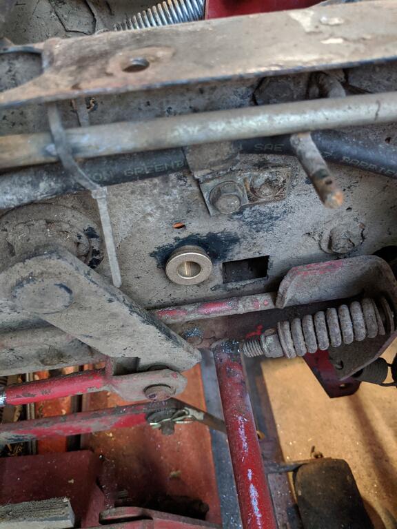

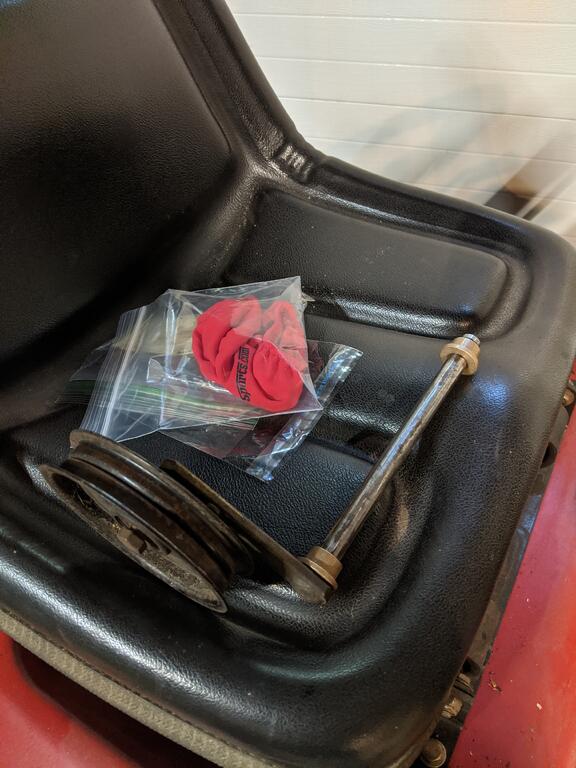

Any advice for the bushing I got to repair this?
I was going to put both on the shaft...but than I may have to cut the far bushing down so the c-clip fits on. So I thought I could put the c-clip side in the other way. Anyone see a problem with that?
EDIT: Okay, the second pic does not work, the shaft is not long enough to accommodate the bushing collars on both sides. It will have be cut done to a sliver just wider than the metal hole... and inserted with the shaft. Or maybe just add 1/2" washers?
2nd EDIT: Had to drill a hole behind the bushing collar to hold it in place with a washer and hairpin. The cut down bushing does not fit well enough in the worn out shaft.
Cleat's drawing will work best for me, the shaft needs to be a half inch longer, than the bushing can be inserted from the outside and the clip can be used (Or a hairpin).
Also do I want to grease the shaft and the top of the bushing that sits in the hole?IMG_20200613_191003.jpg.af27a458321f7de4bf0436f1c82eb500.jpgIMG_20200613_191830.jpg.c8b0ef4bb79dd3f1081b169968160897.jpg
