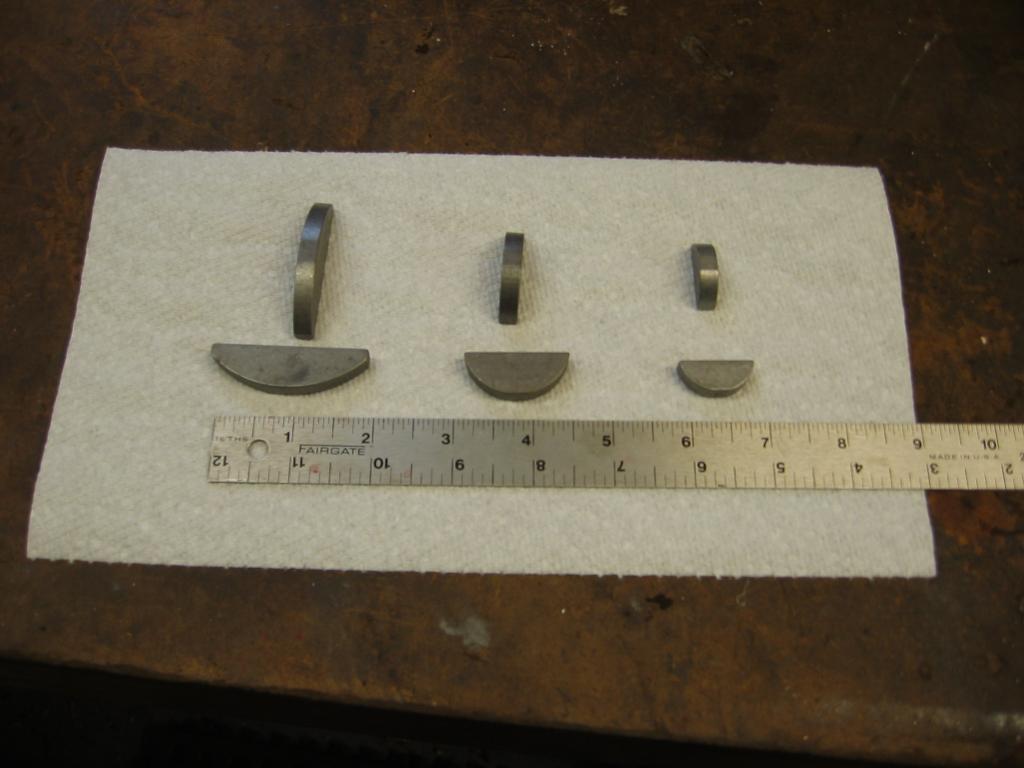

pfrederi 18,333 #1 Posted February 6, 2020 (edited) Over the years WH used different size woodruff keys on the axles. It is also a weak spot based on the number of wallowed out keyways I have come across. However, on some units they used the big (but hard to find, McMaster doesn't have them ) #RX key (left in picture). But as best I can figure only on 1054, GT-14 and D series. Now the hubs on those an be a real PIA to pull but I haven't found one with a messed up axle keyway. Kind of obvious in this case that "Size Does Matter". Wonder why they didn't use them more often??? Older tractors 855s, Lawn rangers and the like used #15 keys (Right). C series and later # 22 (center). Anyway I now have a few #RX keys so if you need one.... Edited February 6, 2020 by pfrederi 4 1 1 Share this post Link to post Share on other sites

McGrew 460 #4 Posted February 6, 2020 pfrederi, Experience taught me that when you see changes like this, and there is no good explanation, the answer almost always comes back to money... Smaller keys were cheaper, and required less machining of the axles? . Danny 1 Share this post Link to post Share on other sites
R. L. Addison 299 #5 Posted February 6, 2020 My '79 C series have the same key as D series. I had a couple sets of axles cut for square keys the full hub width also. No problems. Share this post Link to post Share on other sites
squonk 42,534 #6 Posted February 6, 2020 (edited) I had a No-Name 12 with 2 different axle keys. #RX key: https://tooldepot247.com/10-woodruff-keys-rx-1-4-x-2-3-4-wrk10-45-gl-huyett Edited February 6, 2020 by squonk Share this post Link to post Share on other sites
pfrederi 18,333 #7 Posted February 6, 2020 1 hour ago, R. L. Addison said: My '79 C series have the same key as D series. I had a couple sets of axles cut for square keys the full hub width also. No problems. According to the parts manual the 79 C series used part number 937108 the #22 key. D series that year used 937121 But some PO may have swapped things or also likely WH was using up some other axles. Share this post Link to post Share on other sites
