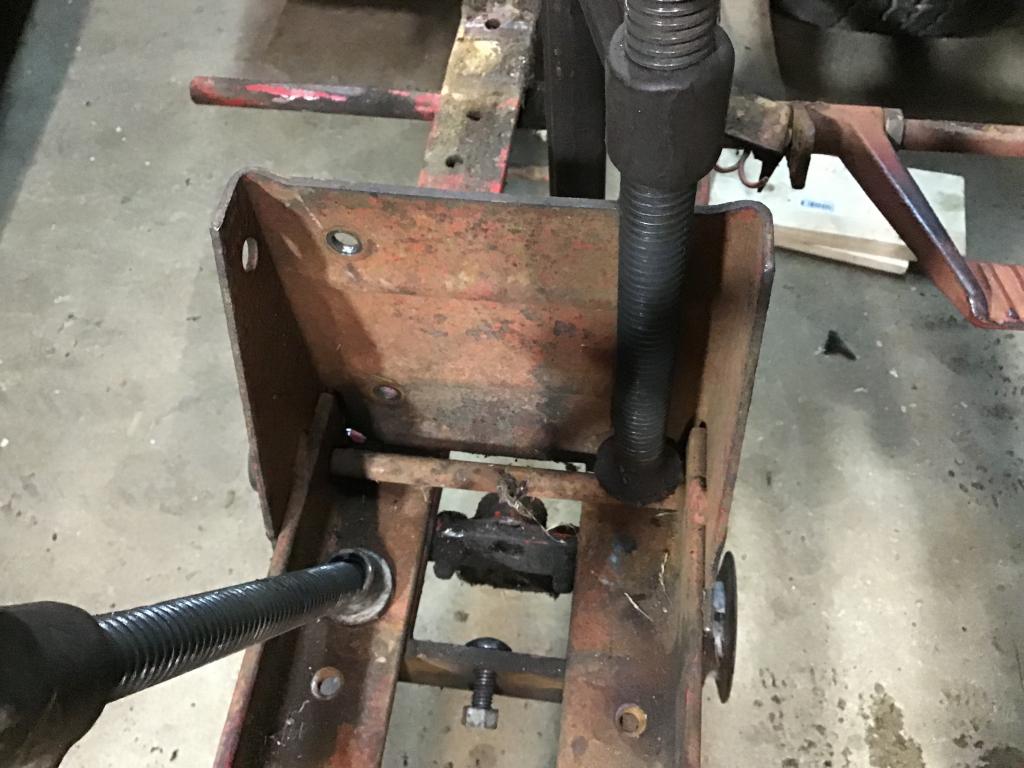

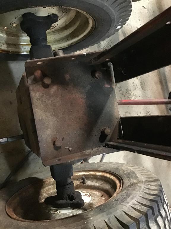

Pullstart 63,096 #1 Posted February 1, 2020 I noticed that this 502 and the Commando 800 frames had different transmission mounting plates. @hcminis DJ you mentioned the plate you had cut for the 1045 that was waiting to be welded in. Does the plate get placed over the stamped ribs, or do they need to be pounded flat, or was that plate meant for flat mounting plates like my 502? Note one frame is currently upside down... but a perfect place for a photo op! 1 Share this post Link to post Share on other sites

Pullstart 63,096 #4 Posted February 1, 2020 I guess in a way, I wasn’t looking for bracing suggestions, as much as the back full sized plate that DJ recently cut for his 1045.... in relation to sandwiching the big air gap stamped into the original plate? I believe he mentioned that his plate was cut from a Wheel Horse service advisory.... or whatever they were called. Share this post Link to post Share on other sites

hcminis 1,557 #13 Posted February 3, 2020 On 1/31/2020 at 9:35 PM, pullstart said: I noticed that this 502 and the Commando 800 frames had different transmission mounting plates. @hcminis DJ you mentioned the plate you had cut for the 1045 that was waiting to be welded in. Does the plate get placed over the stamped ribs, or do they need to be pounded flat, or was that plate meant for flat mounting plates like my 502? Note one frame is currently upside down... but a perfect place for a photo op! My frame does not have the stamped ribs. So the plate slid right down in and will be welded to the sides as well as top and bottom. I can laser cut more if needed. OR, could make the 2 separate pieces to go above and below the stamped ribs. Could even post a file/picture with dimensions if needed. 1 Share this post Link to post Share on other sites
Pullstart 63,096 #14 Posted February 3, 2020 3 minutes ago, hcminis said: My frame does not have the stamped ribs. So the plate slid right down in and will be welded to the sides as well as top and bottom. I can laser cut more if needed. OR, could make the 2 separate pieces to go above and below the stamped ribs. Could even post a file/picture with dimensions if needed. If you could put up your dimensions please, I should be able to cut a plate out. I was thinking too, maybe hacking the back off and building a 953/1054(/GT14?) style thick plate and calling it good. Share this post Link to post Share on other sites
hcminis 1,557 #15 Posted February 3, 2020 5 minutes ago, pullstart said: If you could put up your dimensions please, I should be able to cut a plate out. I was thinking too, maybe hacking the back off and building a 953/1054(/GT14?) style thick plate and calling it good. Here is the drawing. Let me know if you need anything else. 2 1 1 Share this post Link to post Share on other sites
