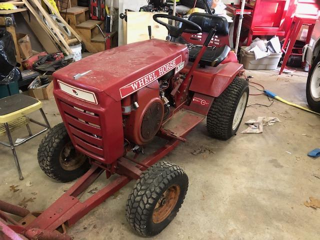

My fuel pump is currently leaking fuel down the block. Since there really isn't a point spending the money for factory pump im going to convert to electrical. I just rewired the whole tractor and now I'm debating where i want to pull power from. Part of me wants to hook a wire to the coil terminal and put a inline fuse in. Seems like the easiest way of powering as far as power with the key on. Anyone have any other thoughts? Pump will be a posiflow 1-2 psi.

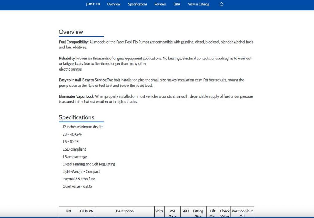

I was wrong about the current draw ...according to Facet posi-flo spec sheet they draw  only 1.5 amps.
If the power supplied by the I terminal you use for the pump fails...you have bigger problems ..meaning no spark.:P

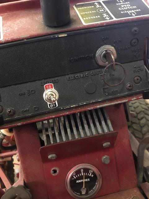

biged77
I temporarily wired the pump to the light circuit and disconnected the lights. This was several years ago, still that way.  Works for me, I don't mow at night. The light toggle switch stays on but could be turned off in an emergency.

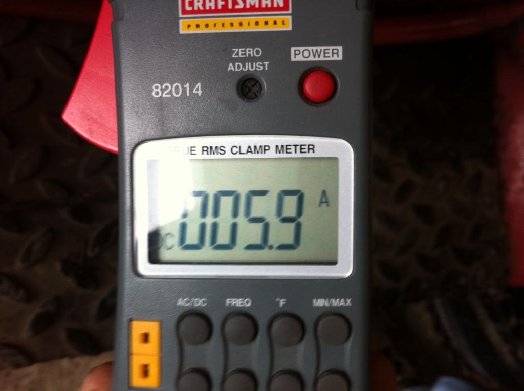

My Facet pump draws 5.9 amps when pumping fuel according to my meter. Your basic run of the mill lawnmower style ignition switch contacts aren't worth a hill of beans. I have no qualms about putting in a relay to power a continuous duty circuit for a pump. I deal with relays and contactors every day. You can get these relays for practically nothing at a u pull it auto salvage yard. And are simple to wire. If I ever have to install another electric, in goes a relay.
Edited by squonk
First let me just say I'm not trying to pit you two against each other. I quoted both just to get them in the same space to show the big difference between the two.
You've got me super curious to know how the difference is accounted for.
Different model numbers?
Possibly the amp rating Paul quoted is a  no load rating. I'm sure the distance the pump has to push the fuel, any filters and type that are in line and height it has to lift the fuel also factor in.My pump is a Napa 6101051 which is a Facet FEP04SV. The specs don't give me any amp rating.

Posi-flo pumps have a 3.5 amp internal fuse by their specs.  The head lights run through the ignition switch if you have regular sealed beam 35 watt x 2 used on 300 and 400 series...is almost 6 amps.... What ever makes you feelgood.  just saying after several years I haven't had any ignition switch problems.   \
Edit second pic from Facet manual
Edited by pfrederi
