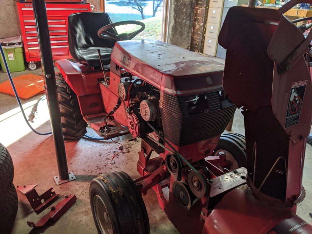

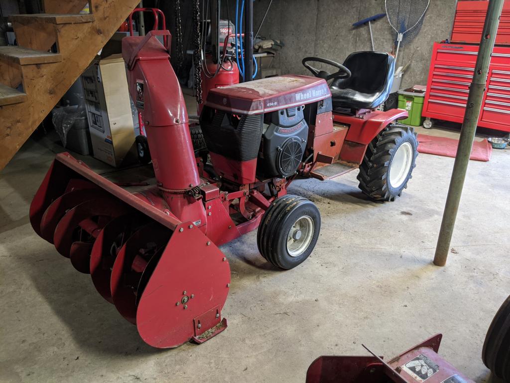

That was me I believe.  I was trying to put a wheel horse 44" 2-stage on a C-161 black hood...the odd ball black hood.  I ended up making it work but swapped out the dash tower and hood with a later 300/400/500 series to do so.

I had one on my black hood tractor for awhile, and yes the hood is in the way. I put a different hood on it while the blower was on. The hood was off a c120 and actually fit pretty well with the dash. It sloped down to the front of the tractor and gave it a hot rod look! Lol. Sorry I dont have any pics but it worked.
