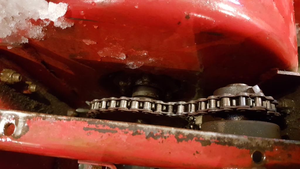

I'm hoping to get some help tonight for my 2 Stage snow blower on my 520-H.  I was out blowing snow tonight and noticed the blower was louder than normal.  The snow is REALLY wet and heavy so I thought that might be the reason.  I stopped and checked things out after a bit and after I took the cover off the top I realized the chain was VERY loose.  It looks even worse in person than it does in the picture.   Some of the rollers even look separated, has anyone ever seen that?  Do you think it's just a worn chain or do you think I have something else going on? So, I have a few questions.
1.)  What size of chain is it?
2.)  Has anyone replaced this on their blower?  if so...
3.)  Does anyone have any advice on doing this?
4.)  Does the blower need to come off the tractor?
Any other pertinent information would be GREATLY appreciated.  I'd like to tackle this tomorrow when I get home from work if possible as they are calling for more snow tonight/tomorow.

The chain size is #40 roller chain. It definitely should be replaced. You can buy a 10ft length at Tractor Supply if you have one close by. You will have to shorten the chain.
There should be a tensioner under the chain. The first models used a wood block but that was then upgraded to a nylon block. it's held by a metal bracket. Some of us go farther and use an idler sprocket.
Mine had a worn chain. Then kept destroying chains and they looked like yours. Finally got a good look at it to find out what was going wrong and the small sprocket was also worn. The sprocket teeth looked like shark fins and would push the chain out of the grooves because of the curve on the teeth..
wallfish
You don't need to remove the blower to change the chain
Find the master link on chain. It will be the only one with a clip on the outside of that link. Remove the clip, then you can remove the master link which separates the chain.
Count the links in the old chain, now count the links in the new chain and mark it. You'll need to grind off the rivet holding the chain links to separate the links to the new length.
Loop the new chain on to the sprockets with one end on the small sprocket. This will help hold the chain and line it up for installing the new master link. The new chain will come with one master link but they are cheap so buy a bag of 2 or 3 while you are there buying the chain.
Look for the tensioner pieces when you have the old chain off. you should easily be able to see it or at minimum the bracket should still be there.

It is best to replace worn sprockets when fitting a new chain.  It appears that you haven’t used much chain oil, I apply oil after every use.  Special chain oil in a spray can is convenient or use bar & chain oil for a chainsaw.  Keep the chain adjusted with a new adjuster block, they wear rather fast.

All great advise given above :handgestures-thumbupright:. One more important note of advise. When you install the connector link clip, the open end of it should face away from the direction of rotation.

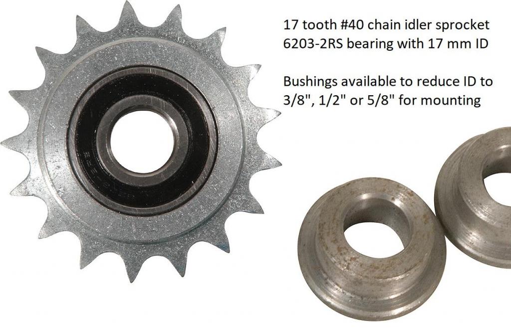

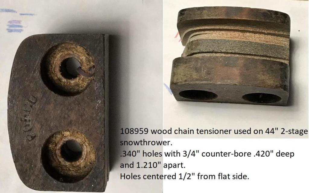

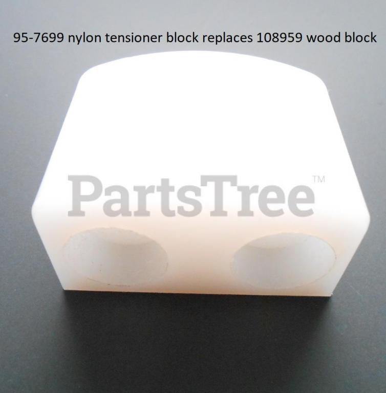

Here's what the tension blocks looked like... As well as an idler sprocket for upgrade...
