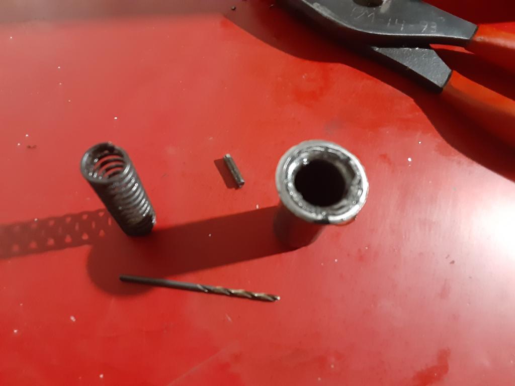

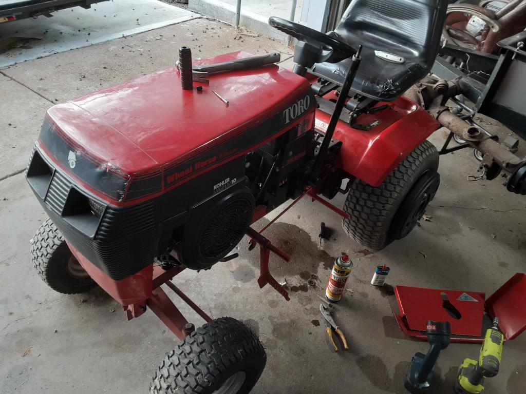

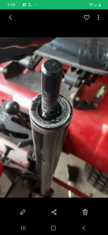

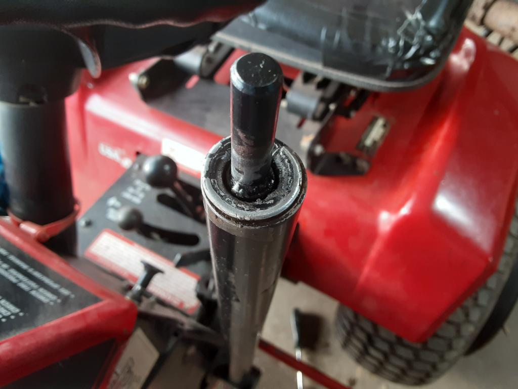

kdb50ss 4 #10 Posted January 15, 2020 Thanks I just ordered two of them. here are a few pics. I may need the retainer also. Share this post Link to post Share on other sites
kdb50ss 4 #11 Posted January 15, 2020 I used the drill bit to drive out the roll pin. Thanks everyone for the "welcomes" 1 Share this post Link to post Share on other sites

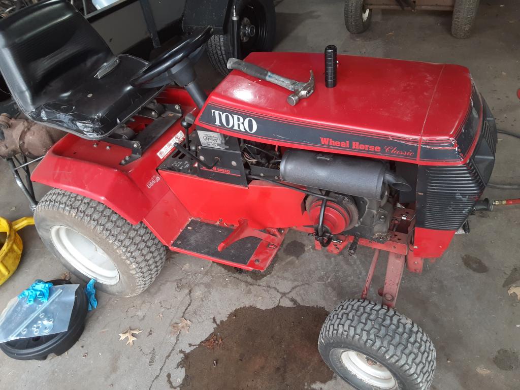

kdb50ss 4 #12 Posted January 15, 2020 Here is my new tractor, my dad , whose 75 years old, has one but his is a 1988, this one is a 93, both 310-8s My 93 has 700 hrs and seems to be in great shape. Bought it with two nice mower decks and a orginal 42 inch snow plow. Just bought some wheel weights from Amazon and found a nice dump car. 1 2 Share this post Link to post Share on other sites
