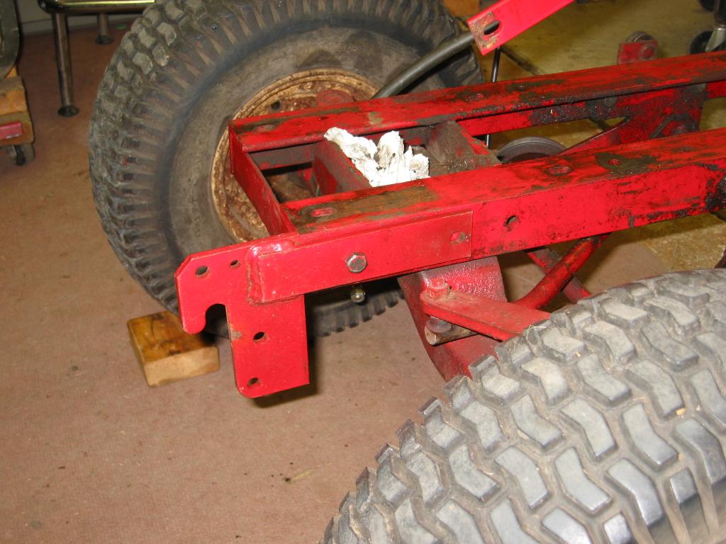

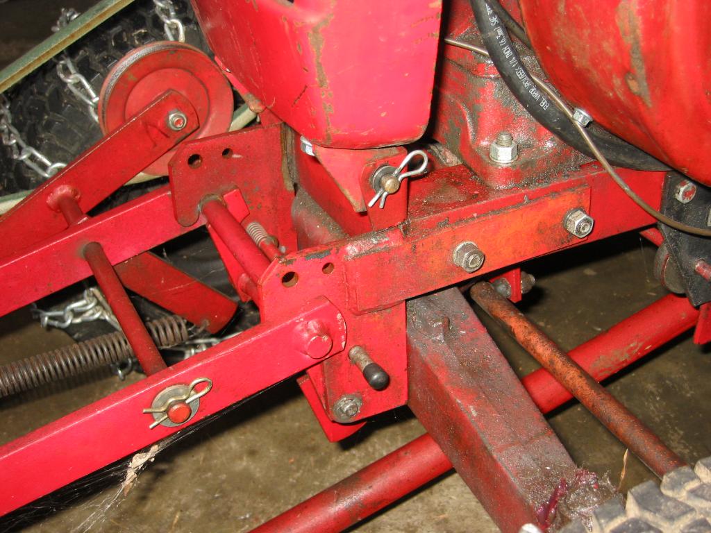

pfrederi
There was an adapter to hold a front mule drive older horses.  I put it up against my GT14.  You would have to drill another hole in the frame but the big problem is you r frame is wider than regular horses it would require some fab skill to mount the narrower mule drive.  Lift and leveling are another issue.  First pic is on GT14 second is the adapter on a Charger.

FatJackDurham
pfrederi, what lift and leveling issues do you think he is likely to have? clearance? I do feel that the GT 14 seems lower.
