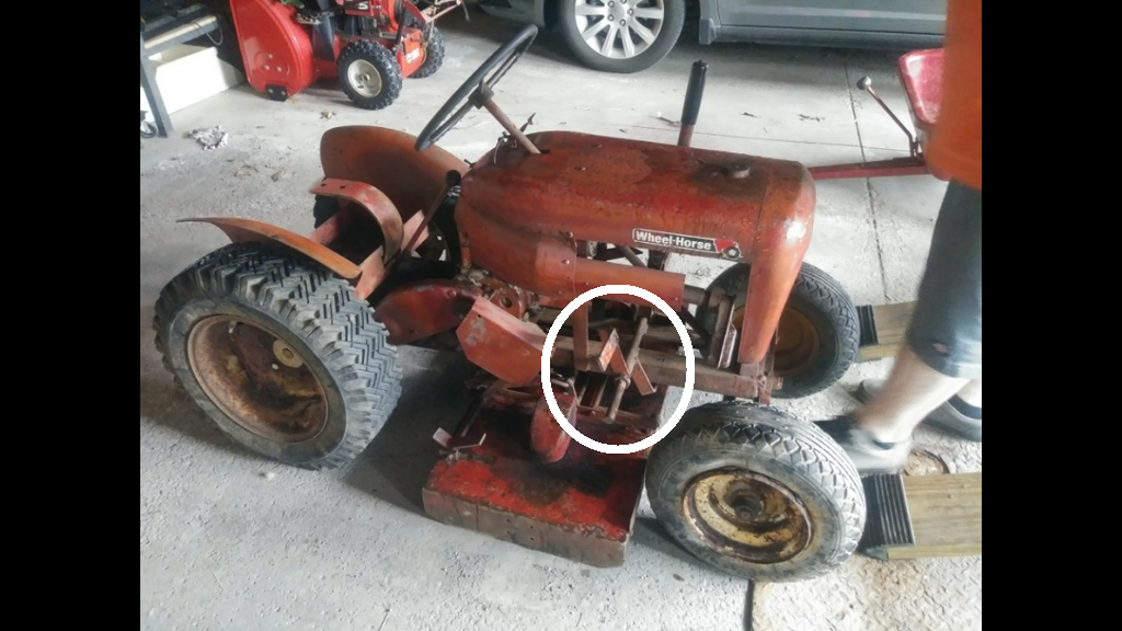

Oldskool 6,660 #151 Posted January 26, 2020 I have a snow/dozer blade but apparently I am missing the pedal and linkage/s circled in this pic. Any info and close up pics would help. Thanks Share this post Link to post Share on other sites
wallfish 17,391 #152 Posted January 26, 2020 The blade that pedal is for is a Suburban Blade, so you'll need the special RJ adapter bracket which connects it to the tractor if you don't already have it. It's a factory bracket made for adapting the blade to the RJ and it hangs under the frame. The only thing that pedal does is pull on a chain to release a pin so the blade can index left and right. A small rope is used to pull the blade left and right. It's old skool technology for sure. I have posted measurements for that pedal before, can't remember if I still have one or not. The blade pictured earlier in this thread is the RJ blade and doesn't use that pedal. Share this post Link to post Share on other sites

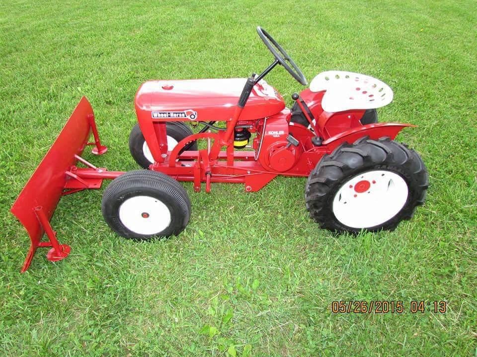

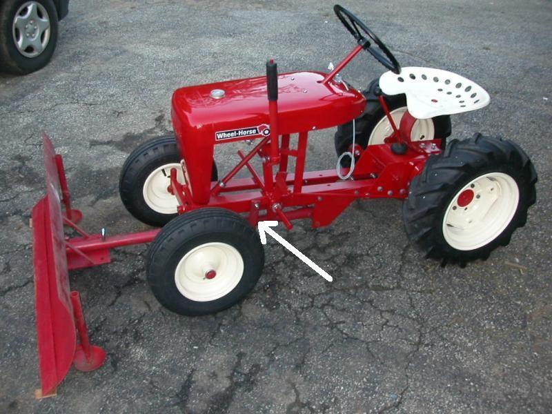

Oldskool 6,660 #153 Posted January 27, 2020 @wallfish My blade looks like this one with the same 2 plate mounts to the frame but thats all I have. What makes it go up and down? Share this post Link to post Share on other sites
wallfish 17,391 #154 Posted January 27, 2020 That's the correct RJ blade. A solid link with 2 holes, it's connected to the lift with bolts. Post a pic of the blade and it's frame 1 Share this post Link to post Share on other sites
Oldskool 6,660 #155 Posted January 27, 2020 @wallfish I will get some pics of it tomorrow. Also I was wondering about a mowing deck. What year range would be correct? I found one that may be right but not sure and I don't have a pic of that either. One of the 90degree drives looks like a 2" pipe fitting. Sound rite? Share this post Link to post Share on other sites
wallfish 17,391 #156 Posted January 27, 2020 (edited) The one you pictured above about the pedal is correct. An RJ deck will have the deck engagement pedal right on the deck and have no wheels. You can see that on the lower left of the deck shell in the pic above. Pic also shows the correct belt guard for the deck. If you're after attachments, look for a CBR-32 Sickle bar, those are a cool attachment. You should go down to the big WH show in PA this coming June. You can find any and everything you want plus the stuff you didn't know you needed until you see it. Great show, great people, great time, guaranteed Edited January 27, 2020 by wallfish 1 Share this post Link to post Share on other sites

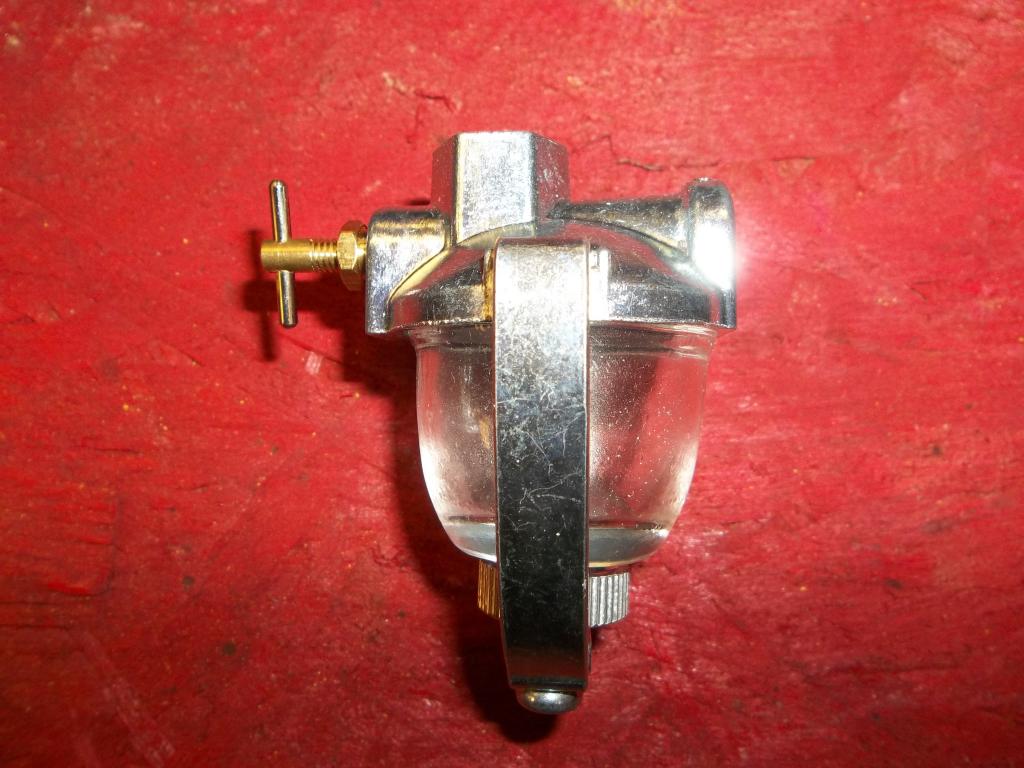

Oldskool 6,660 #171 Posted February 7, 2020 I am having sediment bowl issues on the RJ. I can't seem to come up with parts to rebuild mine or a correct replacement. Can someone point me in the right direction? Share this post Link to post Share on other sites
wallfish 17,391 #172 Posted February 7, 2020 you can buy a new one http://www.psep.biz/store/small_engine_fuel_filters.htm 1 Share this post Link to post Share on other sites
Oldskool 6,660 #173 Posted February 7, 2020 1 hour ago, wallfish said: you can buy a new one http://www.psep.biz/store/small_engine_fuel_filters.htm Ordered and on its way. Thank you @wallfish. Now maybe I can start driving this thing around without draining the tank when I'm done lol Share this post Link to post Share on other sites
Oldskool 6,660 #174 Posted February 13, 2020 The sediment bowl showed up. So maybe the RJ will be a little more trouble free 2 Share this post Link to post Share on other sites
