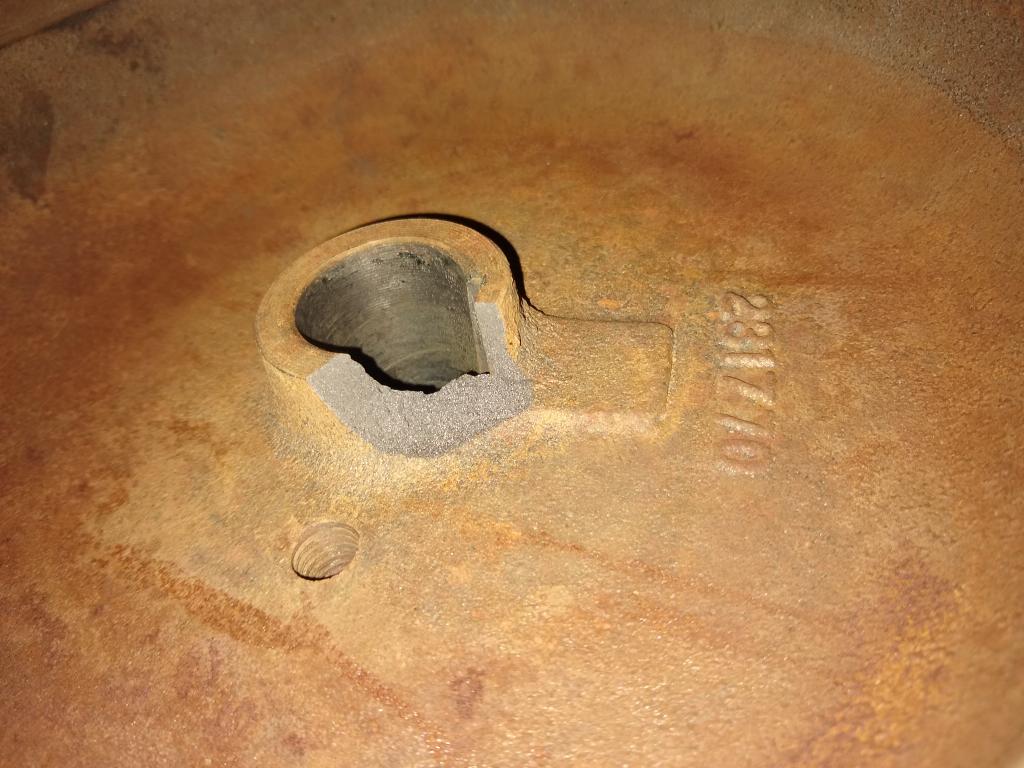

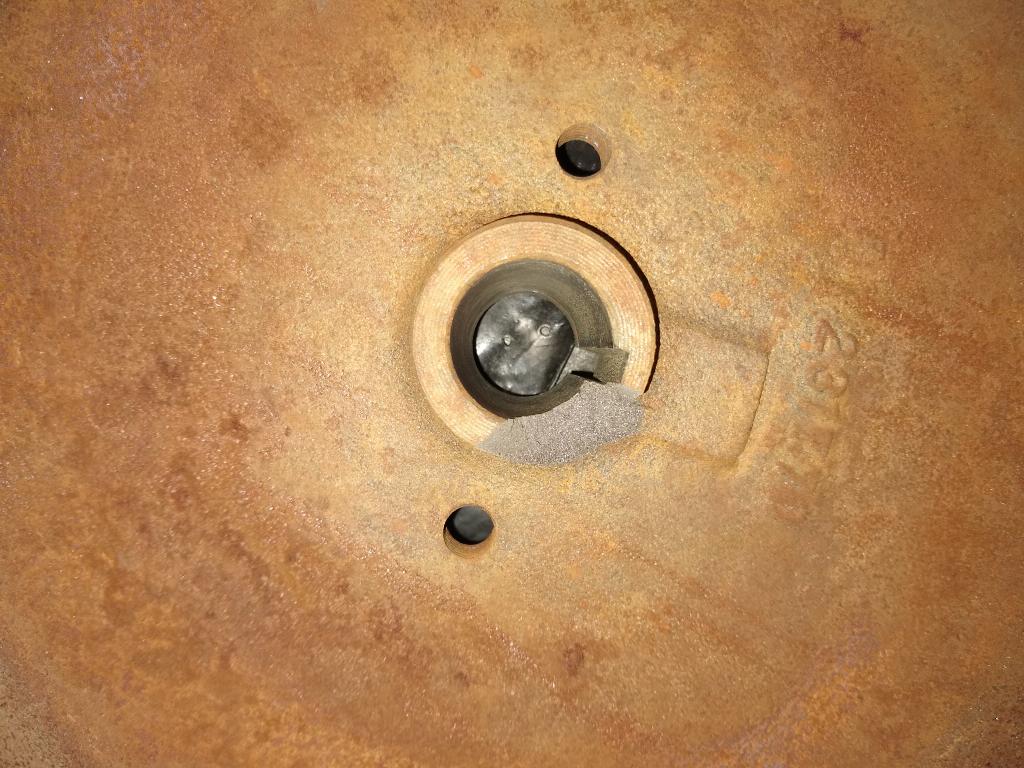

Psychonova68 36 #1 Posted January 7, 2020 I threw a rod on my commando 8 a little while ago and just picked up the engine from the machine shop today. Upon inspecting the flyweel (which they didn't reinstall), I noticed that a chunk was broken off of the back that butts up to the keyway. Can I use this still, if not should I just find another k181 flywheel? Do any of the other Kohler engines use the same flywheel? Share this post Link to post Share on other sites
adsm08 2,366 #2 Posted January 7, 2020 I'd be very wary of using that. I've seen smaller chunks throw bigger engines out of balance. Share this post Link to post Share on other sites

Achto 28,146 #5 Posted January 7, 2020 5 minutes ago, Psychonova68 said: Also can I strip the magnets out of the flywheel from a newer k181 and use that. If you strip the magnets out of a flywheel you will severely effect the balance of the flywheel. An out of balance flywheel will cause vibration and will most likely damage the main bearings in a short amount of time. Share this post Link to post Share on other sites
The Tuul Crib 7,338 #6 Posted January 7, 2020 That broken fly will definitely thro an engine out of balance I agree with above get another fly wheel and have a greater peace of mind . to Share this post Link to post Share on other sites
JAinVA 4,629 #7 Posted January 7, 2020 I agree that you should not use that flywheel. Years ago I had a c120 that had several cooling fins broke off.I talked to the dealer about a replacement and he said that with a ball bearing supported crank he would just knock off the opposite fins and run what I had.I did and never had any balance issues. 1 Share this post Link to post Share on other sites

JoeM 7,883 #12 Posted January 7, 2020 That cracked key area just might be the tip of the iceberg. Being so close to center, i doubt if it would throw the balance off much, but the most importation thing is shock when the rod broke. What sometimes happens when a rod breaks is there is a sudden stop. The energy in the flywheel wants it to stay in motion, hence sheared key and or key-way. There might be other cracks not visible and when you torque the nut on they just might show up or even worse show up after you run it a while and destroy the end of the crank. If this was some old smoker that didn't matter much, then the juice might be worth the squeeze, but in your case, you said this thing was at the shop and you got to have some nice cash invested.....buy a replacement flywheel. Share this post Link to post Share on other sites
