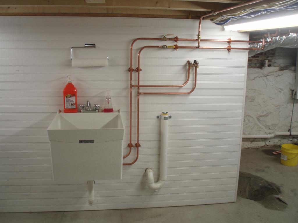

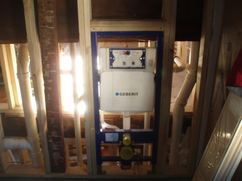

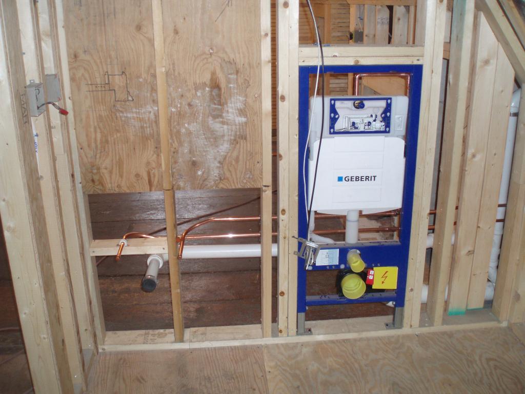

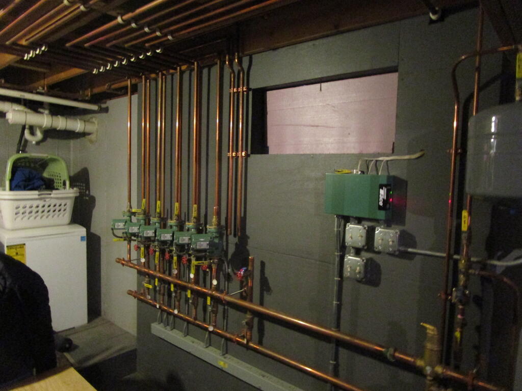

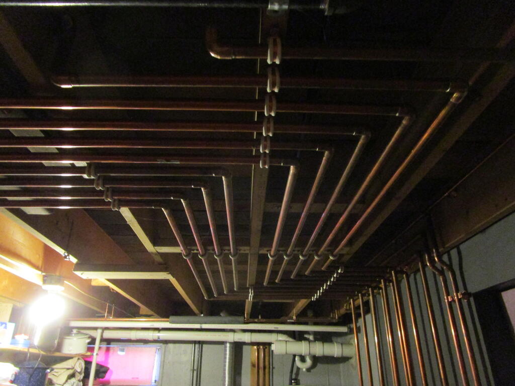

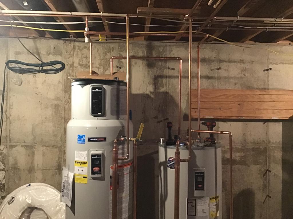

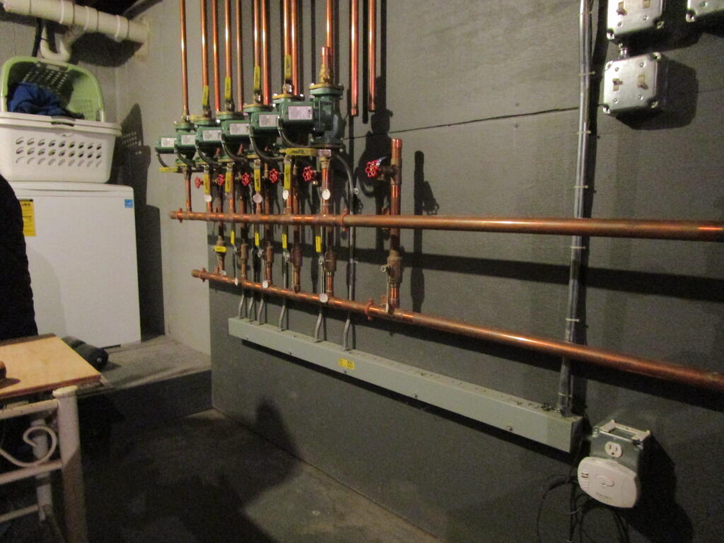

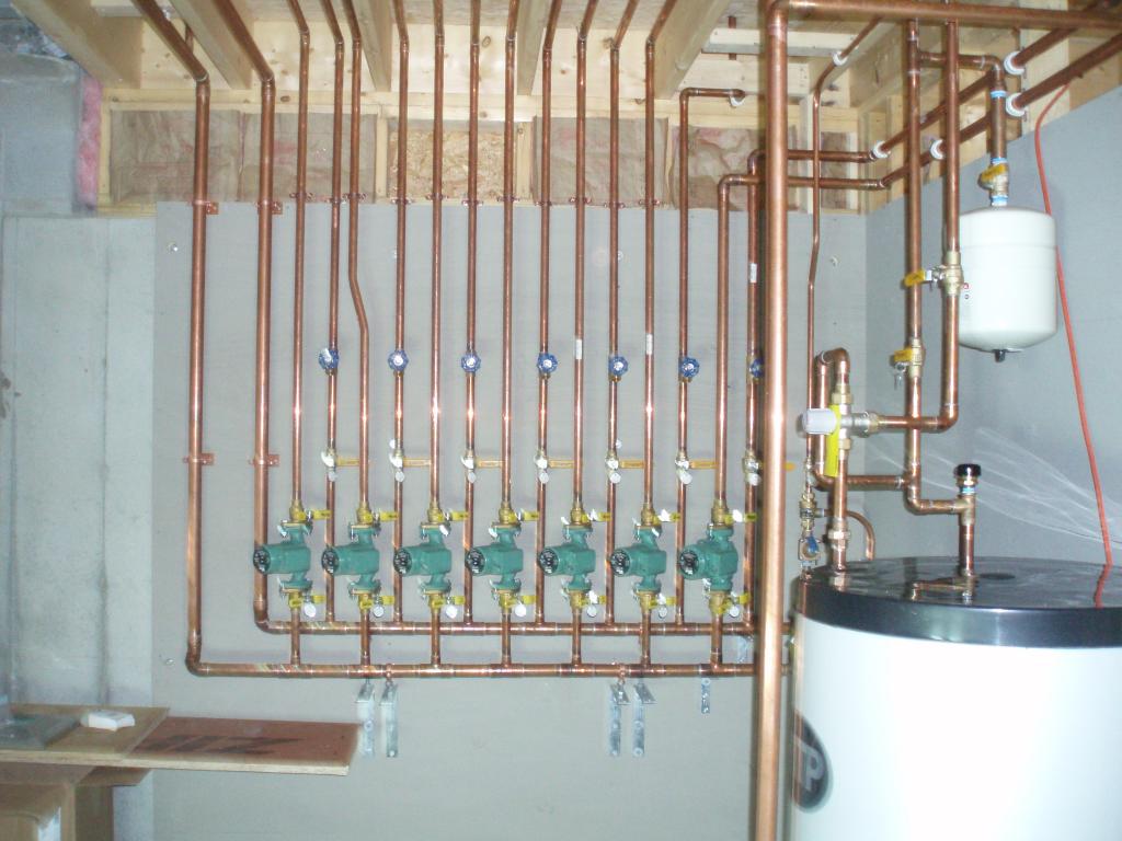

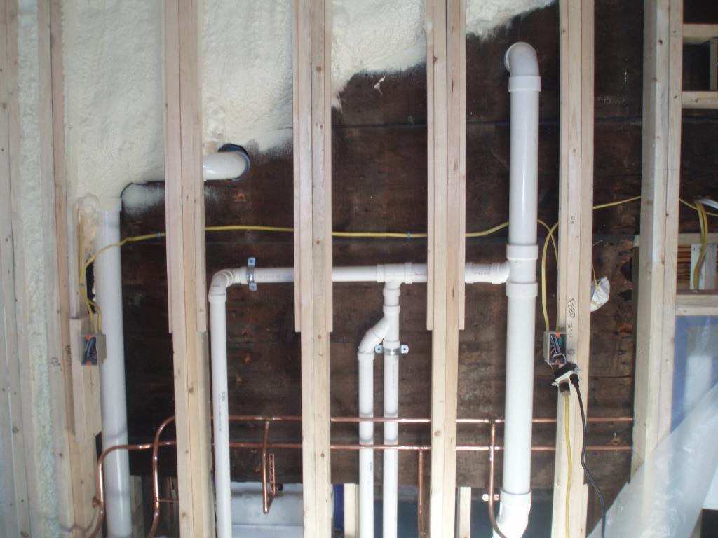

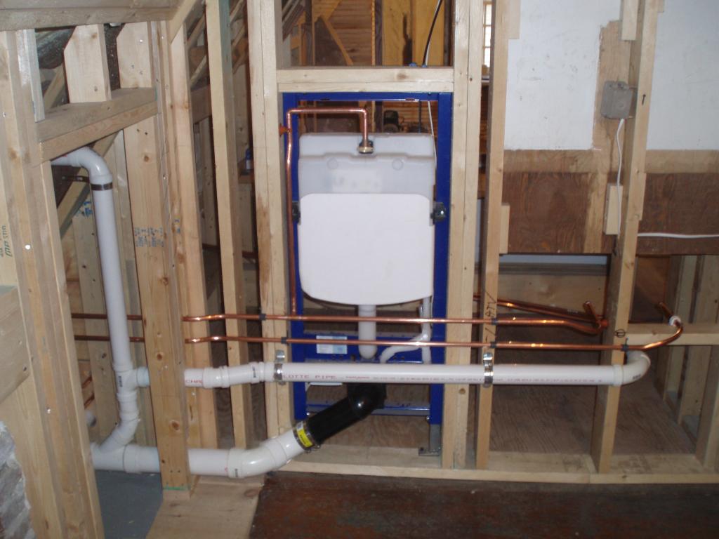

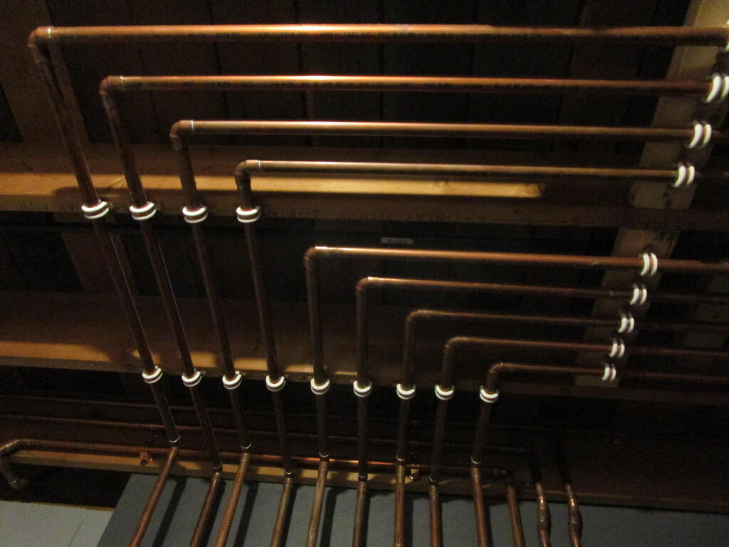

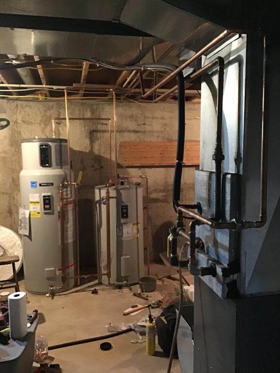

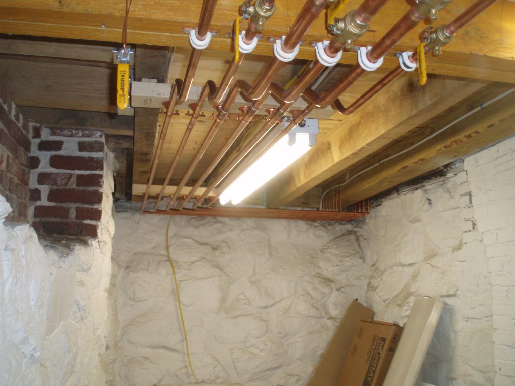

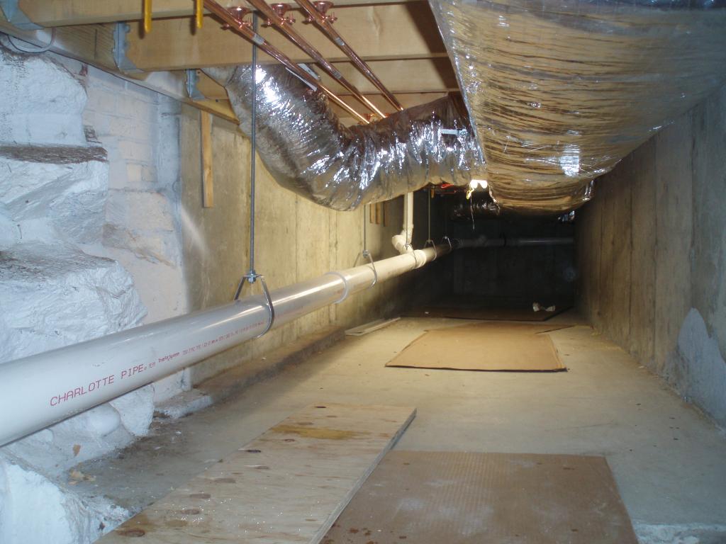

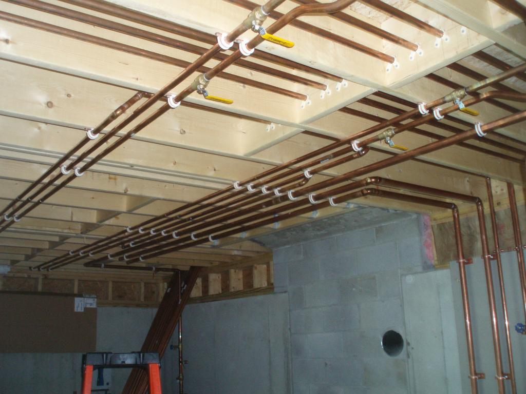

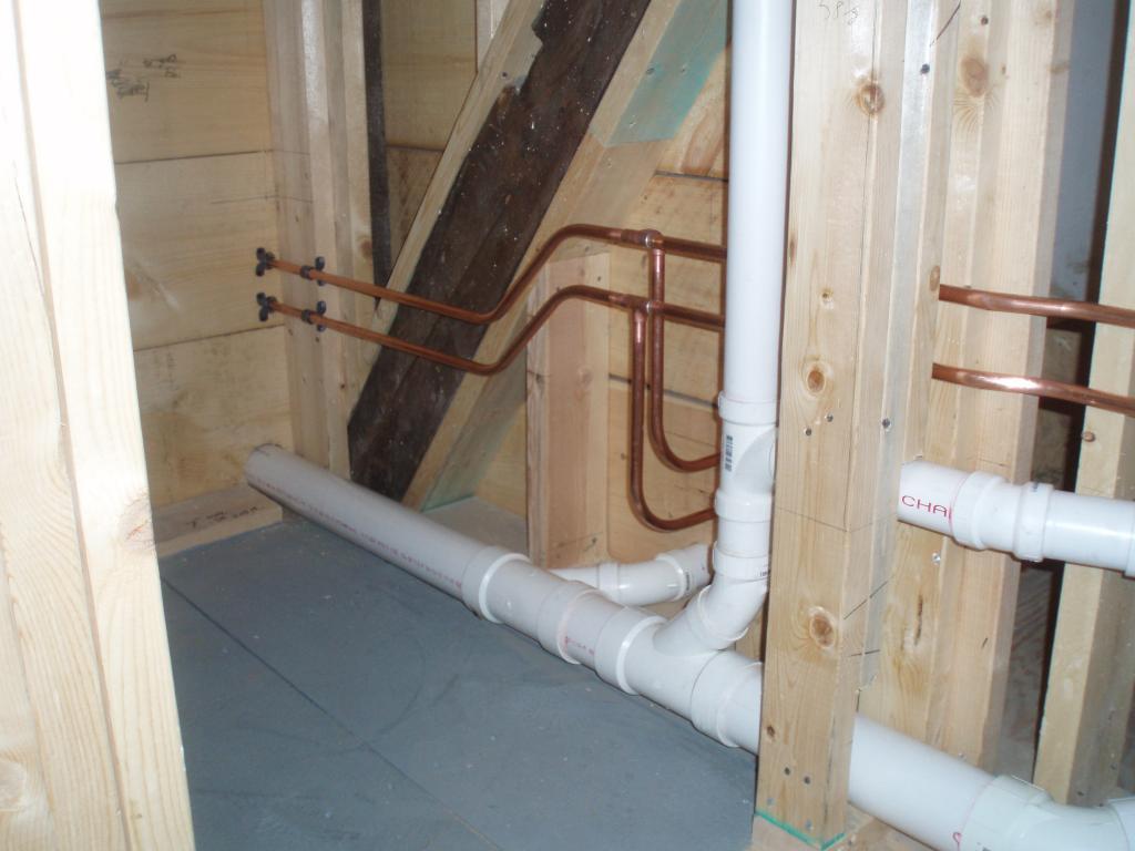

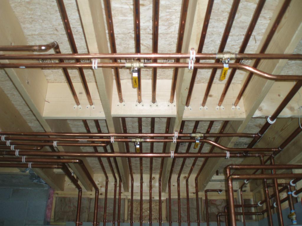

JCM 11,400 #1 Posted January 3, 2020 Back on April 1 2019 @formariz under the heading of Secret Room showed us what a Craftsman is capable of when he puts all his knowledge into a project after many years of an apprenticeship then to a journeyman and finally a master of his craft. It takes a certain mindset and determination and often makes you wonder why someone really has to be that fussy,the answer is because we were taught to do a job to the best of our ability so it would stand the test of time and maybe someone would pass on a good recommendation for us so we may be able to support ourselves and family and to have some nice creature comforts while we are on Earth. A big thank you to all the Master Craftsmen who came before us and passed those Trade Secrets to us. I recently found a few old SD cards with more Trade pics and thought I would share them. These are from 2 different jobs 1 Plumbing and 1 Heating back in 2014 and 2016. Note on the Heating job the boiler is not yet installed just the Supply & Returns etc. 3 6 2 Share this post Link to post Share on other sites
Stepney 2,356 #2 Posted January 3, 2020 Beautiful work, Jim! My father was a journeyman himself. Our basement looks quite similar. 1 Share this post Link to post Share on other sites
dclarke 4,274 #3 Posted January 3, 2020 You can sure tell you take pride in your work. Very well done, Jim! 1 Share this post Link to post Share on other sites
Pullstart 71,121 #4 Posted January 3, 2020 Wow, so cool! What type of copper tubing do you use to keep the straight sections straight yet allow a good bend without kinking? Also, do you work as a single guy on the job, or do you haul an apprentice along with you for cuts, holds, etc? My simple plumbing jobs are preferably out of copper, whenever possible. Why? Pride in my work? Art? Money burning a hole in my pocket? I have no clue. 1 Share this post Link to post Share on other sites
JCM 11,400 #5 Posted January 3, 2020 (edited) @pullstart Type L copper with a 40 plus year old Holsclaw gear bender . Both of those jobs were done by myself, don't think I will be doing to many more of those, way to much work alone. I still run across where some people still want copper tube water piping and I for the most part prefer it that way but give them the PEX option. You do pretty good work there yourself my friend. That copper is hard drawn in 10' lengths. Edited January 4, 2020 by JCM 1 1 Share this post Link to post Share on other sites
ZXT 2,402 #6 Posted January 4, 2020 4 hours ago, JCM said: @pullstart Type L copper with a 40 plus year old Holsclaw gear bender . Both of those jobs were done by myself, don't think I will be doing to many more of those, way to much work alone. I still run across where some people still want copper tube water piping and I for the most part prefer it that way but give them the PEX option. You do pretty good work there yourself my friend. That copper is hard drawn in 10' lengths. Definitely some nice looking work. I personally prefer Pex. Nobody is going to break in and steal Pex. Copper is a different story. Sure, it doesn't look as neat, but it's plumbing and 99.9% of people will never look at it or care. Same goes with electrical piping. I try to be neat with my work up to a point. If it's something that's going to be visible, I make an extra effort to make EMT as close to perfect as I can manage, but if it's something that's going to be hidden in a wall, It's not nearly as critical. 1 Share this post Link to post Share on other sites
rmaynard 17,540 #7 Posted January 4, 2020 Because most of my plumbing work is done in an "improvement" environment, there is little or no room for natural bends, and therefore the use of sweated-in elbows and other fittings is a necessity. Having said that, the pictured work is a testament to what can be done when a pro plies his skills. Beautiful work. 1 1 Share this post Link to post Share on other sites

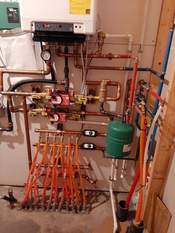

WHX?? 57,821 #12 Posted January 4, 2020 I'll have to see if I can dig up some pics of my infloor jobs. Trouble is when I was a installer we didn't have phone cameras and now that I am mostly a desk jockey don't get out in the trenches much unless it's side jobs to support my horse habit! Wished I had pics of some of my old sheet metal work. I am not allowed at the sheet metal tables anymore ... too many blood stains! Here is a recent one I did. A Triangle Tube Challenger combi running 3000 sq ft of infloor with domestic. You don't see type L bent like that around here Jim altho some of my guys do a wicked job on soft drawn ... thanks! 2 1 Share this post Link to post Share on other sites
JCM 11,400 #13 Posted January 5, 2020 @WHX24 Triangle Tube, top notch boiler, I am so old school you would laugh if you saw my phone, still on the digital camera. I never liked sheet metal all that much, cut the end of my pinkey finger off cutting a 10'' piece of smoke pipe with a pair of milwaukee shears and had to have a plastic surgeon sow it back on with a stainless steel pin inserted, The tubing bender is not a real common tool anymore and kind of a lost art in the trade, but not with me , I still enjoy using it as often as possible, almost like pouring horizontal lead and oakum joints, just hate to give it up. 2 Share this post Link to post Share on other sites
WHX?? 57,821 #14 Posted January 5, 2020 Yes all I have ever used is TT Jim ... very few issues when done right and the only mod con I will stock parts for. Mod cons these days are like butt holes... everyone's got one and most of them stink! Oakum cast joints!?!?!... you are old skool! I get it tho with PEX, manablocs, press fittings and new fangled plastic refrigerant lines. Plungers & tin knockers have to stay competitive and nowadays time is truly money. After all low bid means wondering what you left out ya know! We have this lake by us, Green Lake WI, Google it, the high end fibs from Chi town flock to it like flies around $h/% and put up multi million dollar homes but they would rather have eye candy like @formariz has to offer, no offense Cas, and end up going with a two bit HVAC system then when it doesn't satisfy them. Quoting Mr Rodgers..... can you spell retirement.... sure I knew you could! 2 Share this post Link to post Share on other sites

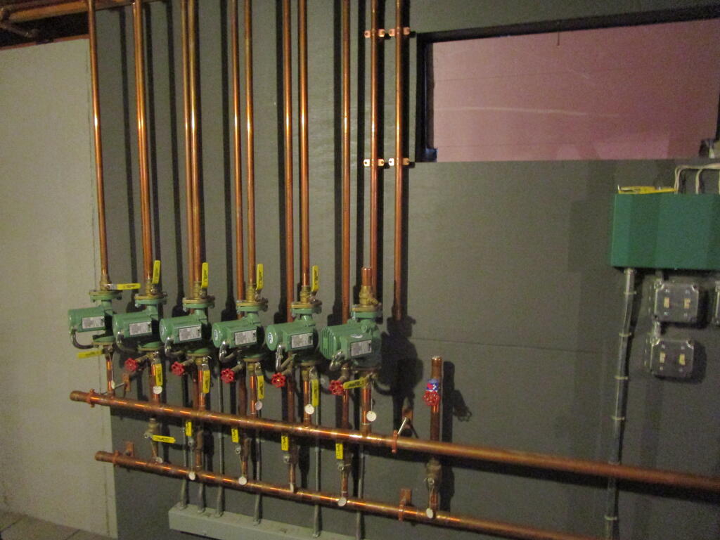

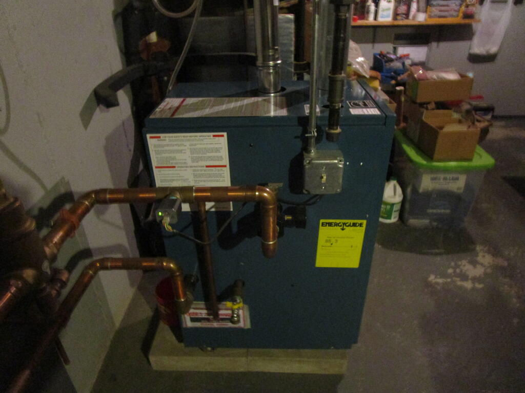

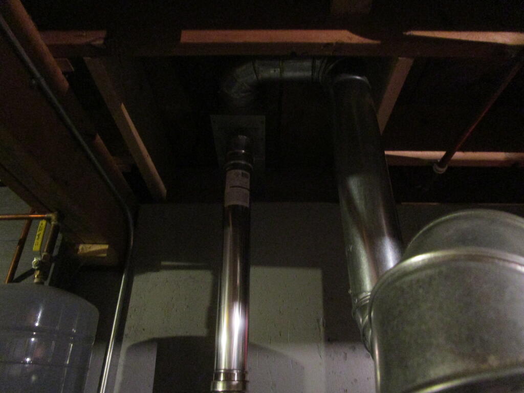

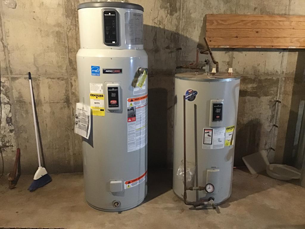

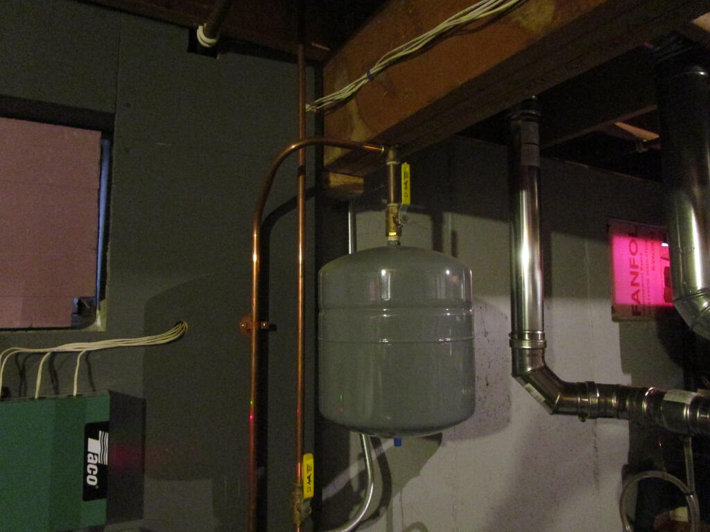

JCM 11,400 #19 Posted March 7, 2021 This mornings small project was to clean up and vacuum the area around the Boiler. This was installed 10 years ago to replace the original oil fired boiler that was at the other end of the basement. I was looking to upgrade the system to LP so as to change the appliances from electric to LP as well and remove the 275 gallon oil tank. Do any of you who work in the trades ever have a project that you either have not 100% finished and or never started in your own home that is related to your trade. If you look at the right hand side of the row of circulators there is one that is not connected, that will someday hopefully go to an HTP/ Super Stor 40 or 60 gallon indirect hot water heater. As well behind that there are 2 - 3/4'' copper lines , a hot and cold for domestic water to tank. I can't take credit for the wiring job that was done by a childhood friend and neighbor. These pics were taken this morning as I never had any for this project. Have a great Sunday all. 2 Share this post Link to post Share on other sites
Handy Don 17,337 #20 Posted March 7, 2021 Five active zones! Not my trade, but still have a sealed off 8" duct on my return air plenum that I intended to connect to a fresh air inlet--37 years ago. 2 Share this post Link to post Share on other sites

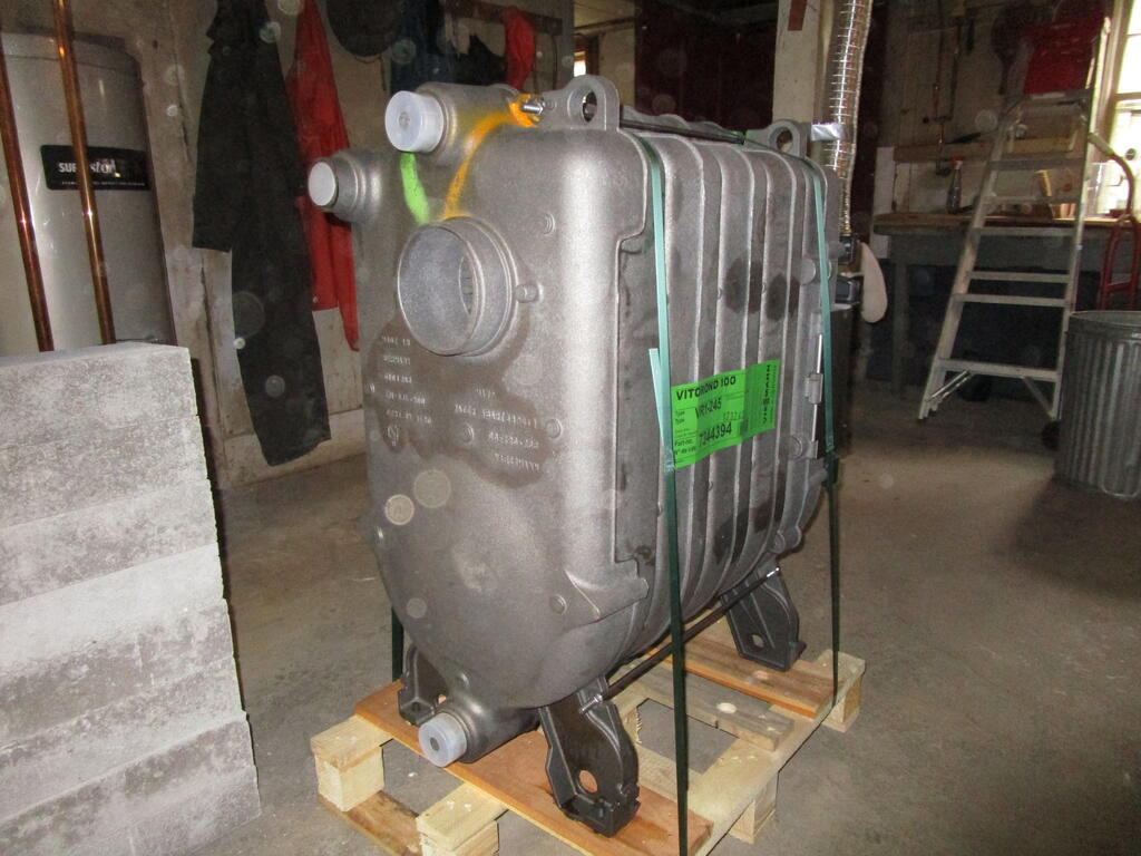

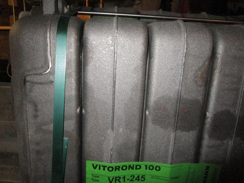

JCM 11,400 #21 Posted April 17, 2021 This past Thursdays project was to get this in the basement and all associated trim/ parts and pieces for a heating system replacement for a very good and 20 plus year customer. We had to travel 70' plus over pea stone with this 635 lb Cast Iron block using 2 full sheets and 1 half sheet of plywood as a base for the pallet jack and hand truck. The driver was great, usually tailgate delivery with most Company's when they see what it would take to get it close to the cellar entrance with something of this weight and condition of the route with its turns and base. Also had help with a good friend of mine assisting. This is the first Viessmann oil fired boiler I have installed but have used their Gas boilers. This brand was recommended by the customer. I was impressed with the smoothness of the cast iron as compared to American made boilers. This unit will be supplying heat to 28 cast iron radiators and an 80 gallon HTP super stor indirect H/W tank supplying 4 1/2 baths, kitchen with pantry sink and laundry room. Should be a nice project and will be done in stages as not to disrupt heat or hot water for the owner. Will post some pictures as progress goes forward. 3 Share this post Link to post Share on other sites
Handy Don 17,337 #22 Posted December 12, 2021 Impressive chunk of equipment to be moving around. Will this thing have an insulated jacket around it once it's all connected? 1 Share this post Link to post Share on other sites
JCM 11,400 #23 Posted December 13, 2021 Yes Don it does. I will get some pics on here eventually. I still have phase 2 of the project to start. It involves separating 28 cast iron radiators into 4 zones which at present there are only 2 thermostats that are both on the first floor.Old 1800's very large home. Good mid winter project . @Handy Don 1 Share this post Link to post Share on other sites
WHX?? 57,821 #24 Posted December 13, 2021 That block reminds me of one commercial job I did once Plunge. All the sections were shipped loose so I had to press them together on site with rented HY presses from the disrributer. Big honkin Burnhams with gas power burners that were going to run at 60 psi due to the 10 stories of the building. I'm sure was worried about gettin them push nipples to seat without leaking. Oil??? Yah i know oil is still a big thing in your neck of the woods but better you than me! Couldn't talk the customer into a couple of cascaded mod cons? 1 Share this post Link to post Share on other sites
JCM 11,400 #25 Posted December 13, 2021 My customer asked for a Viessmann. His golfing buddy had one installed in his home and recommended that. I purchased the iron with a riello burner. Hope to finish that project up now that everything is valved off and labeled. May wait until Spring. Nice that the way I set it up no more bleeding the air out of 28 radiators. @WHX?? 2 Share this post Link to post Share on other sites
