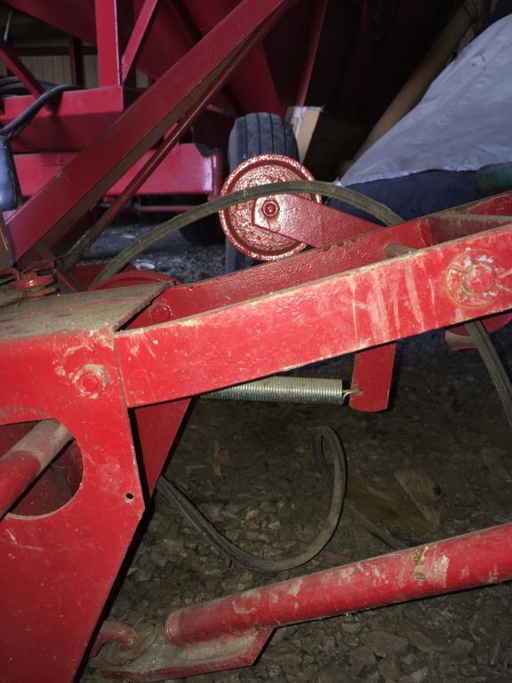

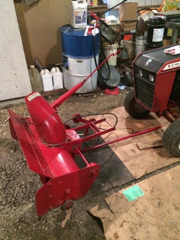

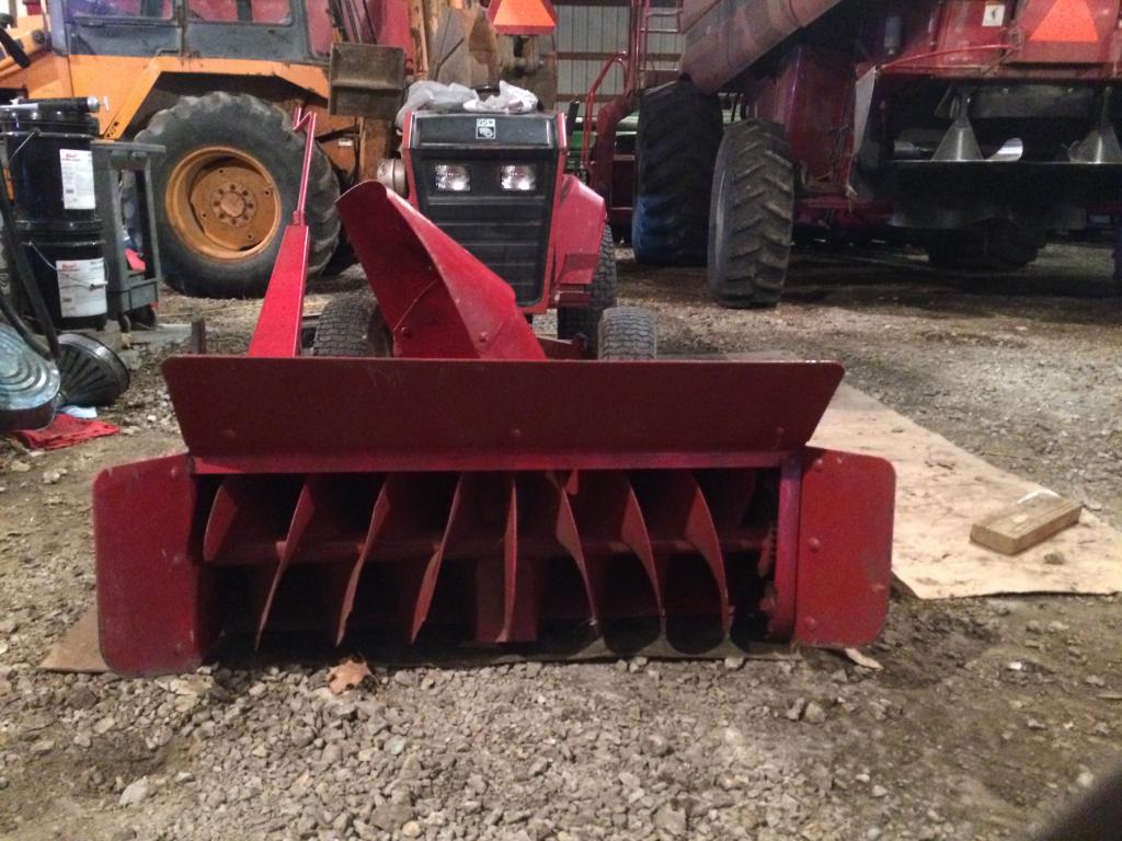

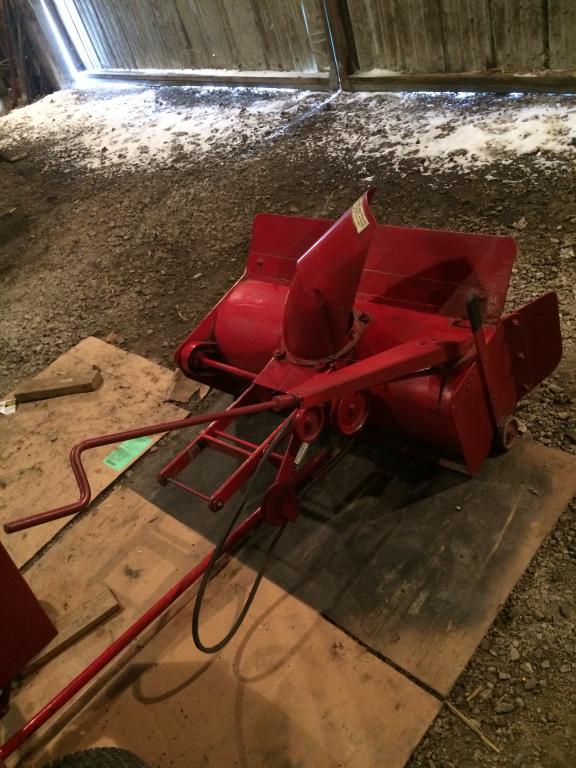

I was given this snowblower as a wedding gift for my 1980 C-105, a buddy of mine bought it used from someone who said they used it on a 312-8. I heard the attach-o-matic was from about 1973-2007. When I tried putting it on, it seemed to long. I could not lift it up. Does it look to long to anyone like something was added? Or maybe it is operator error and I am doing something wrong. If it's for another Wheel Horse please let me know. I have no markings for a model number or serial number anywhere. If you can see these pictures let me know your great wisdom, I am new to the Wheel Horse family. 848600962_Snowblower1.JPG.09acaa47a8e926a3a16aa3e267b020b9.JPG1814040644_Snowblower2.JPG.5a9848c7bf523d297dcb2543ce38d322.JPG339357477_Snowblower3.JPG.cefc8c91faeef8075784c0f6053a16f2.JPG

That blower should fit.     I can't see from the photo...do you have a front attach-a-matic mount?     I also do not see the "flag: that is required for lift to work properly.

On a closer look, that blower appears to have the frame mount kit.   It would not use the attach-a-matic, but would bolt to two holes in your frame rails.

You seem to be getting mixed messages here and Ed's closer look is correct.. The blower has not been modified.
That blower is a pre 1973, made before the Tach-A-Matic was standard equipment. That blower is designed to attach directly to the frame through the front 2 holes in the frame rails. That's why there's a long 3/8" bolt which can be removed.
A newer style blower which attaches via the tach a matic (like Peter's) has a 5/8" thick bar and that bar is welded to the blower frame.
Your C-105 is post 1973 and came factory with the tach a matic on the front of the frame. The tach a matic is too wide to allow for the blower you have to mount directly to the frame as it was designed.

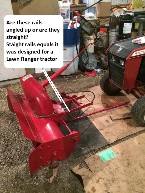

It appears from the pic, the blower frame rails are straight and not angled up although it's difficult to tell from the pics. Straight rails were designed for use on a Lawn Ranger which is a smaller tractor and lower to the ground, hence the straight frame rails. The same exact blower with bent rails gets the mounting point a little higher up for attaching to the bigger garden tractors.
With all that being said, you can still get that blower to work on that tractor.

You can easily make that fit if you have some 5/8" round bar and a means of making two 5/8" holes in the flat bars. Would have to get you a measurement for hole location. The round bar can be held in the frame with cotter pins.
Here is how the models went. Yours is 1972 and older. Included a couple more years to show the bolted on housing extensions that make the 37" thrower a 42". Following this period the plates have a short return broken at the front of the plate so the wings don't pull you into the snowbank quite as bad.

John, wouldn't that blower work as is if the attach-a-matic were removed?

Yes it should. The holes in the frame are still there. Do some tractors use the tach a matic to hold the axle pin?
I never had to do that exact set up but as long as it's attached to the front then it's just a matter of getting the lift rod and belt length correct so it works and lifts. Sliding the long bolt through a 3/8 ID x 5/8 OD steel tube to fit tight in the tach a matic will work too but it does set the blower out a little farther. Just using the 3/8 bolt in the tach a matic will leave it loose and it will wobble and probably bend the 3/8 bolt.

Well thank you all for your help and guidance. The rails are angled up and not straight. Looks like I have a pre 1973 snowblower on my hands. I really like the idea of the Tach-A-Matic, I think I'll sale/trade this one and buy the right one.
