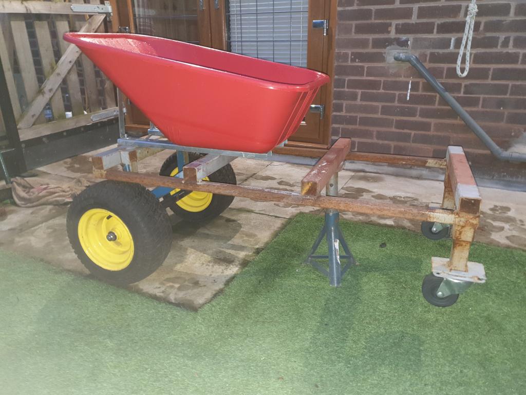

Mickwhitt 4,593 #1 Posted December 27, 2019 Hi all, I have made a start on my new trailer for Fred. I had an old frame I built to move a lathe so I decided to modify it. I made a new axle by turning two stub axles and welding them into a square steel tube. I have a spare pair of wheels with turf tyres and these will be just fine. I also have a wheelbarrow body which I am going to mount at the rear as a tipper. My intention is to build it so that I can have the tipper and a box body interchangeable on the same chassis. 10 Share this post Link to post Share on other sites

SylvanLakeWH 25,493 #4 Posted December 27, 2019 Very cool! And bonus! The barrow body is already the correct color!!! Share this post Link to post Share on other sites
