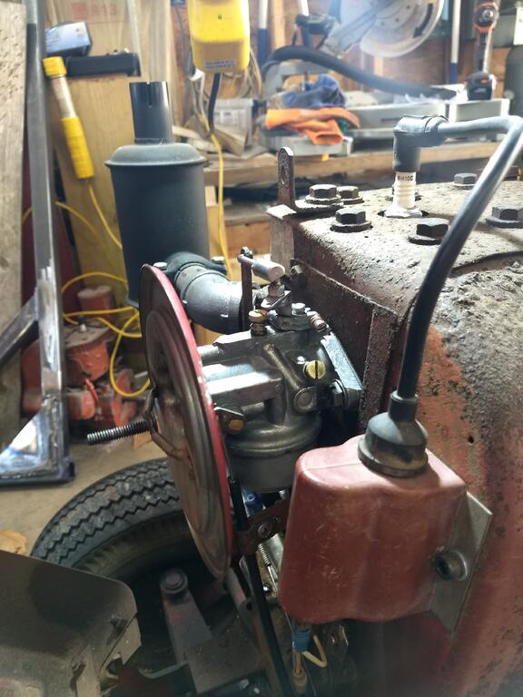

SURGING UP AND DOWN and I was reminded to check the set of the governor
I could use some input from you folks.
This engine surges and hunts up and down and something is not quite set right but I can't figure it out.
I believe I've set the governor arm correctly but you can remind me how to do that so I can make sure.
The linkage for the throttle and Governor has been braised and repaired in the past so it's highly possible the springs or linkages are not in the right holes. If anybody has any thoughts on that I'd appreciate it.
This carburetor was on the 1267 at one point and it ran great then but it  sat for a year or more so I took it off and soaked it and cleaned it out. Not saying I did it right the first time but it's basically doing exactly the same thing so I'm led to believe it may not be the carburetor that was the issue. Wasn't a waste of time because it was dirty and needed to be cleaned.
What can I be looking for here?
For governor adjustment, both the shaft and throttle linkage should be rotated CCW when standing in front of the tractor, that should hold wide open throttle.
I believe this is best done with the throttle cable disconnected, so you are achieving maximum travel of the linkage.
I LIKE TO (yell apparently) clamp a vice grips on the end of the shaft and let it hang to the side.  It’ll make it a two handed job to hold the throttle open and tighten the nut and bolt.
OKAY THANKS. Pretty sure that's about what I did but I'll double check it.

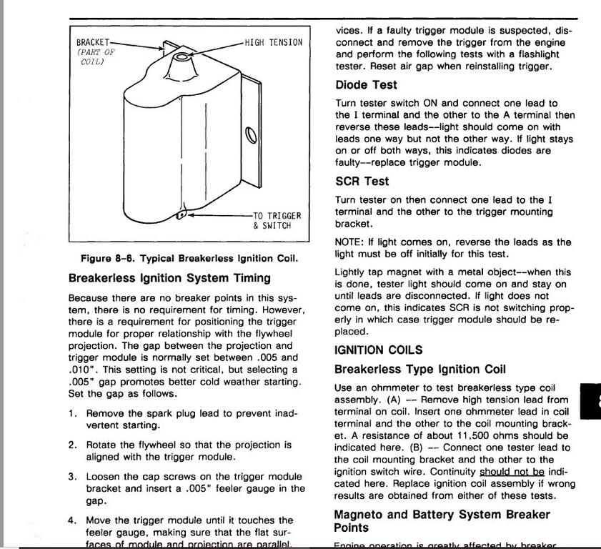

EDIT: If anyone knows the resistance values for these coils, let me know! I've been googling but I keep only coming up with Onan results.
Just watched somethin' on that here the other day, OL on the control side to ground, like 14k???? on the coil side to ground? It was a vid from the we save tractors guy.
Found it ...11k

Found it ...11k
If you have 11 k then the trigger is the most likely suspect they fail more than the coils..

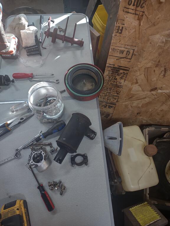

I dropped the bowl off the carb.

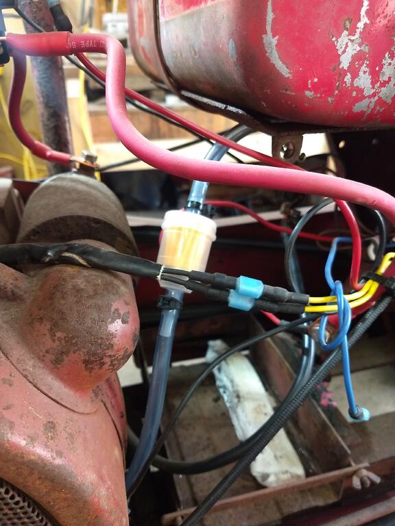

Nice layer of fine brown rusty silt in there.
I added a filter in line to accompany the intank screen.
Popped the carb off and cleaned it up again.
Put everything back together.
Got it started but it was NOT HAPPY.
Choke.  Sputter. Cough. Bang.  Backfire.
So I shut it down and rechecked my initial carb screw settings.
Started and ran but was ROUGH.
Fiddled with the settings more and it got a touch better. Not there.
Let it run a few (like crap) to be sure it was hot. Then held the throttle mostly open.
That action apparently cleared out some small piece of... Stuff.
Ran better. Still doing the hunt and surge.
So I went back and adjusted the governor following the @pullstart procedure.
Now she's doing fairly well.

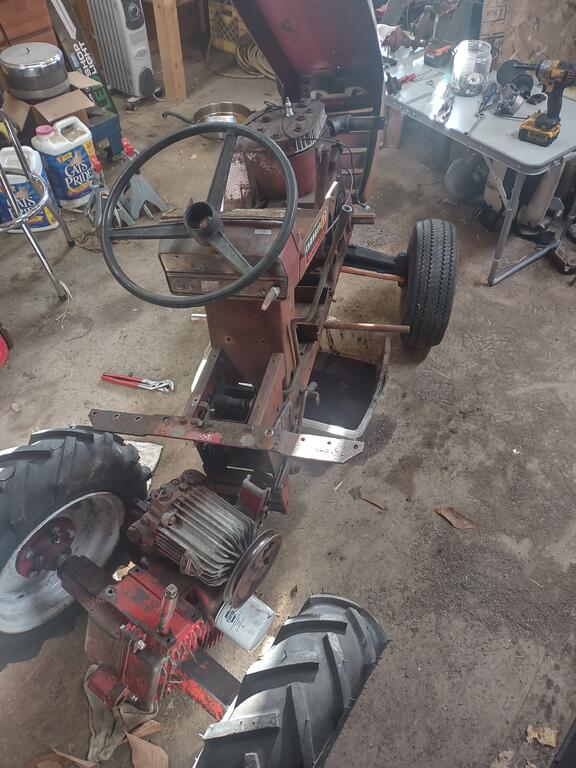

Well I never really did get this tractor going quite right. The engine being a little temperamental is probably something I could solve okay but the fact of the matter is everything else is loose. Every joint you could imagine. Every point of contact you can think of. The hood shakes so bad it rattled the 1/4" thick felt right out from between it and the steering tower in just a few minutes.
Then there's the fact that the transmission housing was scored and damaged significantly because of the previous owner leaving the hubs so loose for such a long time. I put new seals in it all the way around but it still leaked like a colander and there's no way for me to solve that.
I had pretty much decided to sideline this project back in June or July of this past year and then in August I got the opportunity to procure my 1975 C160 Automatic.
I've just finished disassembling this tractor and I'm going to use it for parts for others.
I learned a lot messing around with this thing and I'm glad I did it. None of the parts and supplies that I've put into this thing will be wasted except maybe the transmission fluid so there's no real financial loss there.
The wiring harness in its entirety is very likely going to be put right into one of my 1974 C160 Tecumseh engine tractors.
I'll see how the C160 Automatic goes for a bit. If that works out as good as I hope it will then maybe it will end up with the limited slip differential out of this Charger.
@OldWorkHorse Steve is going to be the new steward of much of it and he'll use it for building something, I'm sure.
