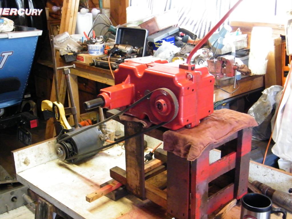

stevasaurus 23,816 #12 Posted December 20, 2019 DO NOT USE THIS GREASE!!! These transmissions are made to throw the oil around inside the transmission case, thus lubing things that do not set in the amount of oil that is usually in the trans. Anything to thick will not get passed the #1533 bearing and properly lubricate the bearings in the outer axle. While we are on it...you also DO NOT want to over fill these manual transmissions. If anyone on here gets a chance, take your manual transmission and put it on the bench...put on the intake shaft pulley and hook it up to a 1/3 hp electric motor, with a fan belt. Put it in any gear and plug it in. Look down where the shifter goes and see the oil storm inside the case. You will see why 90wt is the best choice for these transmissions. 3 4 Share this post Link to post Share on other sites

stevasaurus 23,816 #21 Posted December 20, 2019 Eric, if you over fill these transmissions, you will not get the oil thrown around like you need. Please...if anyone gets a chance...put the trans on a bench and belt it to a 1/3 hp or another horse to look down into the shift hole. When you see how the oil is thrown around, it will tell you tons about these transmissions. 2 1 1 Share this post Link to post Share on other sites
