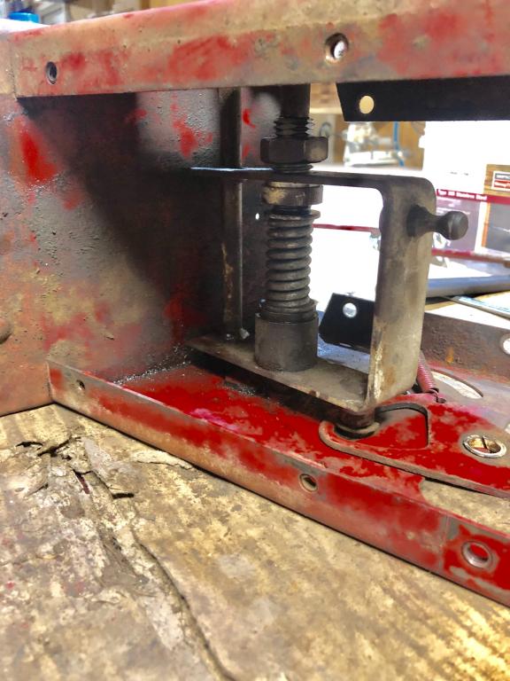

Taking apart my other charger today and trying to get this shift control out to pull things apart to clean it.  The pin that goes through it will not come out I'm just assuming that it is rusted up. Or is there some special technique. I have not messed with any hydros yet so I don't want to mess it up .  I have sprayed the dickens out of it with PB blaster and bolt buster . Nothing yet!

 Well  I have two of these chargers and one I took apart already and was able to pound the shaft out. The second one is a little more a royal PITA!  I did notice there is a keyway in this shaft as well. It is very small.  I am determined to get this apart so that I can clean the interial parts an grease
what needs to be greased!

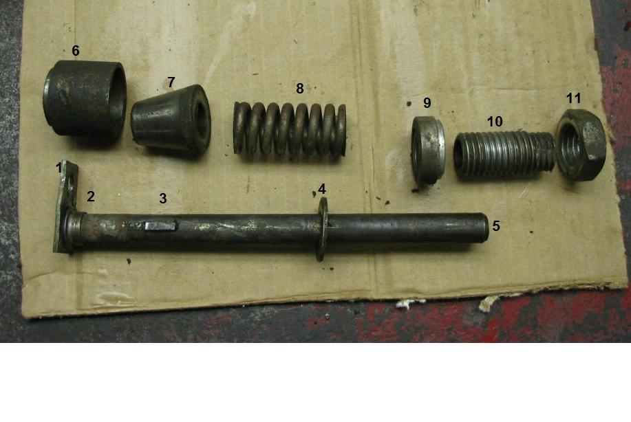

daveoman1966
You have to remove the little WOODRUFF key (item # 3) before the shaft will come out  thru the side of the hoodstand.
It is inside the friction cone # 7.

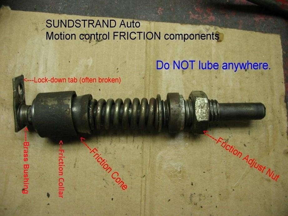

daveoman1966
Don't lube anything...  That defeats the concept of 'friction control'.
